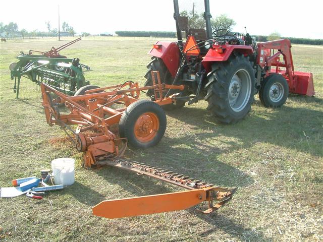

A few years before that I found a nice Allis Chalmers 80-T 7-ft sicklebar mower (pull type). Bought it from a neighbor for $150. Restored it also. It's well made. Need to rebuild the wobble box (bearing problem).
