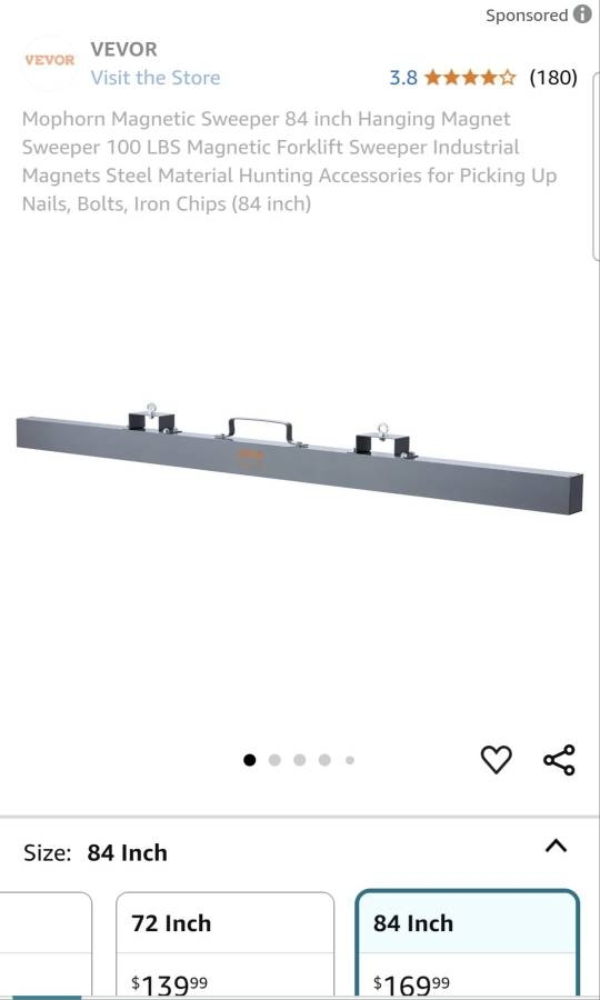

All mowers should have one of these magnetic sweepers attached to front. It would pick up any nail, wire, or lost part before it gets run over or punctures a tire. I'm thinking about ordering this or similar.

how much ground clearance for the attachment? thinking it wouldn't last long in my rough terrain
/ All mowers should have this... #5
I have a magnet pickup that rolls on wheels typically used by roofers to get up stray nails. The height needs to be set so that the grass doesn't knock off the nails that are drawn to the magnet. If the nails fell onto grass that was cut shortly before the roofing job, you have a better chance of actually getting them up. My experience with the magnet I have is that once the grass grows up around the fallen nails, good luck.

Neat idea. In theory it should be great.
In practice it would be a fail. Most yards are rough enough to knock the metal off the magnet and if this would be used on a zero turn, the speed would prevent it from catching much at all.
Good idea but not practical.

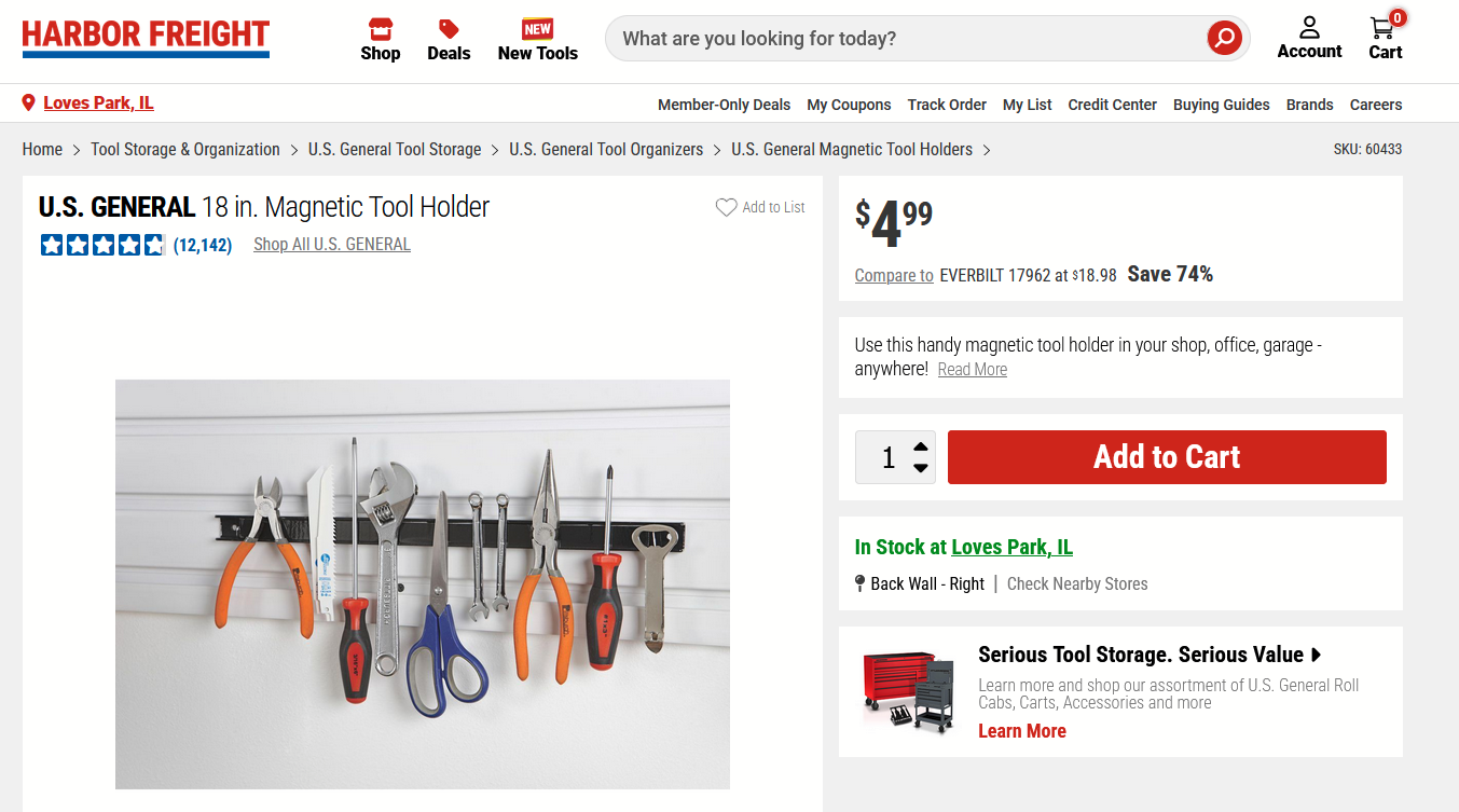

I have three mounted on my mower, total cost, $12 from Harbor Freight! Works great. Plus I can quick removed to clean them off.
They use it for a tool organizer, I use it as a magnet sweep bar.
https://www.harborfreight.com/18-in-magnetic-tool-holder-60433.html
/ All mowers should have this... #10
And if you find the COUPON - - -
expired example
and their Spring BF sale each year,
