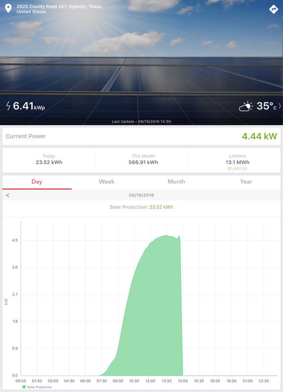

Right now my solar array is producing 4.4kwh, it's quite, no fuel, meter running backwards. HS

Its just me, but I wouldn't want solar as backup. Its probably a great power source but if the power is off because of bad weather can you count on solar. I'd also look at a diesel, if you have a diesel tractor, you have a way to use up the fuel if it gets old. I'm guessing if you can switch stuff off and on you can get by with a smaller unit then you are thinking. I'd forget about the heat strips if I were you and just figure you can get by without them.

That's a big investment for system that only works during an outage. With enough battery backup your assertion may not hold water, by the way the array still produces in bad weather. HS

What would the cost be for him to put up a solar array with enough battery backup to power his house? It would be a lot more than a generator. I also realize solar would give him a return on investment. Just my opinion but I have done some reading, but solar from a standpoint of cost and return on investment only makes sense if the cost to tie into the grid is high.

Just remember while your thinking this morning my solar has already produced over 5kwh, and is running at 3.4kw and spinning up. No fuss, no fuel, and all that's happened is the sun came up.... Incredible... HS
