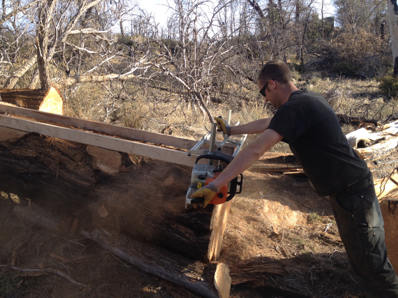

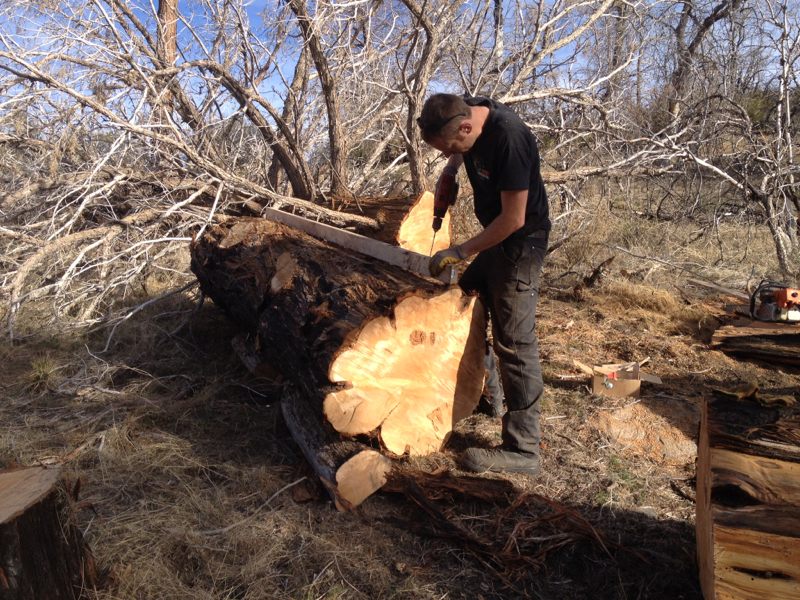

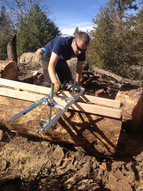

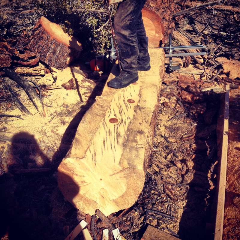

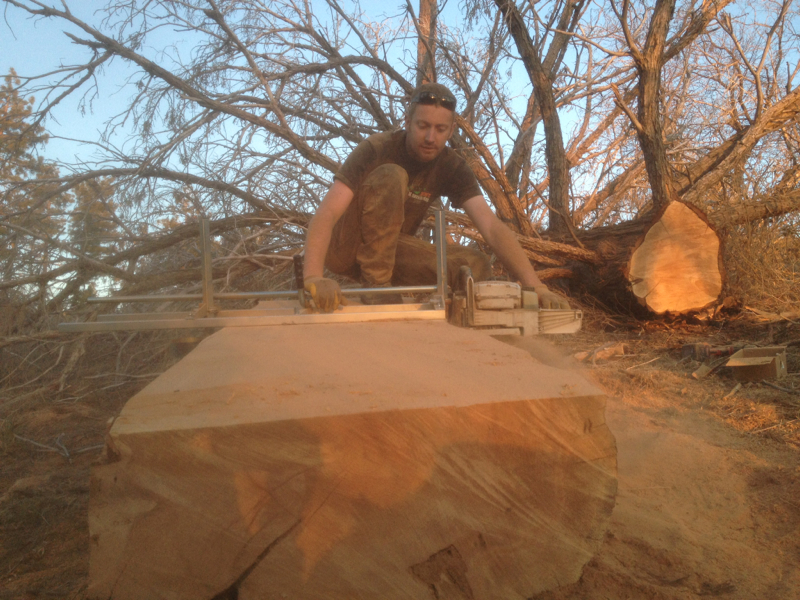

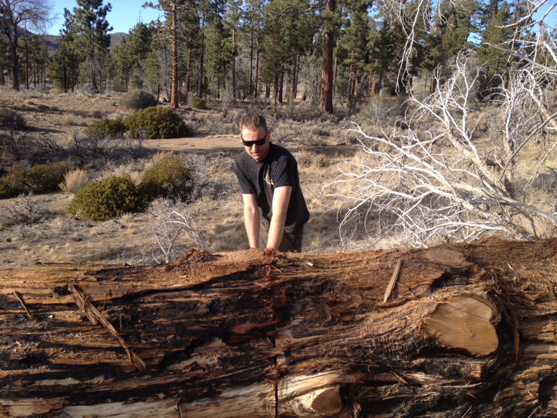

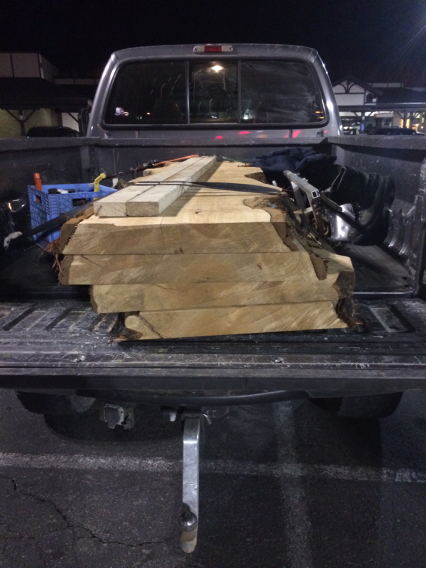

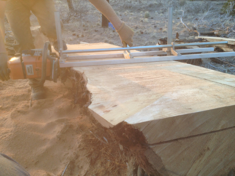

I just used my Alaskan Sawmill for the first time. It worked better than I thought it would. My stihl 066 handled the task surprisingly well.

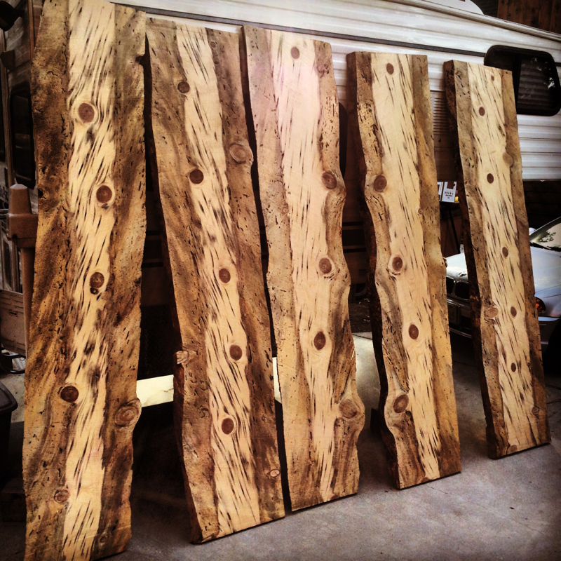

The photos are great. The slabs are amazing. Thanks for sharing it!

Yes, it is pine that has been dead a while. The dark areas are whats called "blue staining."

Cool! An 066 ought to breeze through pine.

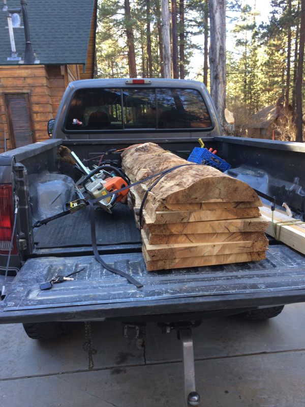

Just cut some Juniper (like Cedar) and surprisingly hard to cut compared to the pine. It took 3-5 mins to get through 8' of pine and 15 mins or so to get through the juniper. I am keeping a eye out for a vintage Stihl 090. Arguably the best Alaskan Mill saw made but they demand a premium price!!
You keeping your chain sharp? I know it's a pain to sharpen the chain with the Granberg Mill mounted on the bar, but I found for some woods I need to sharpen before every cut (white oak is an example).
Also, is it possible the Juniper is sappier and that was an issue? It might have been gumming up the cutters. Sometimes a shot of WD-40 on the cutters will counteract the sap drag. Spray the chain and then run through some non-sappy wood to clean off.

I have always thought of cedar as softer than pine. The pine I was milling had some termite holes as well as the blue staining. Both of these attributes weaken the wood. The cedar had probably been dead the same amount of time as the pine but cedars are naturally bug and rot resistant. The cedar was also growing in arid semi-desert environment which only allows trees slow growth. I could see very close growth rings which tells me that the fibers are more dense the one would suspect.
I ran a rat tail file two passes per tooth in the middle of cutting the cedar. The teeth look perfect even before filing so I didn't notice any difference. I am worried about free hand filing too much because having the teeth at the right specs is important for even cutting. I will probably invest in a granberg jig in the future.
