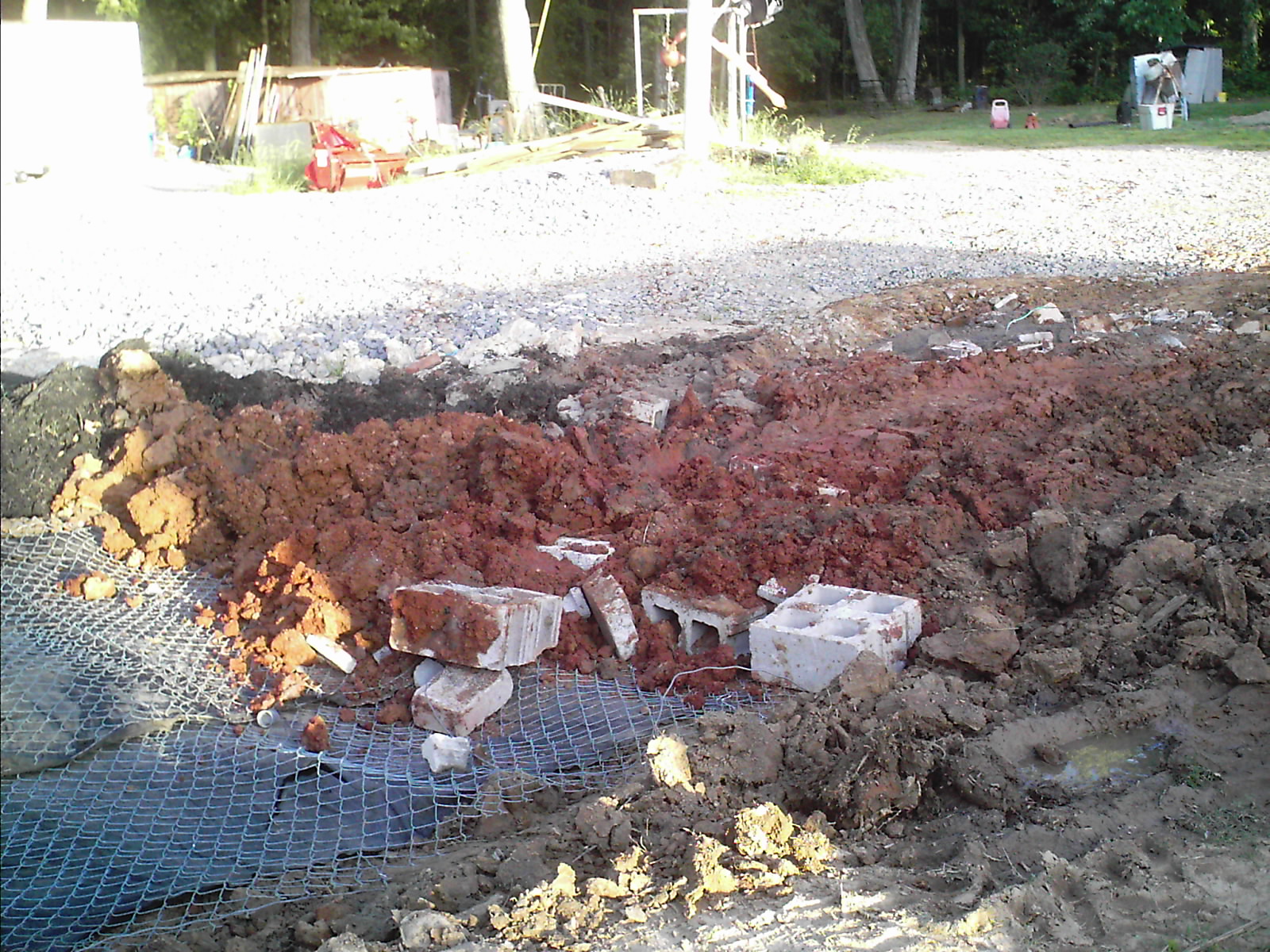

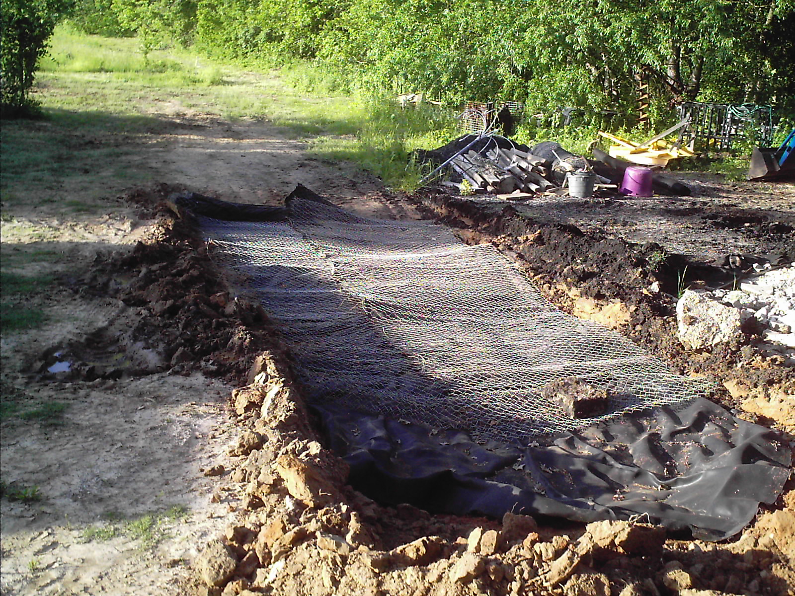

Talking with my buddy Bill one day, who is probably even cheaper then me, we were talking about Geotextiles etc. and he said, yeah, but you know, you can always just lay chainlink fence down. It will rust and disapear after a while, but it is usually free or people pay you to take it because most dumps etc. do not like to handle it. Then you saw me go :D as I just happened to have a pretty sizeable pile in the back yard. Don't you love it when a plan comes together.
I actually have some geotextile as well, but am "saving" it for the front drive.
OK, so current game plan says, dig to clay, save and sell topsoil, lay in chainlink fence, cover with clay from other digging and scrap concrete rock and block, then topdress with #2 (2" to 3") stone.

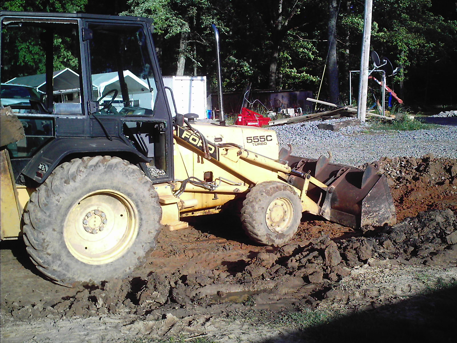

So, I started the last round by digging some with Lil, little front and a little back action, just to see how it would go and did a test little bit.
After doing this I have determined that I must purchase a dozer :D Of course SWMBO did not quite see the logic in this thought process as she felt continuing to feed the kids on a regular basis was more important. So while I convince her of the error of her ways, my buddy has a nice Komatsu D20 A 5 sitting quietley at his house that I may have to borrow unless I can really convince my daughter to go on a big diet :eek:

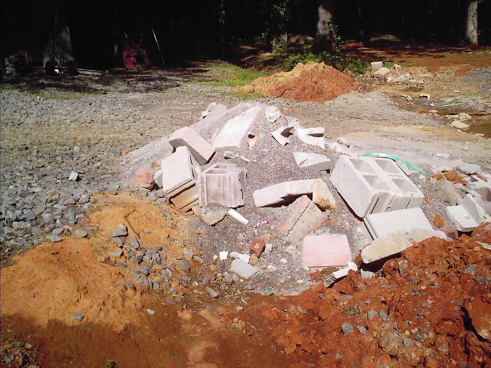

17 Here is what a pile of the free fill looks like

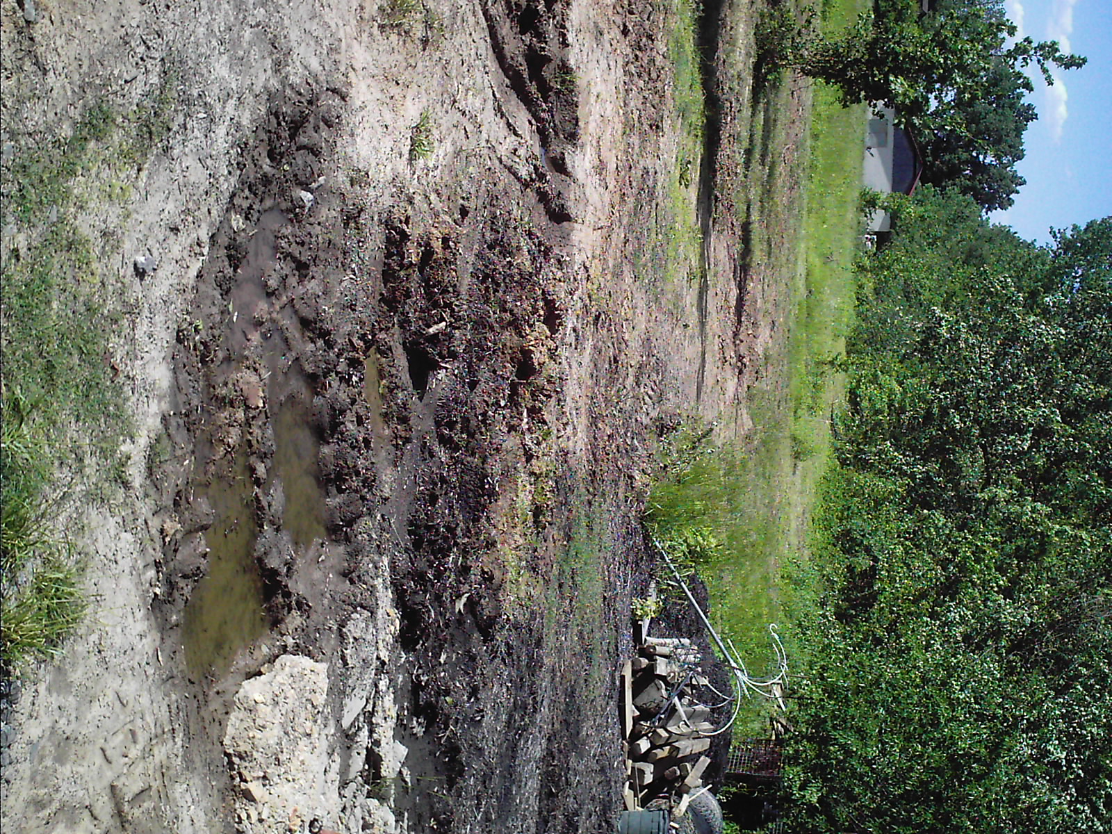

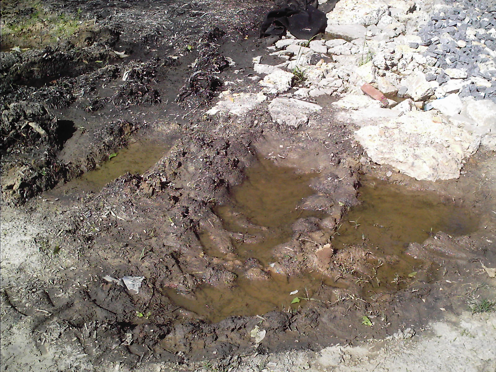

19 Did I mention, water stands here :D

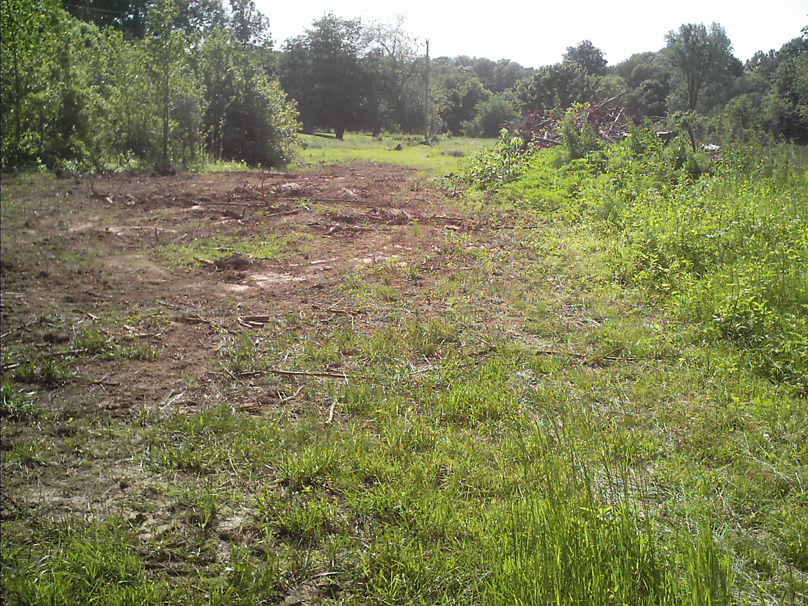

20 Need to go across here
22 then we need to turn and go down to this road (the road is where the telephone pole is).
34 Lil, wallowing around in the hole she dug
36 I also had an old trampoline laying around,,,, Looks close enough to geo for me :D
39 Here the rock / clay / scrap is in the hole.

Looks like you dug out the low spot down to solid subsoil [x]
That's the first and most important thing.
Everything else looks like it's downhill from there. Getting the free coarse fill is great.
One idea with the cinder blocks: Always place them holes UP. I see one that is sideways, they can break over time, and cause a small depression or hole.
Placing them "holes up" allows them to fill up with smaller aggregate.
Also, separate the cinder blocks a little, so aggregate can fill in between them properly, this goes for any large chunk fill. If you but large pieces together it can cause voids, as aggregagte may not fill in all the way.
Only other way to deal with the cinder blocks is to break them up into rubble then fill with them. Just be mindful of voids, and do whatever to keep from having voids.
Fill in with loose aggregate and then run your plate comapctor over it, then fill some more, compact some more, and so on.
You're doing good. And the pirce is right!
Also, clay + sand = poor man's concrete. If you don't have sand, use fine aggregate mixed with the clay, when it dries it'll tighten right up real solid.

Using the concrete as a filler is an idea that I myself will have to explore. The only real issue may be that, when (for example) tearing up a house, it is not legal here to bury the concrete. Instead, it must all be removed and disposed of at a proper facility (i.e. the landfill). Considering that, I am not sure if I can use concrete as a filler. If I could, it would sure make it easier for me!
I have one comment about using chain link instead of geo tex. The geo tex works because it acts as a barrier to the soft junky soil and does not allow it to work itself back up to the surface, mix in with your fill, and result in an ever more sloppy driveway. The chain link fencing will not provide this type of barrier, and the problem soil could eventually work its way back up just as if there were no barrier there at all. The only saving grace could be that you dug down to the subsoil - hopefully that gives you enough solidity beneath your fill to slow the upward migration of any problem soils.
Either way, if the drive does not hold due to a lack of a barrier at least it will not happen overnight - I am told that this occurs over a period of a couple or few years depending on the amount that your driveway is used and also on the weight loads placed on it.
