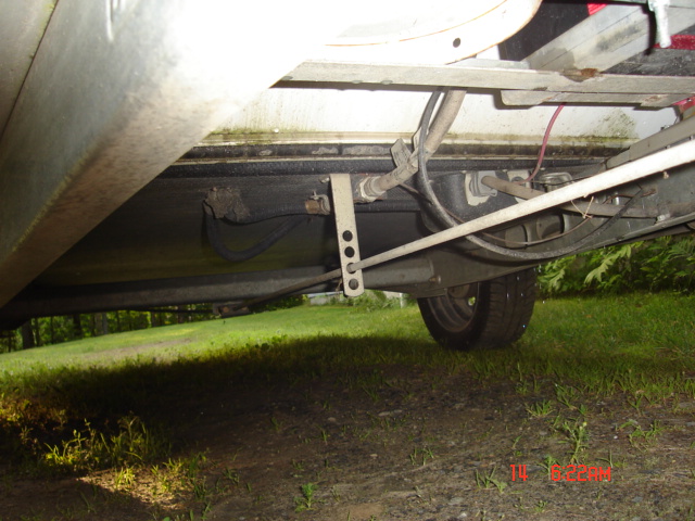

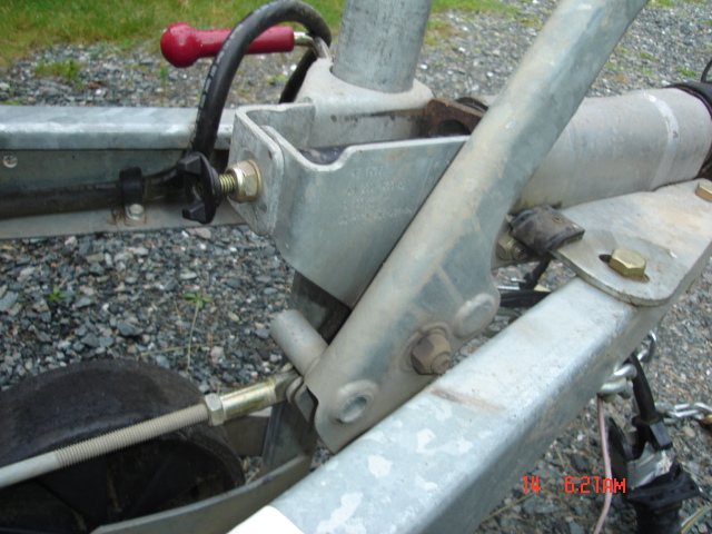

I'm hoping some of you with a lot more experience than I can help.... I've gone through the owner's manual carefully, and can find nothing on the surge brakes for my T@B camper, other than that "it has them."

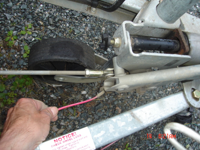

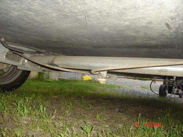

As near as I can figure, after removing coupler's plastic cover and crawling around under it, there is no electric or hydraulic connection to the brakes at the wheels, only a cable, just like the parking brake on a car. There is also no electrical connection anywhere to the parking brake or the coupler. (Don't know why they used a 7-pin round-- one size fits all?)
The knobs on the front- the topmost red knob is the wheel jack --which turns "backward" by the way, clockwise for lower!-- the red-handled tall/long lever is the parking brake, and the smaller red-handled piece on the left side of the wheel jack is a lock for the wheel jack's shaft; wheel and shaft are lifted up into the frame for storage after connecing to tow vehicle.
The red cable is a breakaway cable, and is hooked into the base of the parking brake lever, so it actuates the very same steel rod the parking brake does.

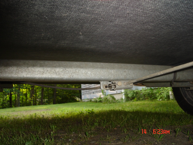

There is nothing going back toward the wheels except the steel rod, which ties in to a "Y" cable on the rear axle.
I haven't yet taken the wheels off, but I will! I'm just wondering about the system: it appears to be strictly mechanical, and must have some provision to allow for backing up, but I don't yet know what it is.
The system is a German design, and may not be regularly seen in this country...? Any ideas and/or experience with these?

You are right, they are not the typical surge brakes. All I have ever seen were hydraulic, yours are mechanical. You are right, there seems to be no provision for backing up so you must have a free backing type of brake actuator or simply none at all like in Dargos boat ramp story.
The main thing now is to get the red brake-away cable fixed as I described before. It should be a length that allows you to turn freely but pull fully and lock up the brakes before the safety chains get tight in a couple or ball hitch failure situation.

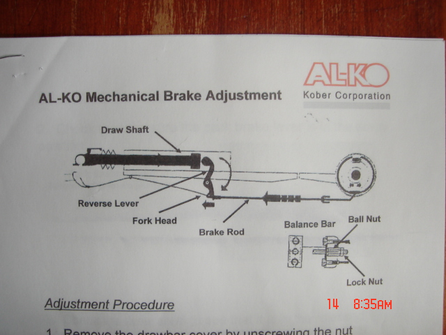

Finally, after finding & then scouring all paperwork that came with the camper, I located a piece of literature I thought I'd seen before. It details the adjustment procedure for the "AL-KO Mechanical Brakes." It's the same as my ol' Blazer's parking brakes.:cool:

This is a newer version of what i have under my 2.5 ton tandem trailer.
I bet this is an OEM Alko undercarriage on which a trailer builder put a living.

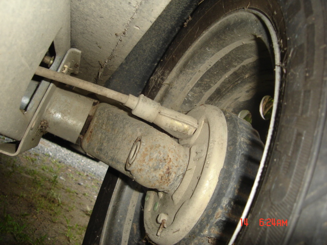

Dont know what exactly your question is, its just as straightforward as shown in the scheme you posted. A month ago i replaced two brake bowdens, which cost me 13 euro each. These bowdens need frequent replacement because the steel cables brush off when they get rusty, and stick in the liner.
Its a bit too complicated to describe how to replace the brake shoes and cables, but its so straightforward that if you can take it apart, you must also be able to put it back together.

What you refer to as "bowdens" --would that be what we call brake "shoes" or is it something else?

That diagram mentions a reverse lever...but it looks like part of the actuation system
/ AL-KO surge brakes--?? #8
If you look at the top link that Skyco posted, the bottom of page 16 talks about the reversing mechanism. There is something built into the brake assemblies that releases the shoes when your backing up.

OK- that's got it!
Thanks for the links; I've printed up the service manual. Just what I was looking for, and not to be found in any of the paperwork I already had. I had searched for quite a while for "Al-Ko surge brakes" and found lots of interesting stuff, but not the info your link has!:D
Also see what "bowdens" are -- the twin cables that connect to the wheel/brake assembly. (Never knew they were called that!)
I had seen the "reverse lever" in my info; my take was that it served to reverse the direction of motion of the flexible coupling, hence its name. Car slows, felxible link pushes rearward, bottom of lever pulls brake cable forward.

As an aside, I noticed that the literature I had concerning brake adjustment referred to the actuating lever as the "Reverse Lever," but in the service manual on the link they call that the "Overrun Lever"; the "Reverse Lever" is the thing that disengages the brakes when backing up, located in the brake drum.... (I changed the wording on my copy!)

When your trailer starts braking poor, in the next 5 years, its most probably a rusty or wire brushing bowden cable. As i said, they cost me 13 euro each, the first hub cost me an hour (trying to figure out how the brake shoes are mounted with springs to the backplate) the 2nd just a half an hour.
There is a toothed wheel visible through a slot in the brake backplate which is used to adjust the brake lash. Start adjusting there (pry the toothed wheel with a screwdriver untill the wheel stops turning, then back it off a few ticks) then adjust the rest of the play by the threaded pullrod off your surge head.

Yep, when the surge is compressed when reversing , pressure comes off the brake shoes
