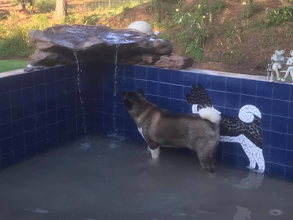

First test run of the fountain had mixed results. The flow is a little slow with just the water filling it up, but when the pool was full, and the pump was turned on, it was just too much pressure. I drilled 3 quarter inch holes in each of the three copper pipes for the water to come out. I'm going to make them 3/8's and see how that works. If I get good results, I may add a few more holes. I want volume, but less pressure. If it doesn't work, I will add a valve to the line so I can reduce the amount of water.
Kenschi is one of our puppies that will be 16 months old on the 19th. She is around 100 pounds and a little chunky. She is the first to try new things and the one that likes the water the most!!!

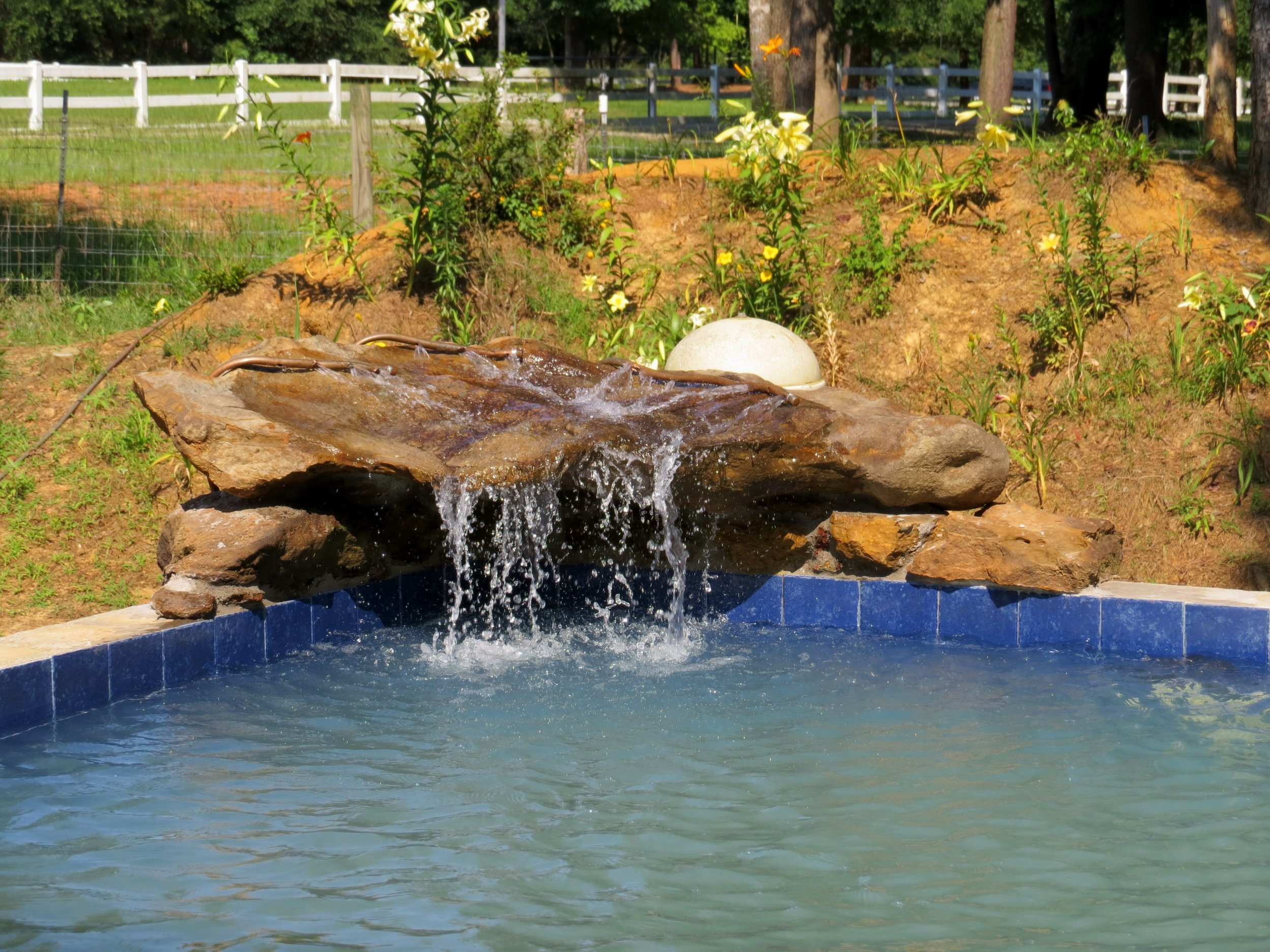

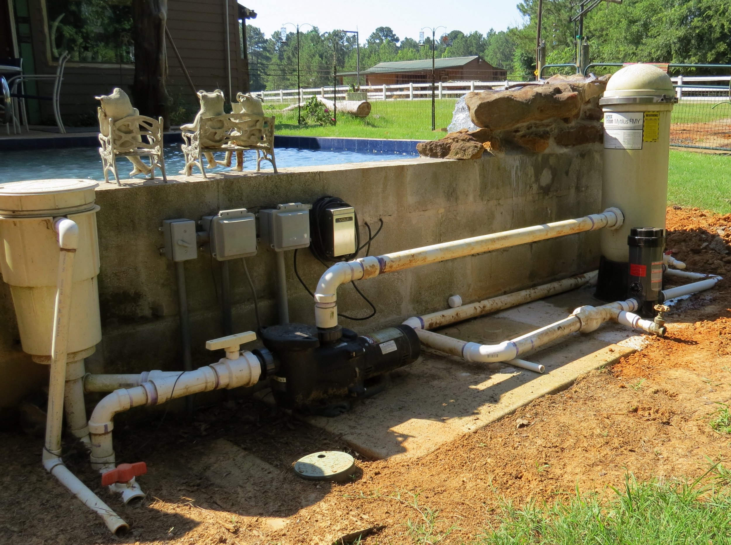

There are 3 flexible half inch copper pipes bent over the rock. I started with drilling three 1/4 inch holes in each pipe. Not enough water came out, and what did come out had too much pressure, so I drilled the holes bigger. I tried a 3/8's bit first and didn't think it was big enough, so I went up to almost half an inch. It's two sizes smaller from my drill bits, but I don't remember what the exact size was.
The bigger hole made a difference, but also creates splashing and over spray. I ended up drilling a total of 20 holes and adjusting the holes with some channel lock plyers. By bending the beginning of the hole, or the end it, I could change how the water came out. It was all trial and error, but eventually I got there.
To move the filter so it was behind the rocks, I needed to pour concrete and then make the line from the pump to the filter linger. Turns out it's exactly 5 feet longer. Then I ran the line back to the pump, and then turned around and went back to the filter again. This gave me room to put in the backflow valve and chlorinator. I'm still going to add a mineral sanitizer to it, and this gives me plenty of space. Then after the chlorinator, I have my water supply line to fill the pool, and a T that splits the water from the water fall and the nozzle that circulates the water around the pool so it goes into the skimmer. After just a few hours at the lowest setting, I'm at .5 ppm

I bought this Hayward Chlorinator. It's uses either chlorine or Bromine. I filled it with Bromine tablets and I'm checking the levels every day to try and get it adjusted right for the size of my pool. I'm only 3,000 gallons, so it's bigger then a spa, but a lot smaller then most pools.
