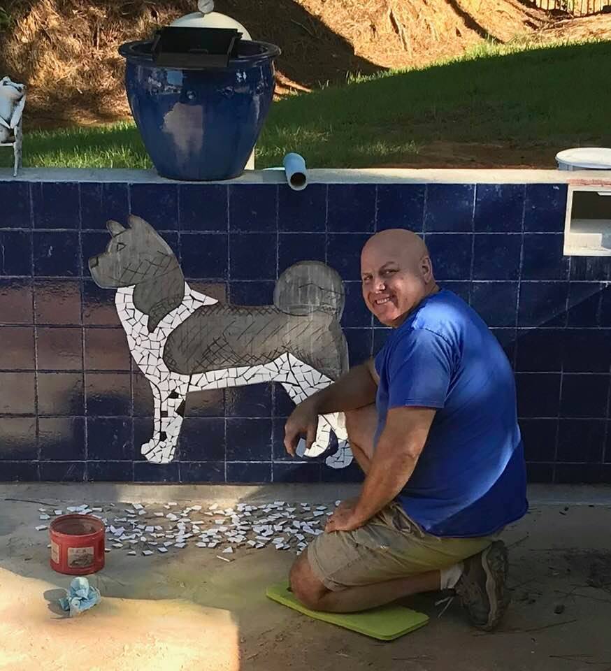

My original plan of using rock to create the Akita ran into a problem when I found out that the only really bright white stone out there is marble. The problem with marble is that it deteriorates over time when under water. Then the only super black stone that I could find wasn't cut. It was full sized, rounded, rocks. I thought about going with rocks, but really wanted a flat finish. I spoke to my tile supplier at The Tile Shop here in Tyler, and he suggested a porcelain tile that was dense enough for using in a pool. Most tile isn't very dense, so it's not a good choice for pools. Regular pool tile doesn't come in the solid colors that I wanted for the Akita, so my options became very limited.
The tile came on 1ft by 2ft sheets, and each tile is 2 inches square. I cut them out and then broke each tile into four or more pieces with a hammer. Then I used a putty knife to apply the thinset and install each piece into the pattern that I felt was the most appealing. The thinset is Ardex X77
Just like doing a floor or shower, the grout lines are a huge factor in laying out the pattern. This was one of my biggest concerns when applying the tile. I wanted to make sure that the legs where distinct from each other, and that they patterns where clean.
Karen took this picture of me Saturday morning.

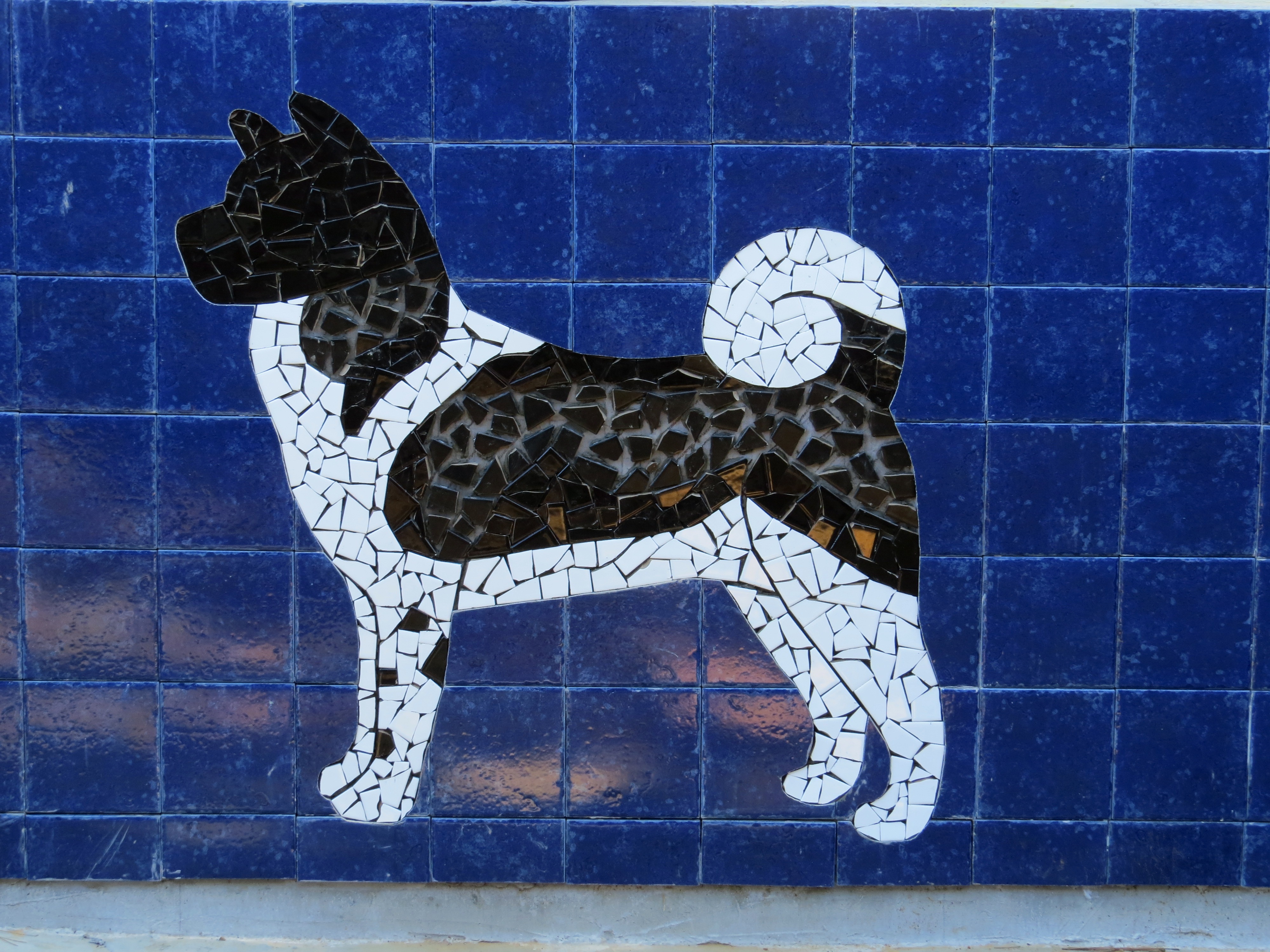

Sunday I finished off the mosaic. The biggest challenge was in making the black, go from super dark black, to kind of faded, silvery black. My solution was to spread the tile out farther apart to create the lighter coloring of their coats. More grout between the tile should make it look a lot lighter. When I'm done with all the tile, I plan on using a dark grey for grout, so that should work out pretty good.
