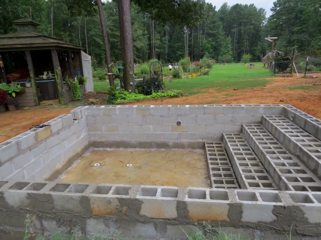

Between rains from Harvey, and goats having babies, I finished the block work on the Akita Pool. 360 blocks and 36 sacks of mortar. As an amateur, I wasted a lot of mortar, but at least it wasn't a lot more.

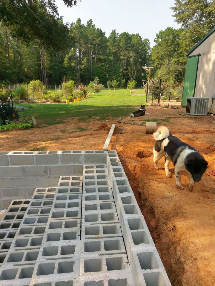

Before the snake, I got some work done on my footings for the porch. The porch will be 16 feet by 24 feet. The boy dogs, Matsu and Raidan, like to hang out with me more then the girl dogs. We have no idea why.

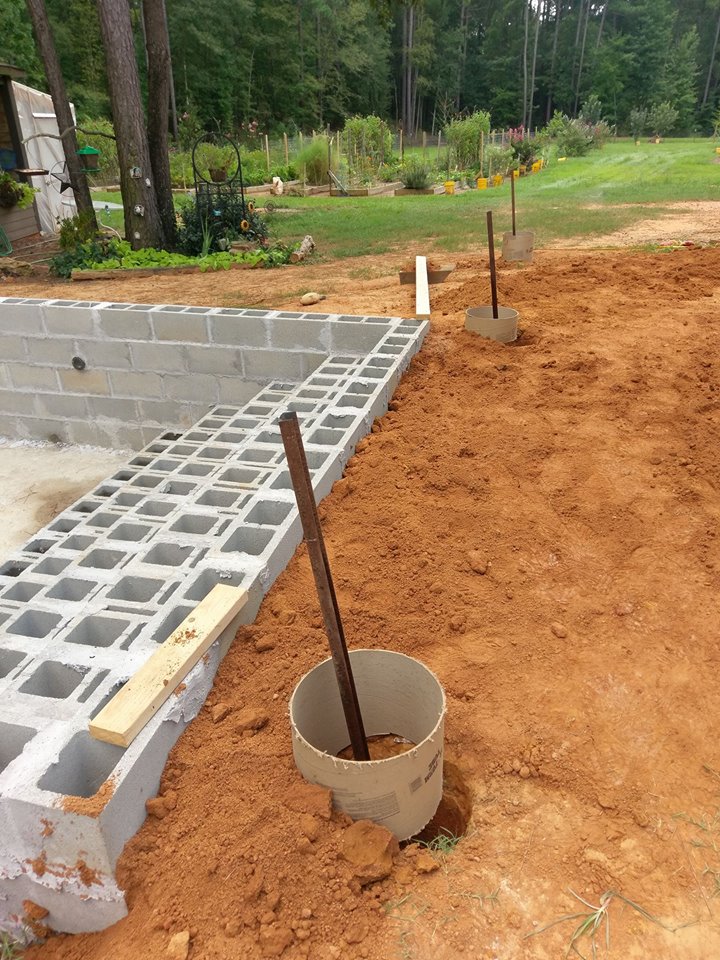

I dug my footings and set the sonotubes 1 1/2 inches above the finished concrete height. It's important to me that the posts remain as dry as possible. Then I brought some dirt over to start back filling and bringing the dirt up. The backhoe bucket is great for this. I don't get a lot of dirt compared to the loader bucket, but I do get it really close to where I want it.
The holes are 3 feet deep and centered for the channel iron. That's five feet long. I want two feet above the concrete pad to anchor my cedar log posts.
Once I get the hole mostly full, I level my channel iron. The sonotube is off to the side of the hole, where I want the post to sit. For this, the channel iron is 14 feet from the house, and the post will be 14 to 15 feet from the house, allowing me a foot of overhang.

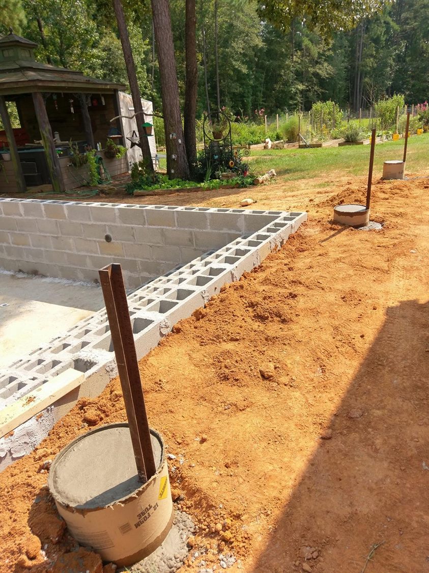

Will the post be on the footing and then will you drill and bolt through the channel iron?
I guess I am confused on the placement of the channel iron at the edge of the sonotubes. It looks like it would "easily" pop loose when any racking stress.

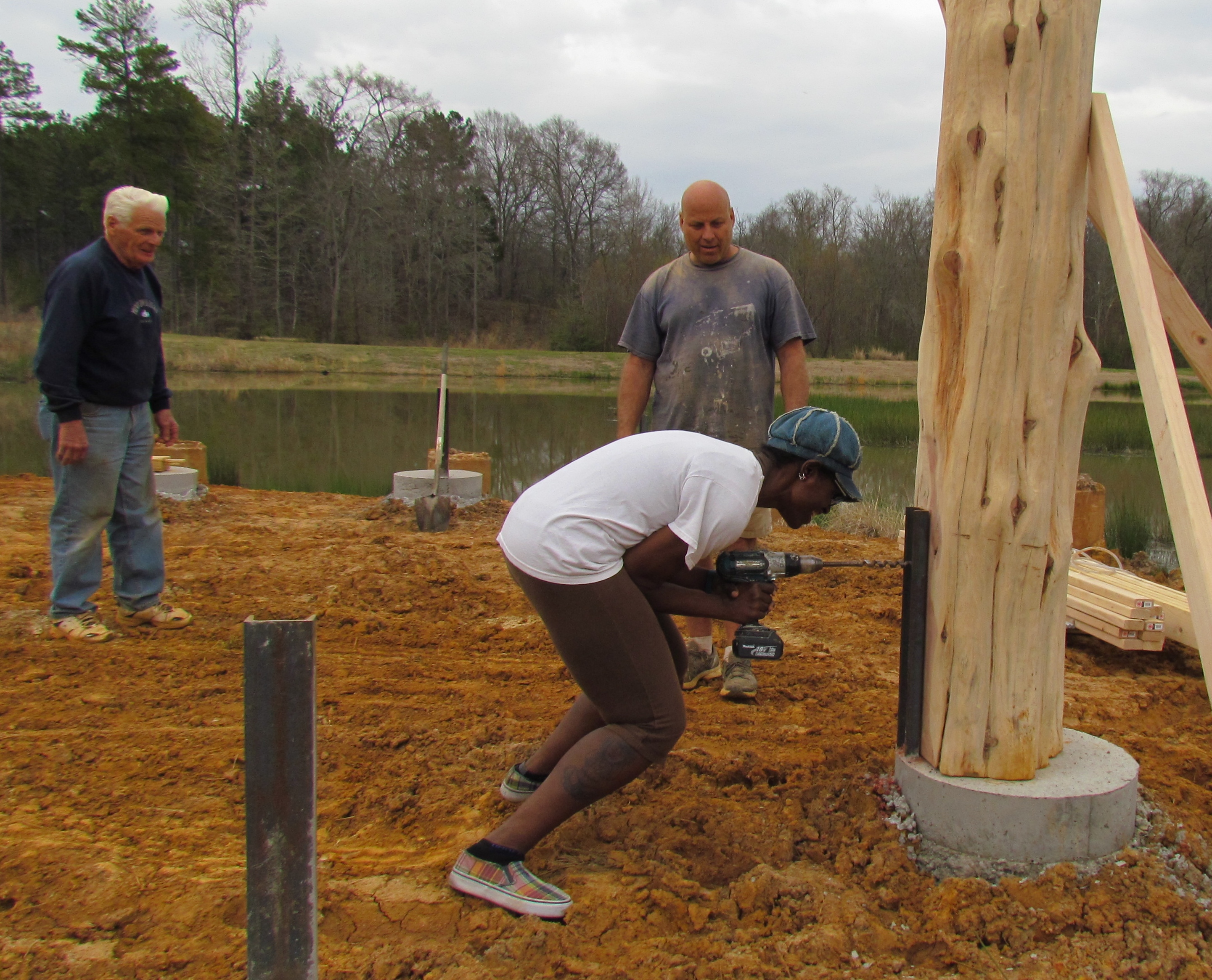

Hope this picture helps. This is from my gazebo build. The channel iron is in the middle of the hole with concrete all around it except for where it comes out of the ground. The it's only at the edge of the sono tube. The concrete in the sono tube is only on about half of the hole, so a good part of the weight from the post and above is carried all the way down into the hole, but also some of it is resting on soil.
I'll cut two holes in the channel iron with my torch. Then when the log is set in place, I will drill a 3/4 inch hole through the log, insert 3/4 inch galvanized threaded rod, add a galvanized washer and nut to each side and tighten. Then cut off remaining threaded rod.
The log will still move, so I'll keep it braced until I have the roof all tied to it. That will lock it all in place so there is no racking.
