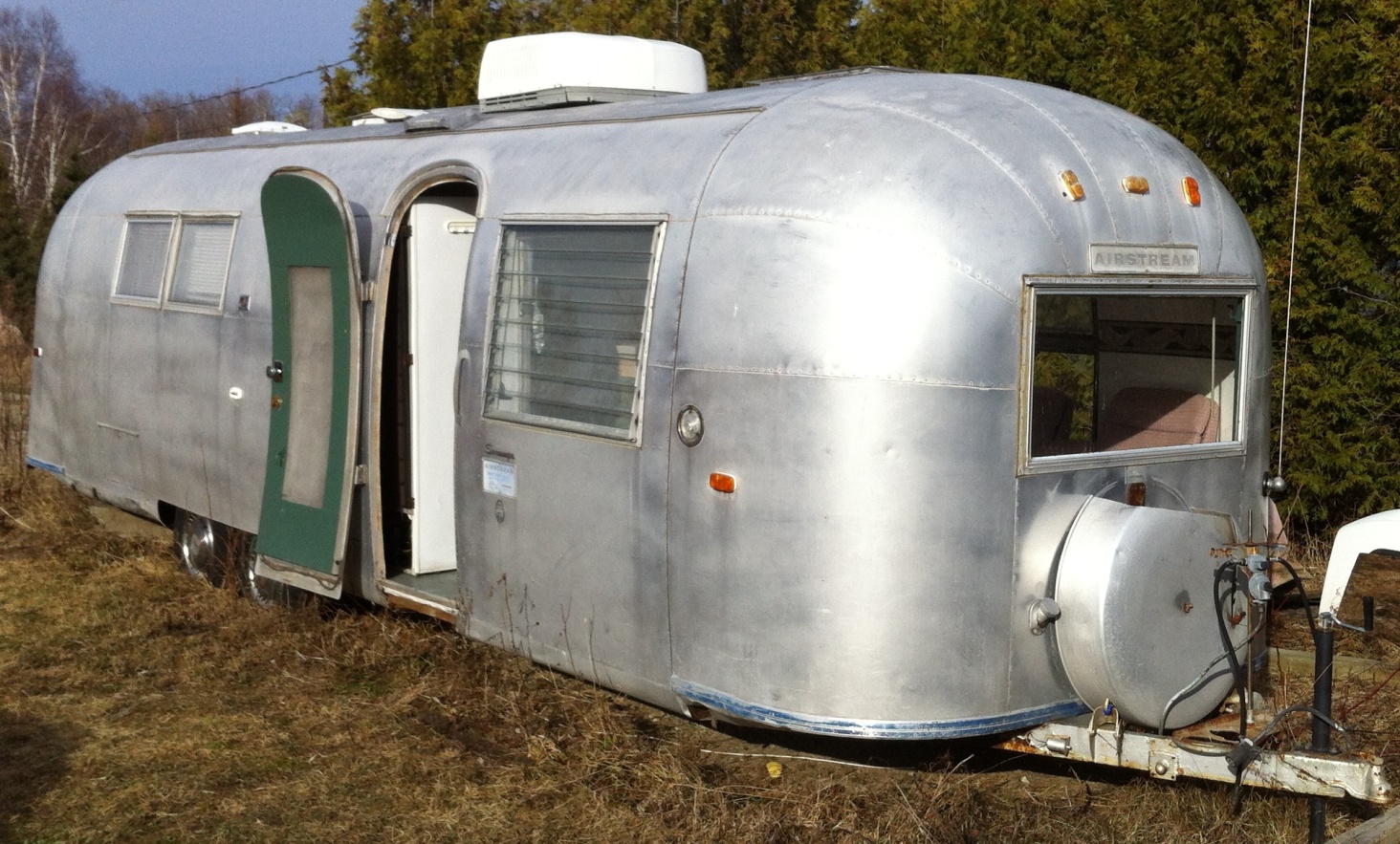

I too will be asking for advice as we start our airstream project.
Mine is a 1963 30' Sovereign International.
Do you restore the rear bath to original or make improvements?
