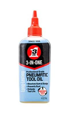

Some times people forget air tools need lube occasionally.... Try the PB blaster thing then follow up with pneumatic tool oil...
Or similar product...
