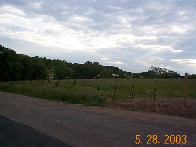

Neighbors house, not ours... but at one time the land used to belong to the owners from years ago.

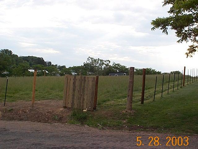

The posts on the right here were done by hand, 20 of them, thats before I got the driver....
How do ya like my walkthru gate? Thats my first gate I ever made /forums/images/graemlins/shocked.gif

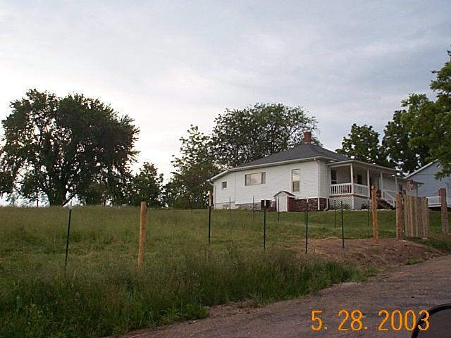

Another pic

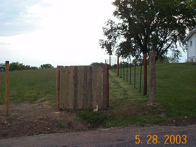

Last one for now. /forums/images/graemlins/wink.gif
