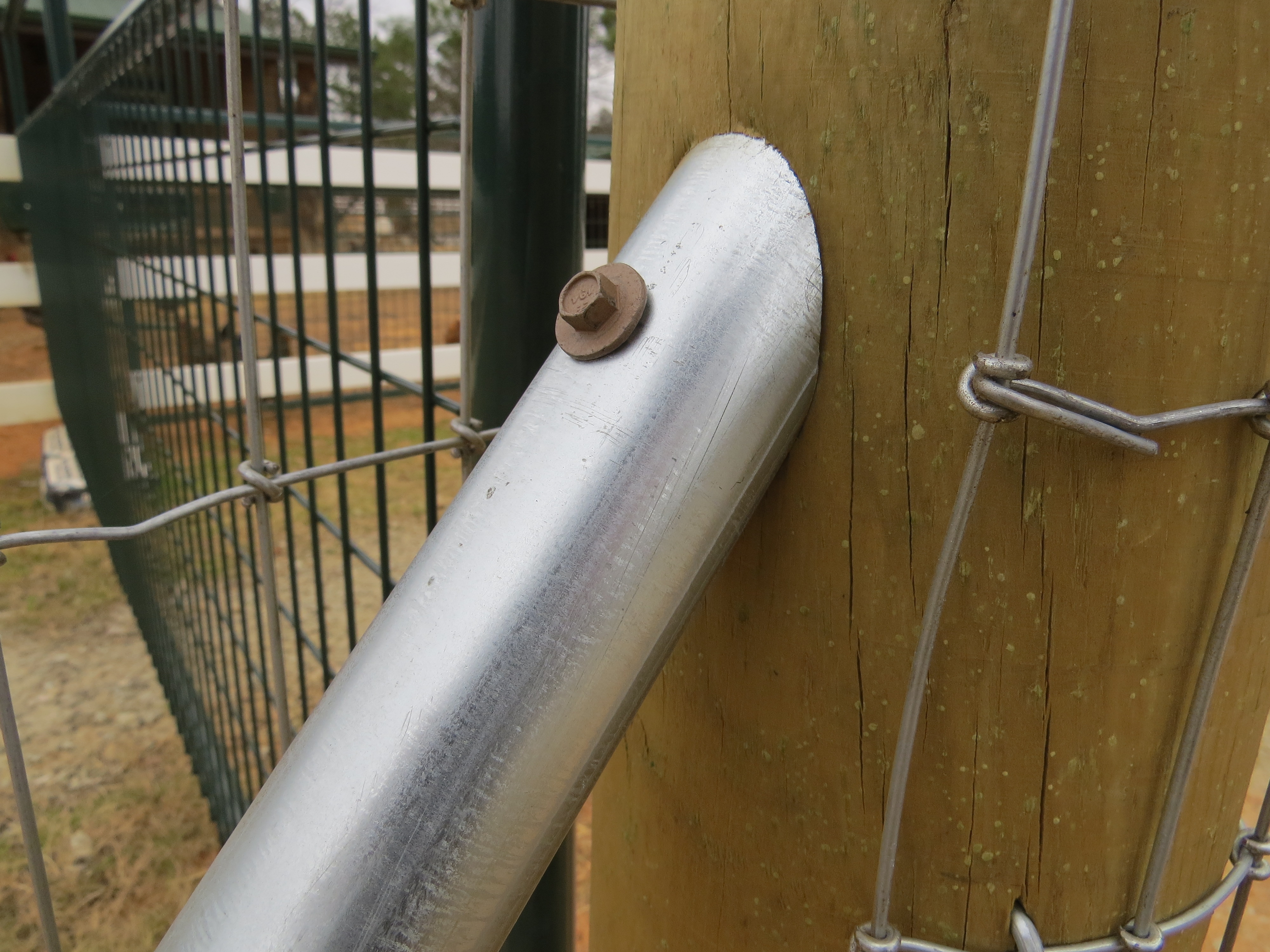

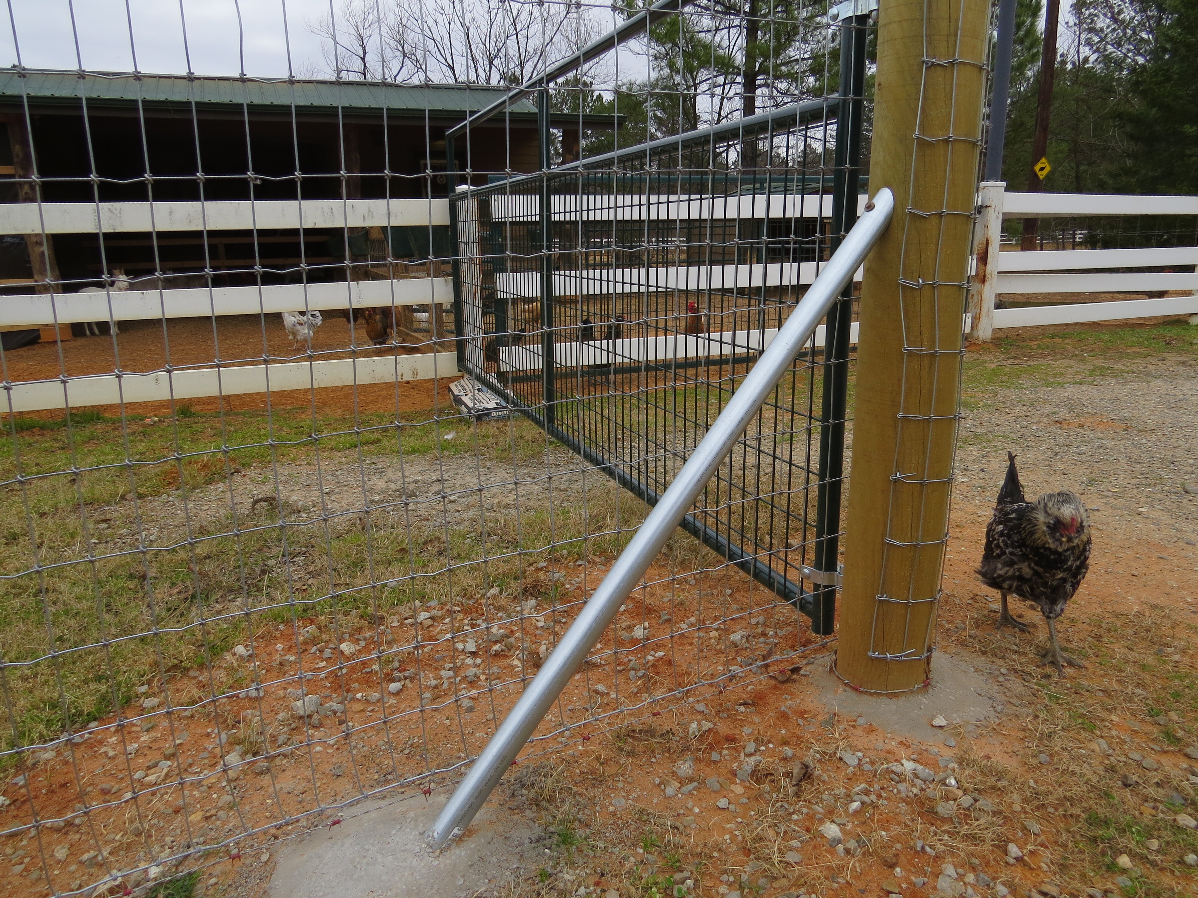

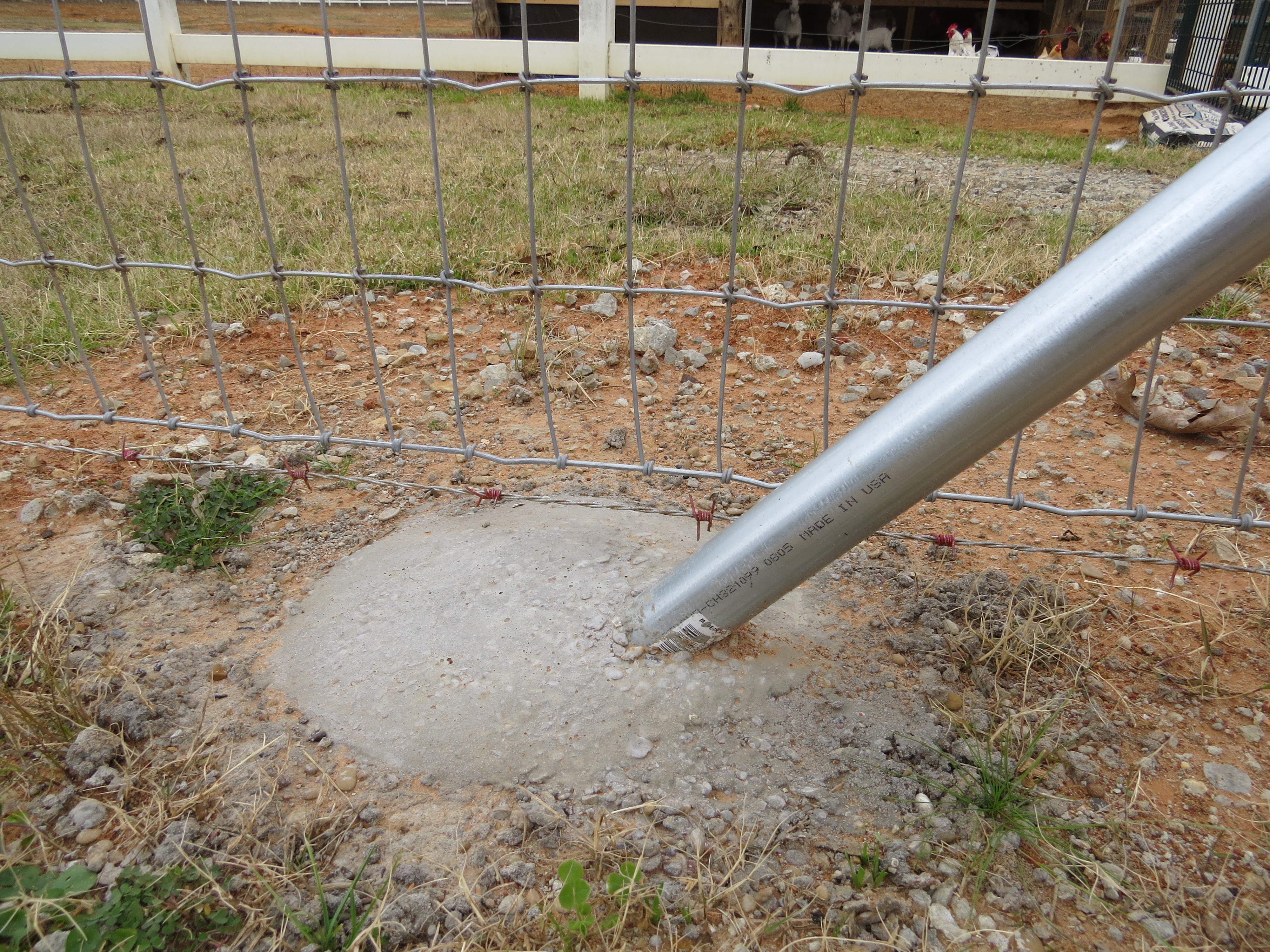

I do something similar, but I'm using 6inch x 8foot treated wood posts in concrete with 1 1/2 inch EMT for my bracing that is also set in concrete and attached with a 5 inch exterior structural screw.
The EMT comes in 10 foot lengths. I cut them in half at 45 degrees, drill a hole through the angle part of the EMT for the structural screw and anchor the other end in concrete.
I always bring the concrete up the post so water sheds away from it. In my experience, posts always rot at ground level, so keeping the water away from the base of the post will keep them from rotting.
My fencing is 4ft 2x4 horse fence. I like the wood posts because I can attach the fence to the posts with barbed staples, that make it very secure.

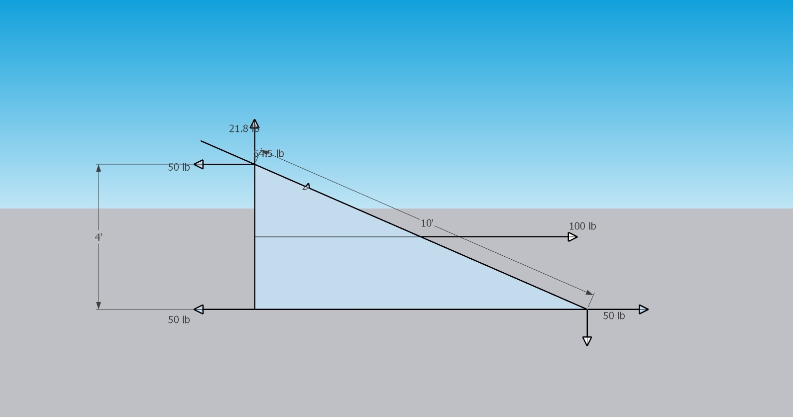

The first thing I did was sketch up a force diagram.
If you have a fence post with a 10' brace attached 4' from the ground, subject to a 100 lb horizontal force either centered on the post or evenly distributed, what are the forces?
Well, since the horizontal load is centered half goes on the brace and half on the ground under the post. That horizontal load is transferred to the ground under the brace. Since the brace is angled there will be a vertical load on the brace of 21.8 lb. This will push down on the bottom of the brace and up on the post.
So what are the failure modes of a brace like this? Whichever of the following happens first:
* The post pulls sideways -- the horizontal force exceeds holding capacity of the earth.
* The anchor of the brace pulls sideways -- again, excessive horizontal force.
* The post lifts up out of the ground -- the vertical force exceeds the holding capacity of the earth.
* The anchor of the brace sinks into the ground
* The post or the brace bends or cracks.
I don't make it a habit to go around breaking braced corners, so I have limited experience. Usually when I do break a corner it's installing field fence with a come-along and I get too enthusiastic tightening.
With an H-brace made out of wood timbers, I find the failure point will be when the post lifts out of the ground -- the holding capacity of the earth gets exceeded. This depends on how you anchor your posts, I usually just pack them in dirt.
With a T-post on the corner, the post itself bends before anything pulls out of the ground. That really surprised me.
If you go back to post #4, I show a picture of a wooden post with the braces anchored with t-posts. I've never broken one of those braces so I don't know if the post pulls out before the braces let loose of the earth. Or if something else gives.
