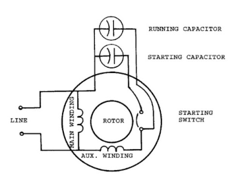

Ok I'll give this a shot. Thank you. I tested the start cap with a proper capacitance meter. It fell within the parameters of the cap (136-163 with a reading of 142). So what's left are the windings and or a stuck reed valve.
Which is considered the "winding"?
/ Air Compressor puzzle #46
Winding is any wire going inside of the motor. Primary winding is connected directly to the power (to white and black wire) the second winding is connected to (usually) white wire and to capacitor and/or the start switch.

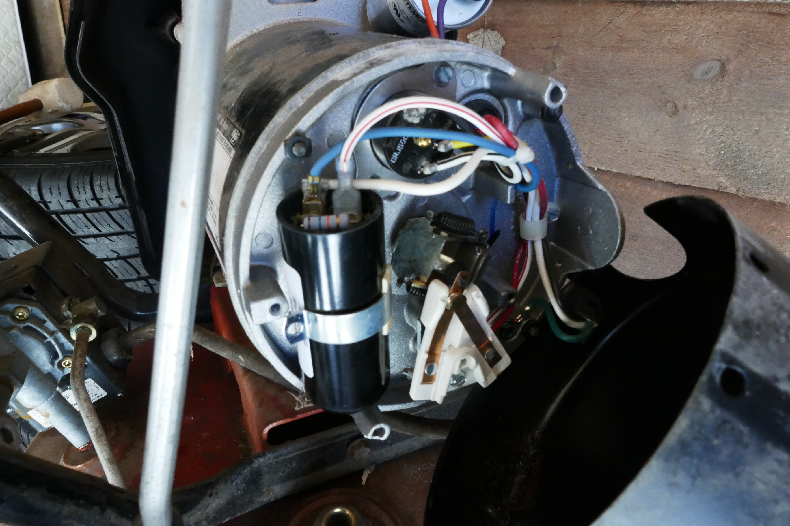

So I tried this. Needle pegged on the green wire. Didn't move on the white or black wire. When i touched the run capacitor wires w/o the capacitor, the needle pegged and stayed there. Why the resistance on the run capacitor wiring? Thanks

The winding should measure high resistance against the green wire. If it is not the case then the motor is shot (unless you see some wire insulation rubbed off and the conductor touching the body of the motor). You need to describe what wires you put your meter leads on, what function and range you used and what the meter show. Otherwise it is hard to figure what you are doing.
In fact, you should inspect the power cable and the plug. I have seen a plug that got wet and the plastic became "carbonized" (became conductive) blowing the breaker. Also, metal dust in an example from grinding or plasma cutting will kill anything electrical over time.

Here are some pics: First the meter as set on Ohms. I grounded the black lead to the green wire in the motor first. I then touched the output wire from the start capacitor. Nothing or no needle movement. I then touched the black wire with the red meter lead while meter was grounded. Nothing. I then touched each run capacitor wire while meter was grounded. Nothing. I then touched the two run capacitor wires and the needle went to zero. I then touched the green wire and the motor casing: the needle went to zero. All other touches needle stayed on infinity.
