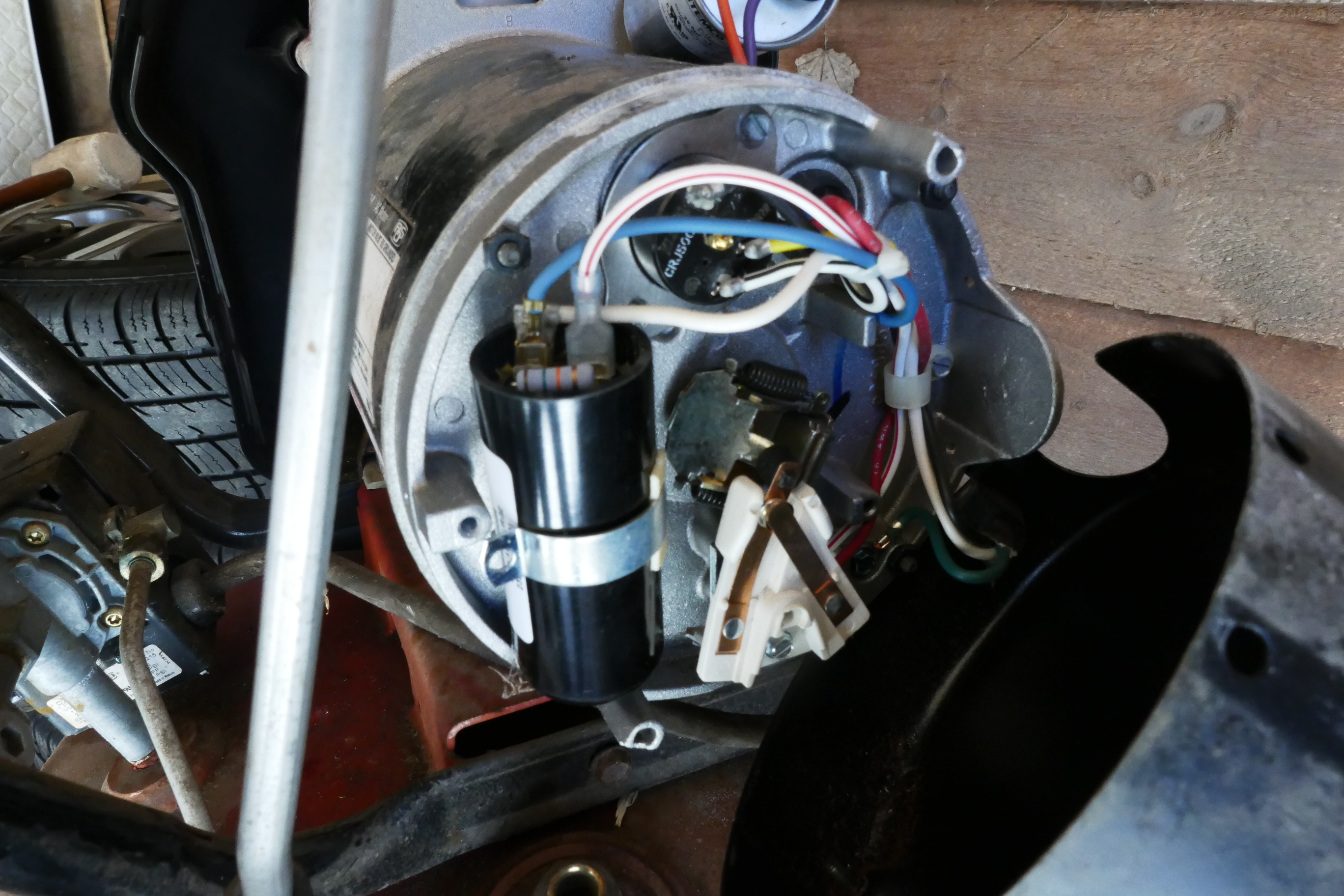

Is this motor wired for 120v or 220v ? Most of these compressors are OEM 220v with a NEMA 6-15 plug. I've seen two guys twist the plug terminals and shove it into a standard 120v receptacle. The motors did what yours does. If yours is 220v, can you check for 220v power in case you lost one leg of the receptacle ? Or if yours is wired for 220v with a 120v NEMA 5-15 plug stuck on it, what can happen ?

120 but it does carry a 220 vac starter cap.
/ Air Compressor puzzle
#23
Most likely. It is mf rated. That cap is rated from 136 to 163 microfarads (MFD). Start caps are always much higher. You can see the bleed down resistor on the top, and the circuit goes through the points (white/red wire). I think the sears tech is saying it doesn't have a "user maintainable start capacitor." As it is inside the motor in this case.
If I cannot find this exact cap, how close can I come as long as it fits into the motor housing?

Try to keep the same mfd, you can go up on voltage. Most start caps are rated for higher voltage than what they start. 230 motors have 370 volt and sometime 440 volt caps.

Trying to grasp this but this does not sound like my configuration. Indeed this compressor was bought in 2004. Only possible phenolic disc I see has wires coming out of it.

Yes, yours doesn't look to me what is described in that link. The link talks about the points being on the back of the plastic. Yours are on the motor frame.
Here to hoping the starter cap is the problem! If it is and the new cap works, I would put the resistor back on. It is a human safety feature to bleed the capacitor to a balanced potential. The motor will work without the resistor.

So I order a new start cap which is returnable if I do not open the package. Before I do so, I think to put a meter onto the present start cap so I broke off the resistor and proceeded to test the rather good looking cap (no bulges and totally intact including the relief). Needle pegs all the way and adroitly returns as it is supposed to. Something is telling me it is not the start cap. The run cap also tested successfully in the same way.
As a result, there could only be two things left. Bad windings (of which I would not replace the motor) or bad starter switch which I would also not replace due to the $132 cost. Unless I'm missing something, it appears a new compressor is in my future.
Anyone know what this little disc on the top part of the motor labeled "CRJ500" does?

Looks like a bimetalallic auto reset circuit breaker. If overloaded and things get hot, it will 'pop' to keep things from burning down. When it cools enough, there will be a click and it passes power again. Like the ones in coffee makers that click on and off to regulate the heat plate temp.
/ Air Compressor puzzle #37
Can you measure the windings? Make sure you don't have a short/open?
/ Air Compressor puzzle #38
I'm still pulling towards a start cap. But it isn't my money. If the windings are good, I'd go with a start cap.

It is referencing a run cap, but you already replaced that. The only other thing that typically fails is the start cap.
/ Air Compressor puzzle #39
I was told by a Sears tech that this motor does not have a separate capacitor for start/run functions. The switch turns the thing on ok but it just isn't getting to speed. What's this thing I found in there?
That is start capacitor. About $30-35 for new. Google Mallory 136-163 MFD. You can substitute another brand as long as the capacity is close to 136 - 163 microfarad, voltage is 220 or higher and it fits inside. Airconditioning and refrigeration service should have some in stock. They should also be able to test yours if it is bad. Many digital multimeters have capcitor testing function. AideTek DM47 LCR meter multimeter tester capacitance Inductance Resistance self-discharge compared with FLUKE - - Amazon.com
