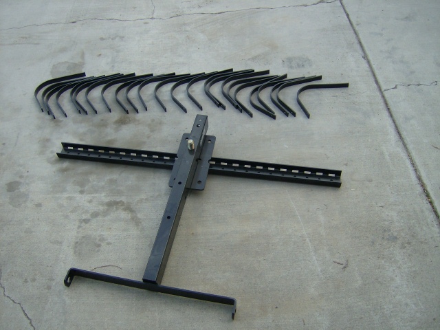

I took posession of my new Agri-Fab Landscape Rake on Saturday. I special ordered it so the guy gave me a discount on it. He gave me an additional discount if I'd put it together.
I took some pictures while I was putting it together. I'll post them along with some narrative. When I finally get to use it I'll try to post back with a review.
/ Agri-Fab Landscape Rake
#2

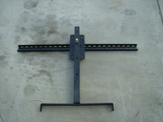

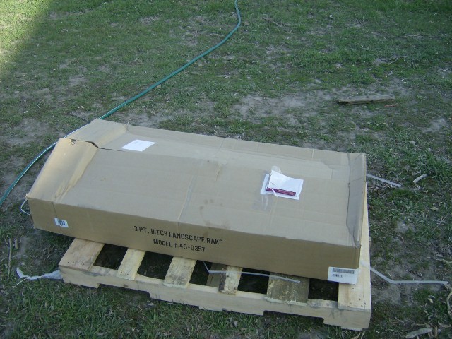

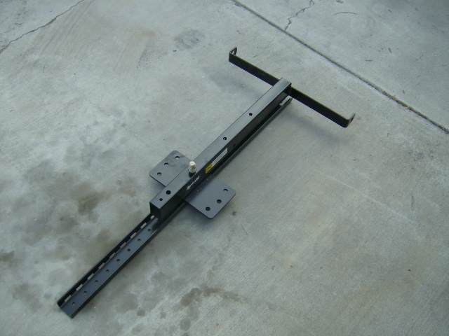

The first picture is just of the box that it came in. The second and third pictures are of the mast assembly as it comes out of the box and then folded out as it is used. The fourth picture is just a picture with the 24 tines layed ready to be assembled.
Notice how Agri-Fab has accomplished securing the tines with just a single bolt. There are slots along the back of the pivot assembly to hold the tines in place. I'm not sure how this is going to work. After I've used it a bit, I'll post back with the results.

I bolted the tines on using an impact wrench that I turned way down. The Nylock nuts that they send with the rake go on slower than regular nuts, but I think I'm going to be glad I've got them a few months down the road When they're still tight.
The hardest part of putting the tines on was fitting the tines directly under the plate that the mast and pivot turn on. I put those four tines on last, and there wasn't any room to get my hands in to start the nut. The holes in the plate aren't big enough to fit the impact socket into; so I had to use my hand socket. The picture below shows the trick I played by putting a gob of grease in the socket under the nut to hold it in place until I could get the threads started.
The second picture is out of order since the rake is complete, but it fits into the narrative right here since it shows the tines all crooked. I went through the whole thing twice and this is as even as I could get them. Once I got the tines as good as I thought I could, I turned the impact up one notch and gave each nut a good torque down.

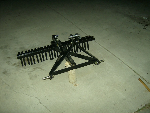

Putting the mast support and braces together was pretty straight forward. The instructions are well illustrated and easy to follow.
Start to finish I spent about an hour and a half. I was talking politics the whole time with my liberal neighboor and had a few other interruptions. Given perfect working conditions it might have come together even faster.

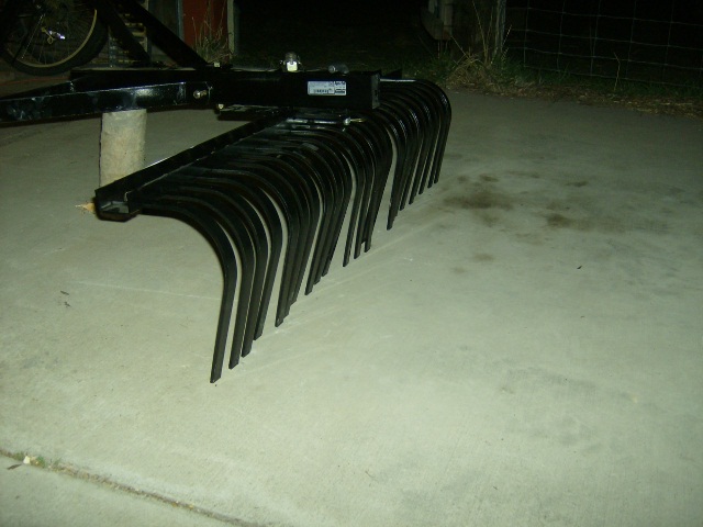

The picture below shows the completed rake. As you can see in the picture, It was dark by the time I got it finished. I'll wait until Monday to try it out. After I've used it a little, I'll post back with my review.
Already I can tell you it doesn't look too heafty, but then again my tractor is only a 17hp tractor. I think it will be perfect for my place.

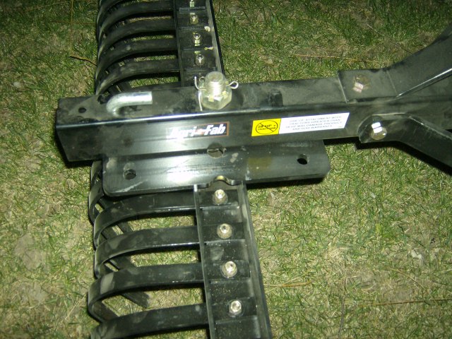

/ Agri-Fab Landscape Rake #5
Congradulations on the purchase. Now we can wait to see some action shots!:) By the way, do you have any pictures of how the plate mounts to the piece of angle holding the tines. I am assuming that the entire project bolted together. I am refering to the plate that is sandwiched between the angled iron and the three point assembly.
I've attached a picture of the pivot mechanism. I don't know if you can see what you're looking for in this pic.
The tines are actually in a piece of slotted "U" channel. The tines go through the slots and then bolt with a single bolt.
The plate above the "U" channel upon which the whole thing pivots is actually welded to the channel that holds the tines. The large pivot bolt is welded to the plate too.
