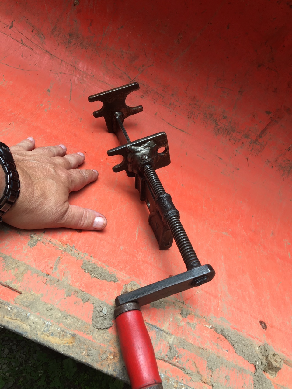

I bought a Wait tool. Haven’t used it yet. Made my own clamp and use it at times. Often change implements and connect lines on the grapples and cycle the third function valves helps relive pressure. Having the grapple not sit in the sun helps. Sometimes you can’t so the reason for the tools.

Interesting tool! Care to explain how this works?
/ Ag vs flat face on grapple #25

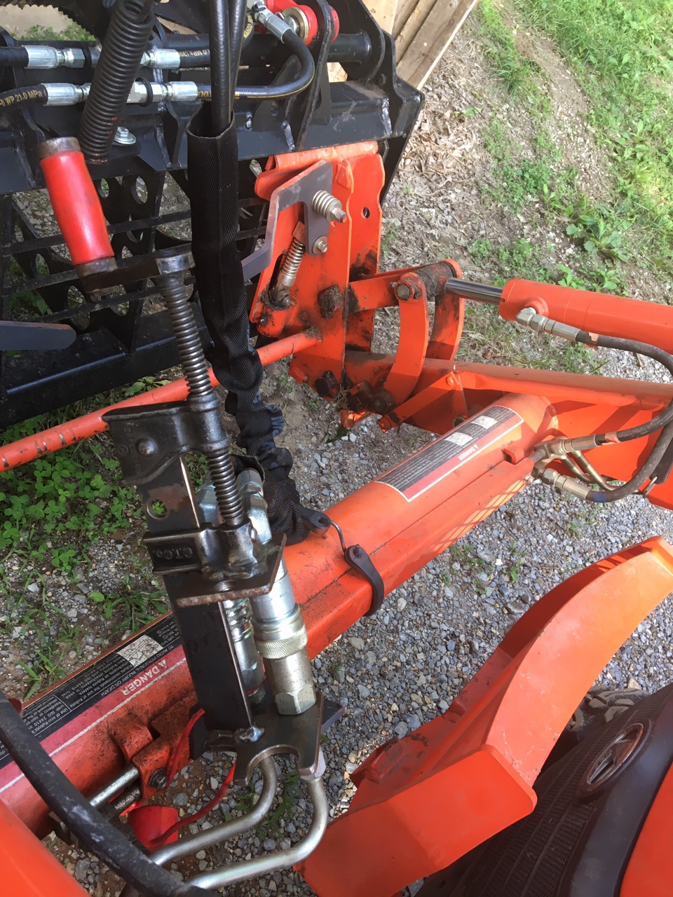

Use the clamp to squeeze the fittings together. Doesn’t take much force just more than I can do by hand sometimes. Make sure the flat face couplers are aligned, squeeze gently and wiggle if you feel any resistance.
There is a similar clamp made by a guy on eBay.
Like how clean and easy to keep clean the flat face couplers are to use. Have switched almost all of my equipment to the flat face couplers.
