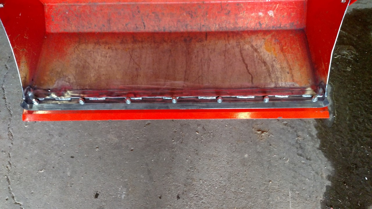

I had to replace the original cutting edge on my BX2230 a while back. I bought a new factory piece, and a replaceable edge for a later BX, clamped them together, marked the holes on my original type edge and drilled it so I could bolt the replaceable edge to it. Had the replacement edge welded on and then bolted the extra edge to the bottom of it. Trimmed the attaching bolts off flush with the nuts and it has worked like a charme ever since.
