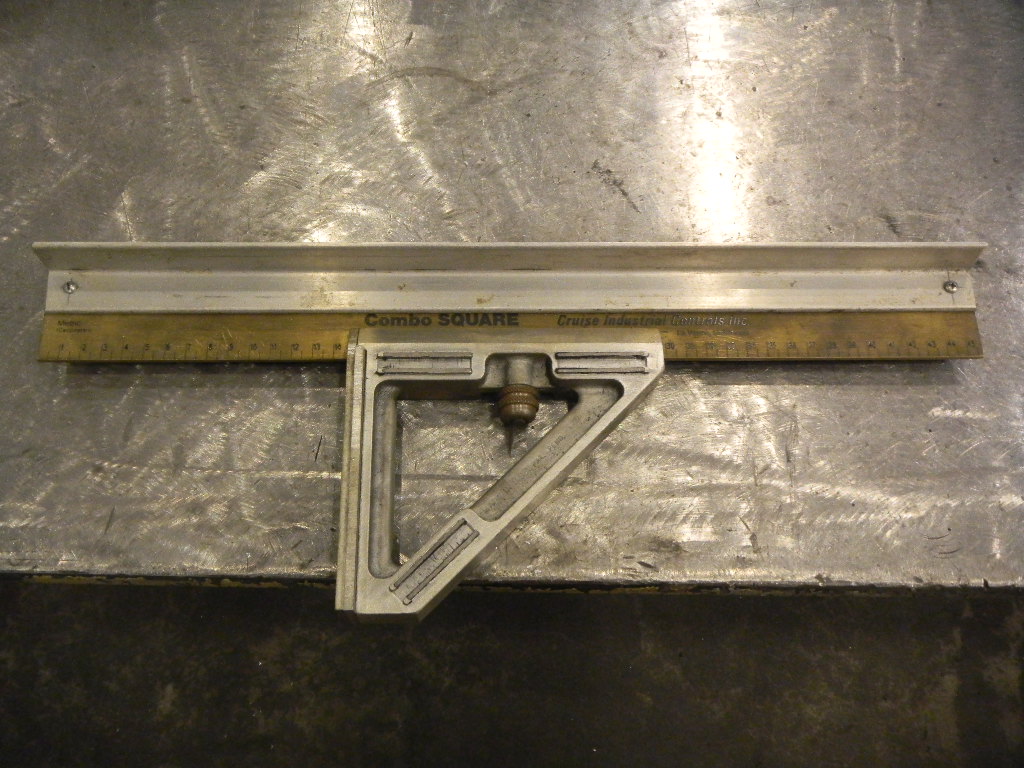

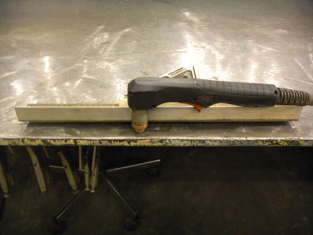

I bolted a piece of aluminum angle to the brass bar on my magnetic burning square. Works great on steel, but the magnets don't hold very well to aluminum or stainless steel, maybe they're wore out?:confused2:
Good stailess is usually non magnetic. You need special magnet for Al. It is similar to oak magnet used for welding of oak boars with hard wood electrodes.
