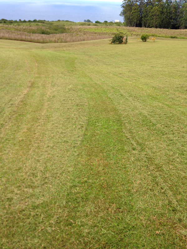

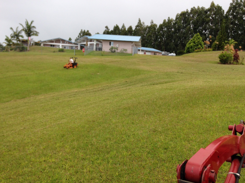

Just for comparison.
Wife and I mowed today. As you can see in 1st pic this pasture is only about 6 inches tall, not really very thick. I'm not going to say which areas were mowed by my value Leader flail with Y knives and which areas were with the scag ZTR. You can see the uncut areas.
2nd is where we met up - done
Soooo, discernable difference?
David Sent from my iPad Air using TractorByNet
