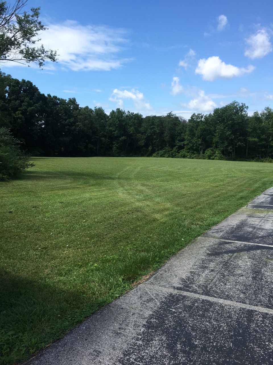

I can cut the first picture in 8 minuets and the second picture in 30 minuets. IMG_1142.JPGIMG_4348.JPG

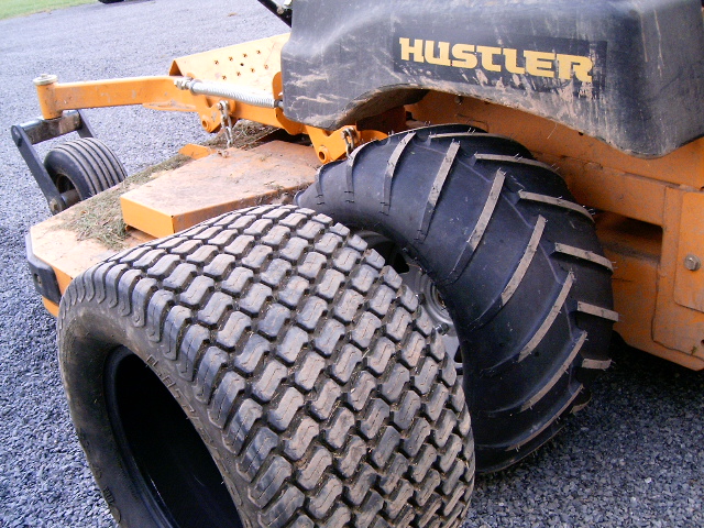

I mowed my property in 4.5 hours with a 46" Craftsman rider. Bought a Hustler 54" Raptor SD zero turn and cut it down to 2.5 hours. Used the RSD for 2 years and then upgraded to a Hustler 60" X-One and cut it down to 1.5 hours. Traction can be an issue on wet slopes. I may upgrade my tires to AT101 tires. The reviews say they solve the traction problems.
https://www.amazon.com/gp/product/B005O5NLOS/ref=ask_ql_qh_dp_hza
I highly recommend the Raptor SD. It costs $3800 or so. If you want to mow faster, you will have to pay more.
I put the AT 101's on my Hustler Super Z.
Made a huge traction difference over the turfs (the stock turfs were horrible on wet slopes)
The hills I always had problems on with the turfs are no problem at all now.
Plus they look awesome!
