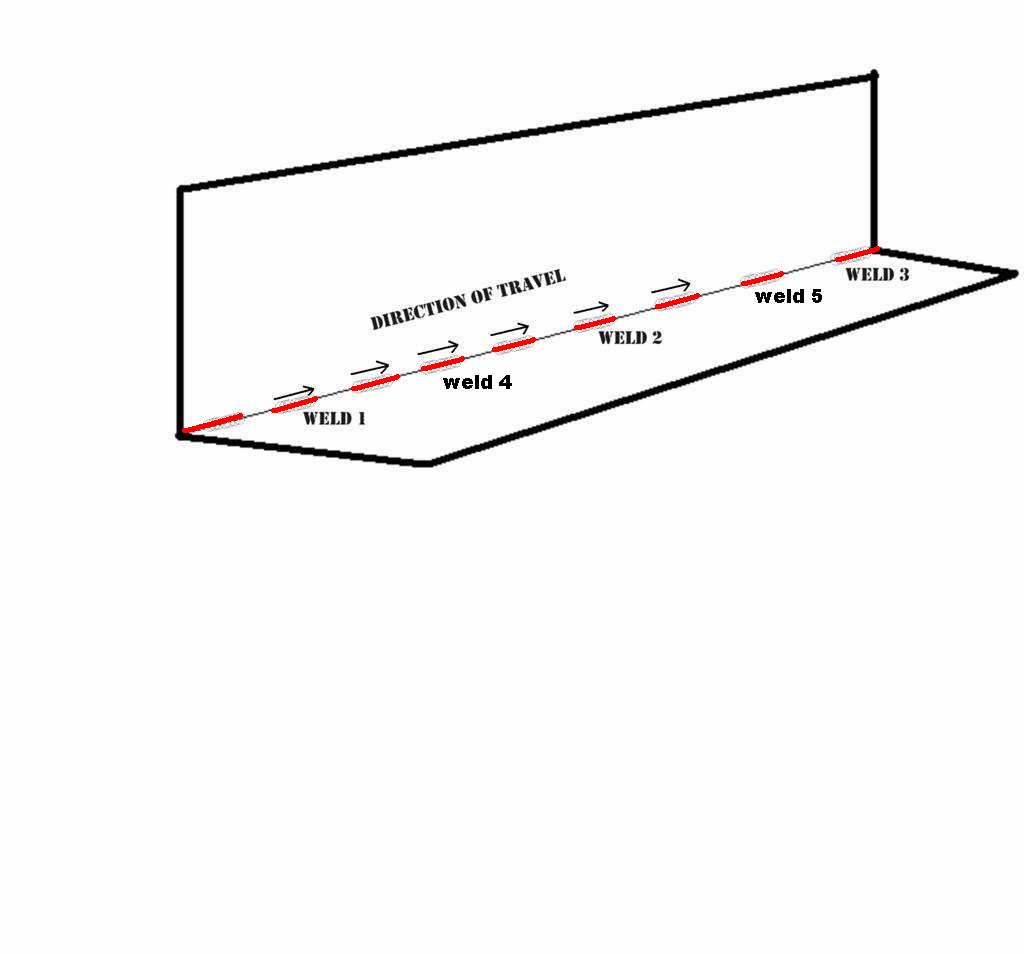

downsizingnow48 it won't help much in this case. But for future welding work. When you make a weld, if you can make a weld on the opposing side. When making long welds, back step them, and skip around a lot. This will break up the heat line, which helps with distortion.

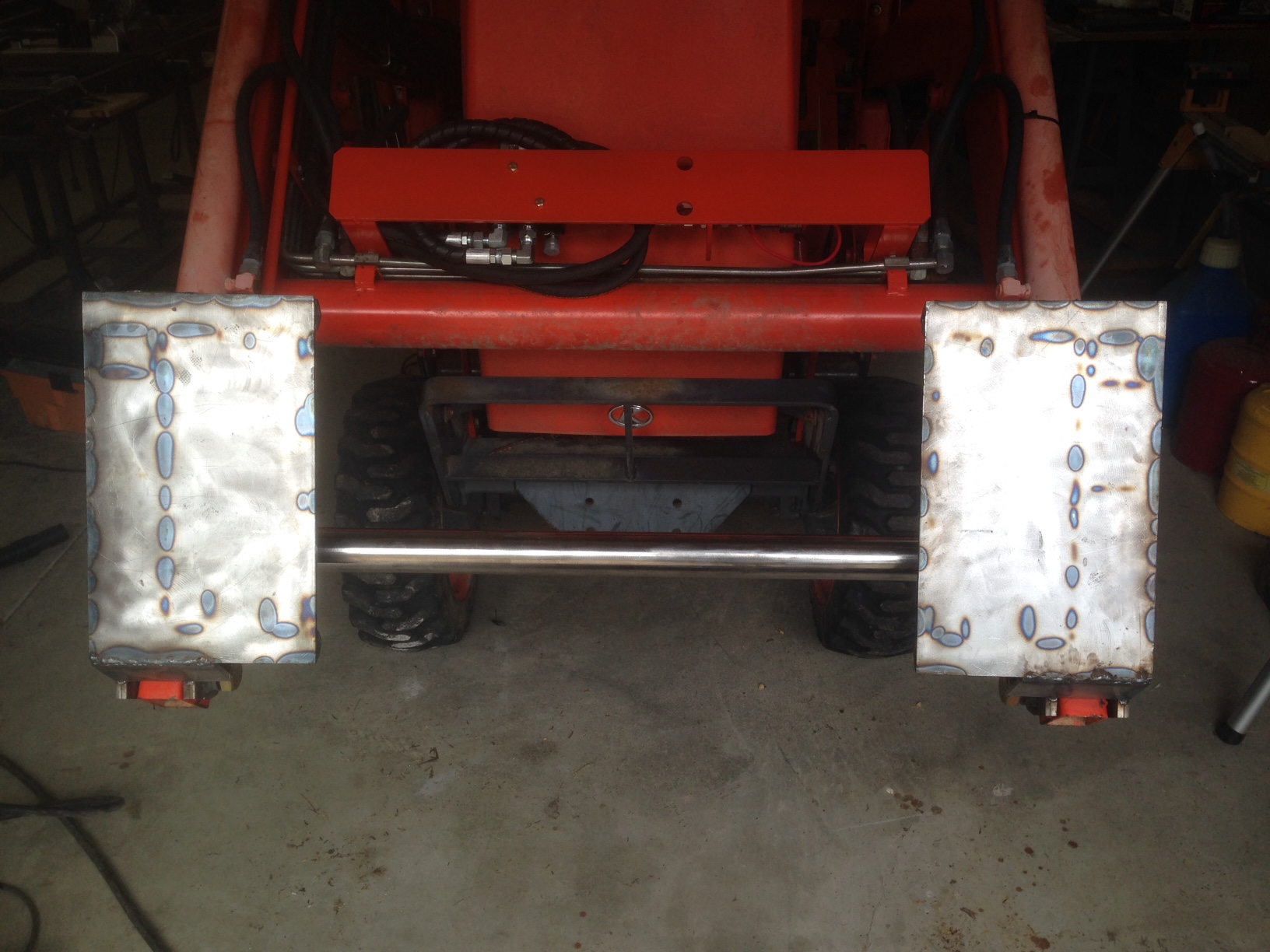

Since we are on the topic, let me throw out another situation.
When I made my SSQA, I used the skip-around method for welding the inside ears to the "paddles". You can see that in the photo below where the vertical burn-through marks are. Even so, the weld pulled up the plate and I ended up with a 1/8" vee. And I also had already welded inverted 1/4" angle to the top and bottom of the paddle. Everything bent. To fix that I welded a heavy bead right down the line of burn-through marks. Similar to what Gary said. That pulled the vee straight. Then I had to grind off the bead. As a rescue operation it turned out OK although I thought for sure there had to be a better way.
