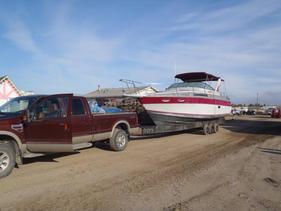

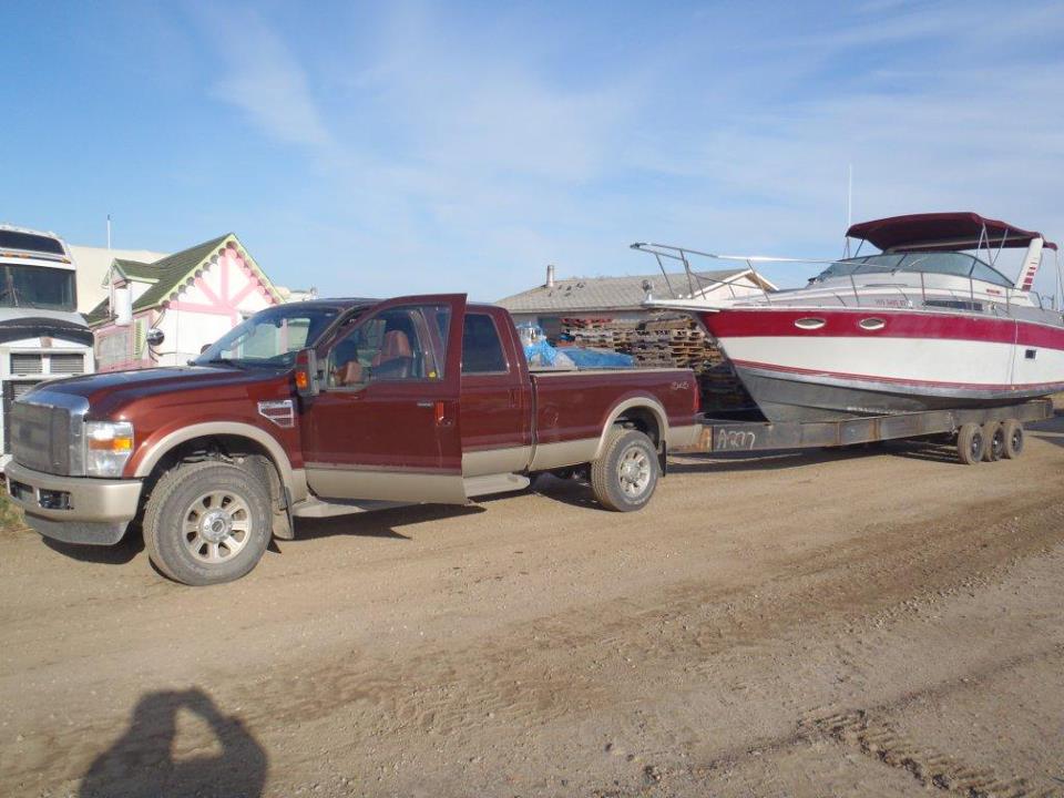

Well I have the new spring hangers welded on, the spring shackles were set 1 inch wider than the springs and when the unit was set down the travel was 3/4, this should give plenty of smoothe travel for springs. Got the gusset plates welded over the splices and top and bottom flanges, hooked it up to the truck and tongue weight is 350 pounds, pulled nice for the 3 blocks where I can finish the project such as hull supports and front support, thinking I should use checker plate at the front to box in the frames giving some storage. In both pictures the boat looks small compared to the truck.
