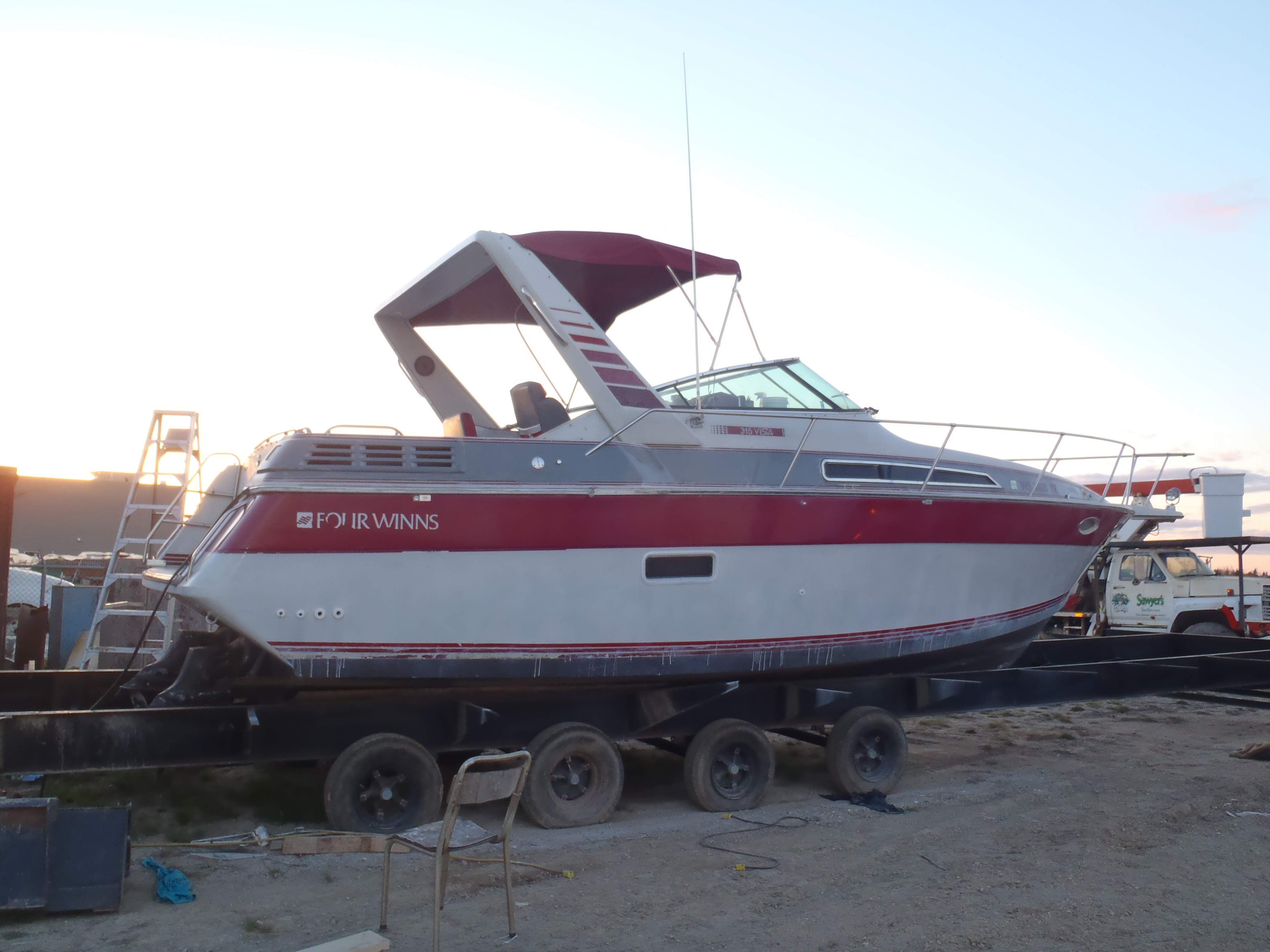

I worked as a pipe welder for many years and then quality control in heavy construction so I will give you my thoughts. Looks like you have already started with the welding. Since you have a portable DC machine, I would use the 1/8" E 6010 which is a DC rod for tacking and root pass. Clean the slag and follow up with 3/32" E7018 DC rod for fill and cap pass. Make the fillet weld pass have a throat dimension at least the thickness of the material you are welding and always weld both sides with a seal weld. DONT leave any holes for water to enter and start corrosion from the inside. E7018 is also more corrosion resistant than the 60xx rods and 10,000 PSI stronger so those are good for the filler and cap passes. They also weld really well with DC in all positions. You need to run your machine a bit higher amps when welding overhead (maybe 10 amps) which helps keep the slag at bay. 7018 require a short arc length compared to the 6010 so hold the rod as close to the metal as possible without it sticking. They dont weld so good with any type of gap so use the 6010 to run a root pass first. You shouldnt need anything larger than 3/32" 7018 for the steel that you are using. They may be a little slower than using a larger rod, but you can make much better welds with smaller rod if you are out of practice. 1/8" 6010 is all you need for that. I wouldnt go any larger nor smaller.
Good luck on your project. I was going to suggest that you didnt need 4 axels but I see you already plan to remove one and close the gap between the others so that should make it easier to turn.

here is where I am thus far, I will get some 6011 tomorrow

I sure hope you're planning on welding in some good solid patches over those high stress areas.
Maybe adding some grade 5 or 8 bolts to it as well. :thumbsup:

That's exactly what I was thinking/ would do. Overlapping plate each side of those butted joints. That is a nice big main frame to work with.

I am just a farm welder but have to agree about "fish plating" all of the butt joints. There is going to be a tremendous amount of stress on the entire trailer with all that weight, especially in turns. Even a once a year trip to the lake will be a disaster if one of the welds fail.

Thanks for the comments, I do lots of mig welding but I know the welds look good but the penetration is the pits, I have got a couple boxes of 6011s today, played a bit vertical welding on scrap and figure its not that bad.
Now regards the fish plates, I have several plates in 3/16 steel sheared to put on the flange where it is butt welded, also got several pieces to weld in place over axles like the original see the front side.
also got some lazer cut gusset plates to weld on the top and bottom flange and will be adding several braces between the rails to replace the light angle they used originally.
Today also cut out the front axle and moved the outer 2 closer to the middle one, this will give a better turning action, tomorrow will see what weight is on the hitch, want around 750 pounds, this should be fine.
Plan on pulling with my Ford 350,,,, well I have a Kenworth T600 which should do the trick.
Once I have everything prety solid I will rent a crane and lift boat off to complete welding and add the 2x10 supports for the underside, not sure what to use on the front for the hull, not to add a winch because the weight of the boat will not easily pull with a winch more to stop it coming forward during a hard brake action.

AWS D1.1 Code for Structural Steel. I am a CWI. Back gouge, CJP, E7018 or
E71T. Then do complete Visual exam. Just my two cents...

well, the Miller Bobcat 250 is a awsome machine, I have owned it for 3 years and finally used it as a welder, it performs well, tacked the trailer together with 7014s, all I had, today purchased some 1/8 and 5/32 6011s, welded horizontal, vertical and overhead and must say after a couple hours it is getting better, well better looking, vertical was problematic due to a gap over 3/16 in places but not fast it welded up fine, got some fish plates left on the splices and should be good to go.
After welding I put it down on the axles, figure I had about 1000 pounds on the front so back in the air and cut off spring hangers, change from slotted rear hangers to plates, will be welding back on tomorrow in a new location, should have 300 pounds when finished, Il put some pictures up tomorrow
