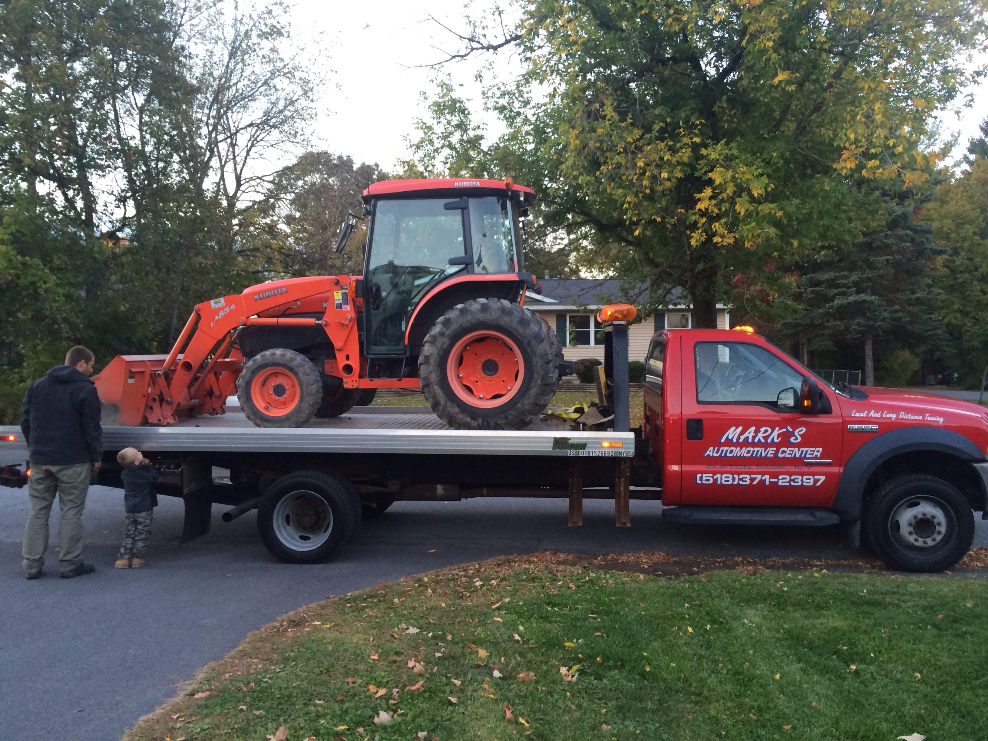

Well I ended up buying it the other day, mechanically in great shape, all servicing done with records. It needs a good thorough cleaning and a buff job to get rid of the pinkish fenders hood and roof, but other than that nothing. I'll post more pics once it's all cleaned up. Thanks again for all of the input...I look forward to spending more time on the site :drink:

Looking good.
By the way, is "upstate NY" everything north of Albany? North of Poughkeepsie?
/ Advice on L5740 Kubota #17
Congratulations, it should clean up quite nicely. Your partner sure looks like he approves.:)
#18
Yup, that's my little gear head, he needed to unload it with me and of course take a quick spin around the neigborhood haha.
