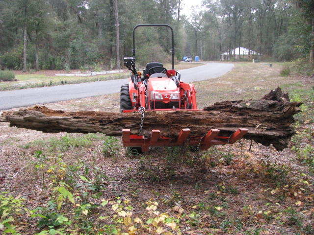

Hello all,
I am receiving my new LS XJ2025H soon and the first customization I want to do is put a pair of bucket hooks on it. I see a lot of people seem to like Ken's Bolt-on hooks but I would like a more universal style hook like tow hooks that you could use with chains or straps. This route would also be much cheaper by about 75% savings.

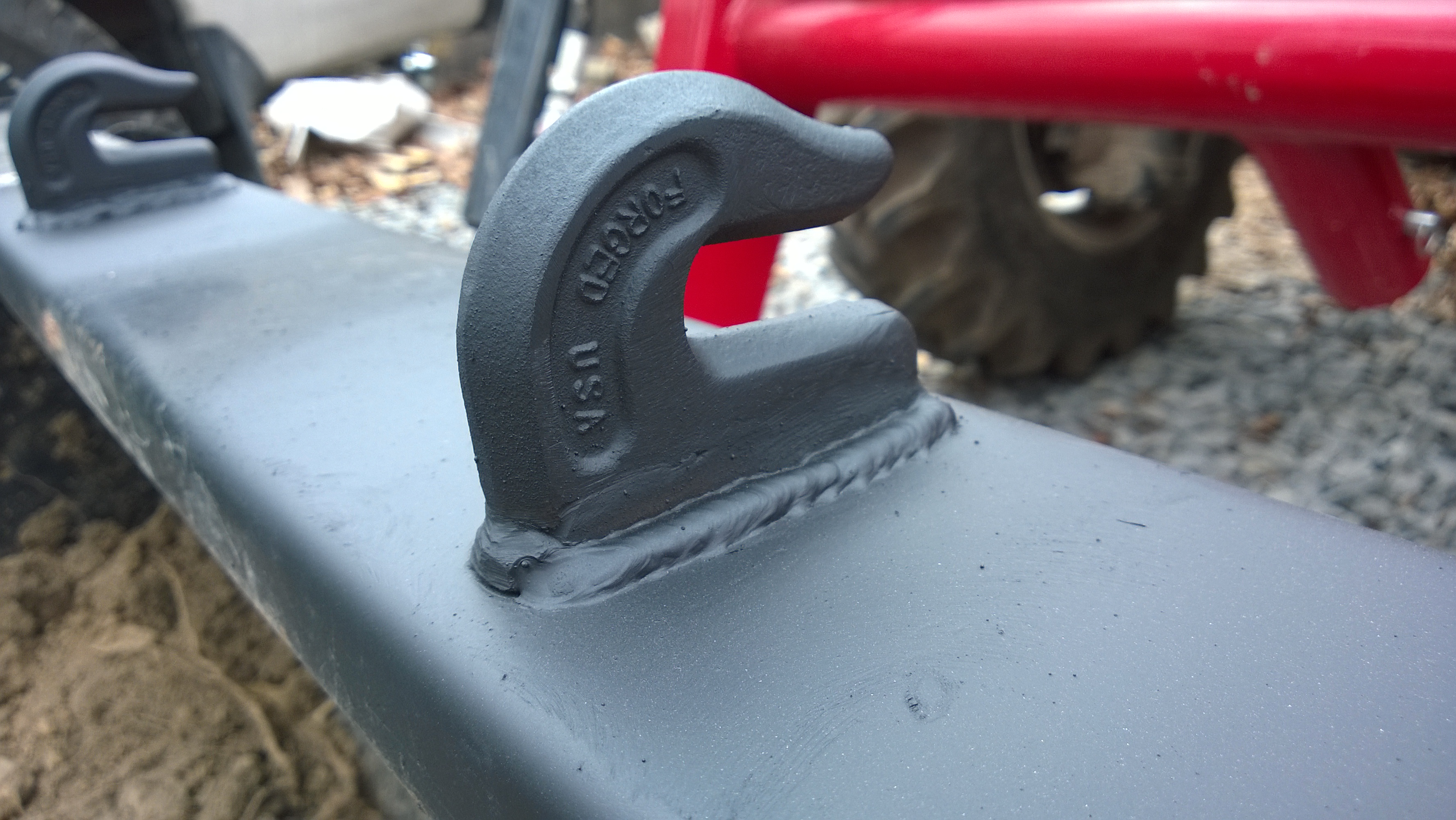

The hooks I used are grade 70 chain grab hooks. They're tested for high stress applications.
Chains pulled to the breaking point do not just drop, they fly too. You should never pull with anything that doesn't have something else attached to it to keep it from flying. Use a slacked rope to tie down a pulling chain or use a slacked chain to weigh down a pulling rope, this keeps things from flying...

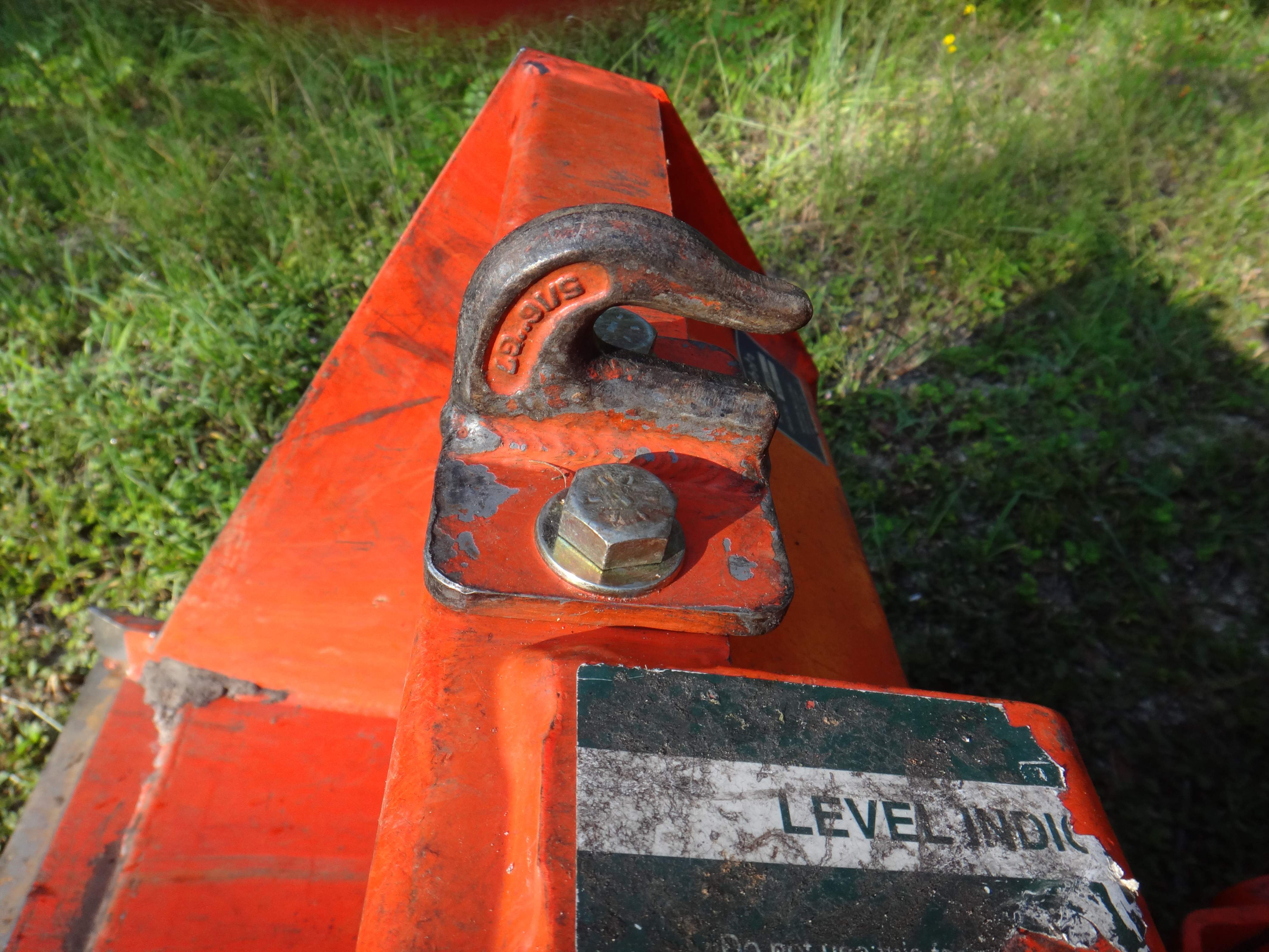

I regularly use my clip on hooks from BXpanded. I know, maybe not the load capacity some have but don't laugh they work great for my needs. As far as repositioning them... Never had to, located them between the outside of the FEL arms and side edge of bucket. A third one in the center could be useful but I haven't needed it to date.

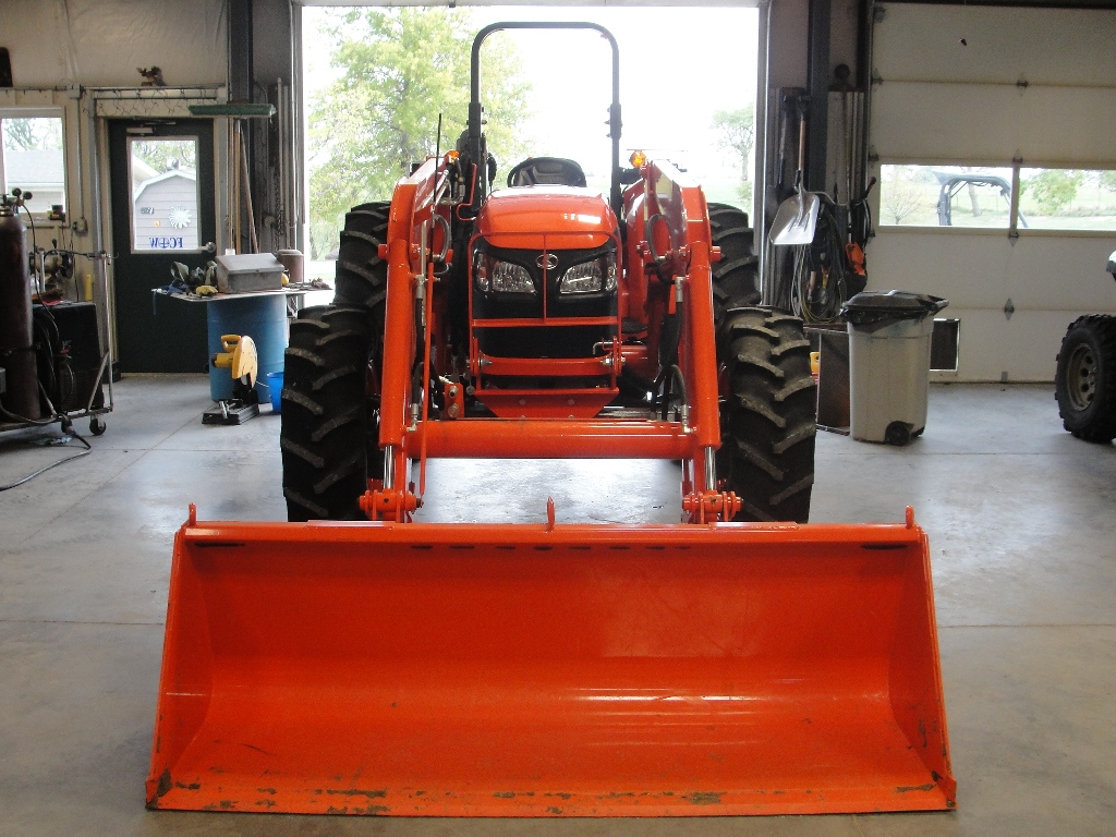

The Dealer put this style hook on for me.Just another idea.The hole works good for ratchet straps or rope.The hook works for straps.bucket hooks.jpg

I welded a piece of angle across the top of the loader bucket to reinforce the bucket and to give a sturdy flat surface to weld on a pair of grab hooks.
I WISH I WOULD HAVE FLIPPED THE ANGLE and slotted it! Grab hooks only grab one way, and that has been a problem a couple of times.

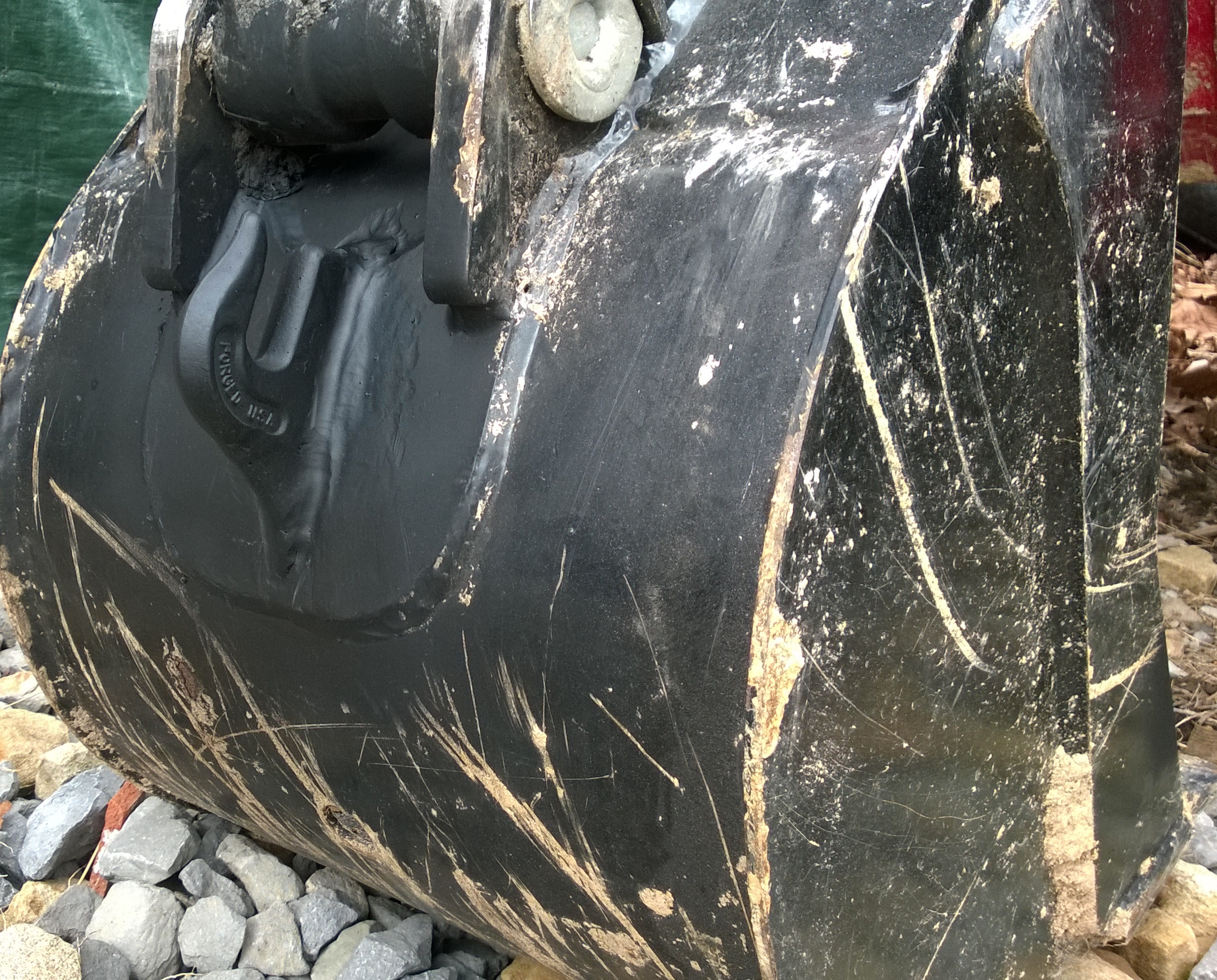

I welded one hook onto a mounting plate that I bought from Ken's on the lower portion of the rear of the bucket. I also welded a shackle mount to one of Ken's plates and welded it to the underside of the bucket lip inside the bucket. Combined with a clevis shackle I can use that for a single point lift using straps for lighter items.
I got a length of 3/16X3X3 angle to set on top of the bucket lip which would then be welded to the lip and to the back of the bucket. This was my only problem of the day. When I measured everything up and bought the angle I forgot about the 3/16" thickness of the angle. When I set the angle flat on top of the lip there was a 3/16" gap under the vertical leg on the back. Fortunately I had some 3/16"X 1 1/2" flat stock in the shop. I welded the flat stock to the back of the bucket and then set the angle on it and welded the angle to flat stock. I stitch welded everything and moved from front to back and left side to right side when I made each weld in order to not overheat the bucket. One solid bead would have looked better, but I didn't want a warped bucket. I took my time and continued welding in the gaps until I had a solid bead all the way across the front edge and bottom leg of the angle. Hooks went on with no problem, 1 in the center and the other 2 centered on the FEL arms. Then I added 2 small shackle mounts that I got from Ken's outboard of the hooks, again just for lighter lifts with nylon straps. I didn't run the angle all the way across the bucket as the FEL is only rated for 900 to 1,000 lbs so I won't be lifting anything too heavy.
Primed then painted it all up with Kubota orange paint and this is how it came out.

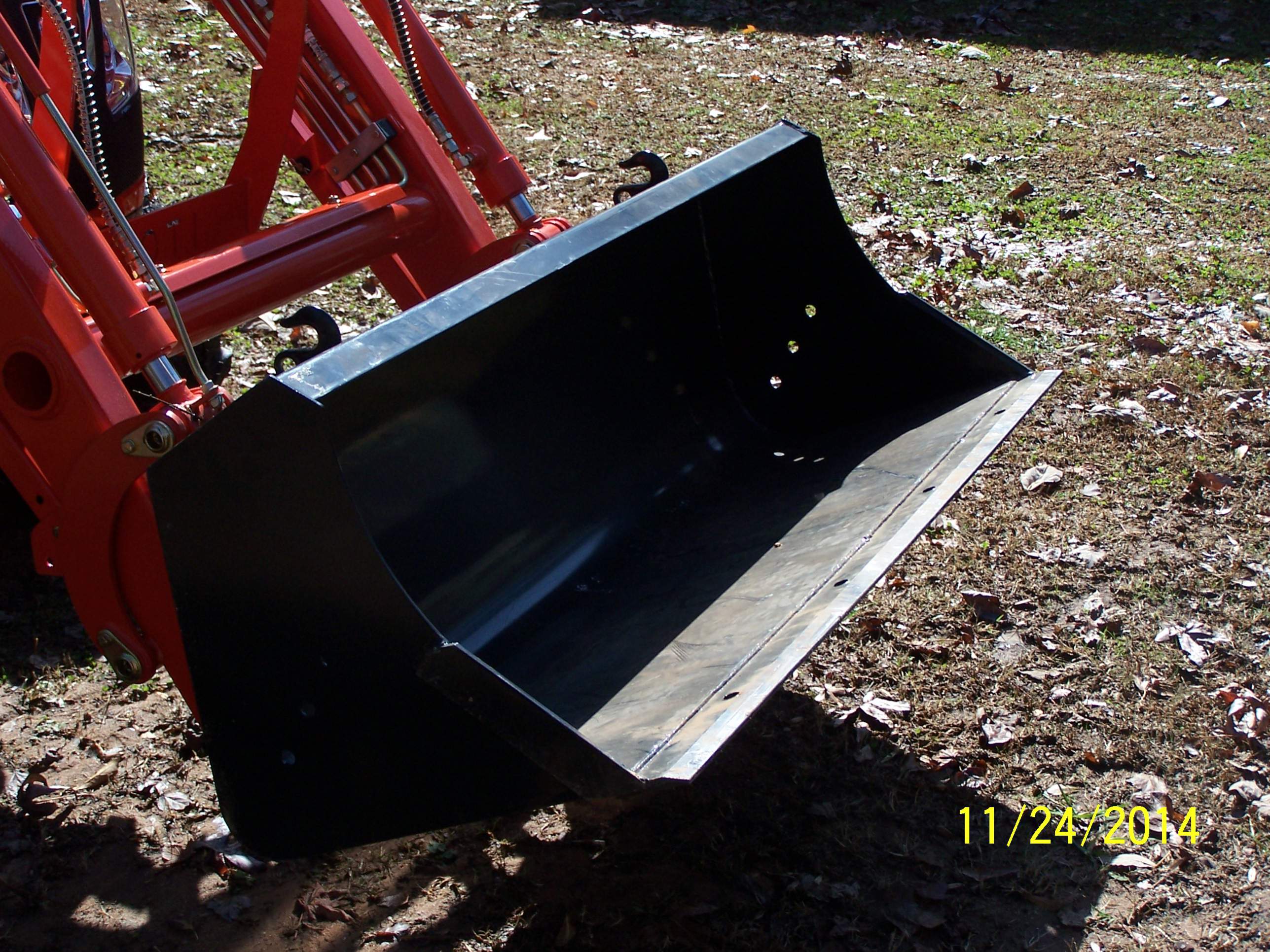

1 chain grab hook welded in middle of bucket
1 chain grab hook welded in line with each loader arm
2 slip hooks welded about 6 inches inside of each outside grab hook.
so, that's 5 hooks total. I've used them all from time to time.

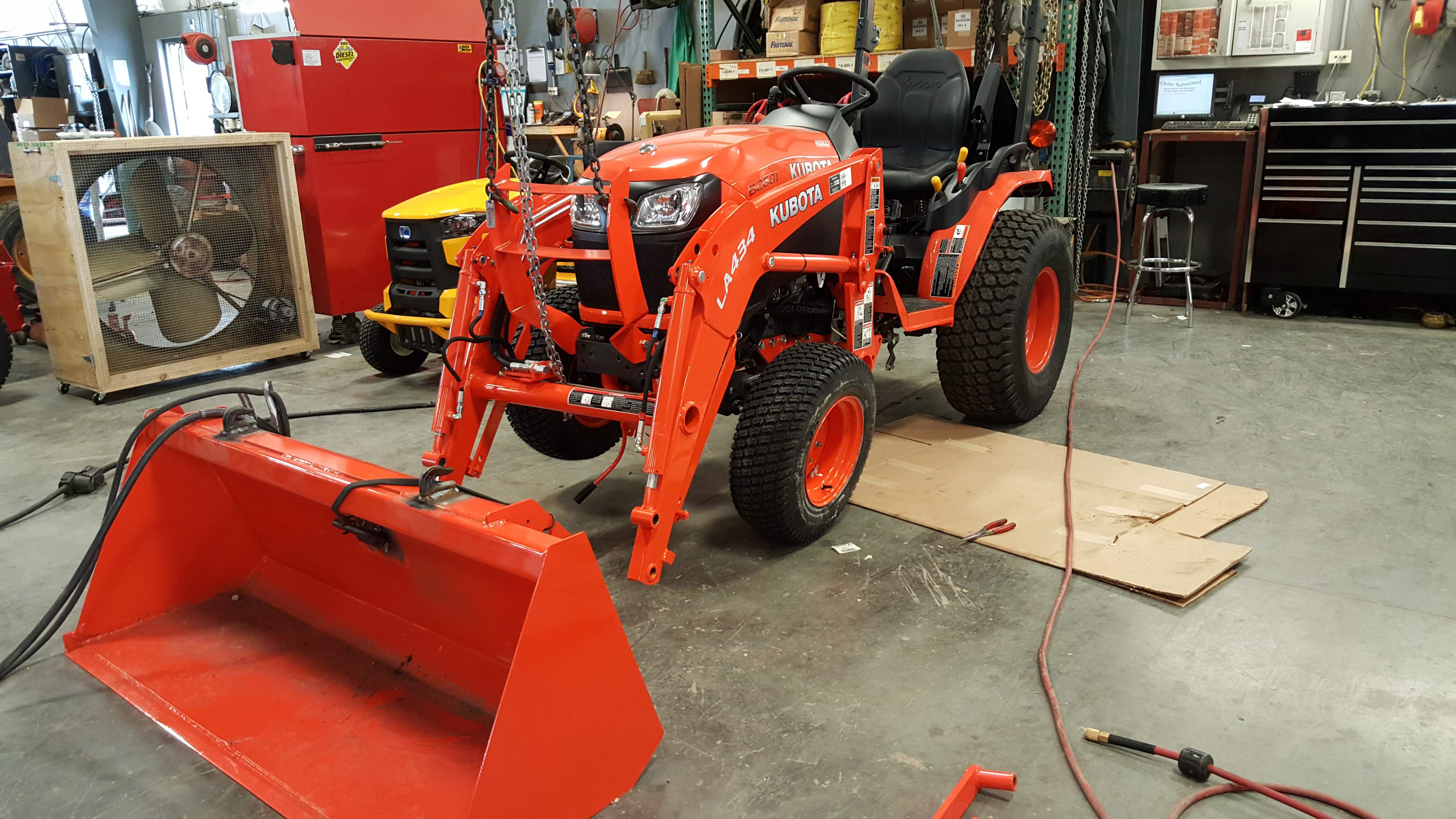

Not sure what is your point on under-sized tractors and use of hooks, but if I understand right... I have a BX and I get plenty of use with my hooks and chain. :cool2:
