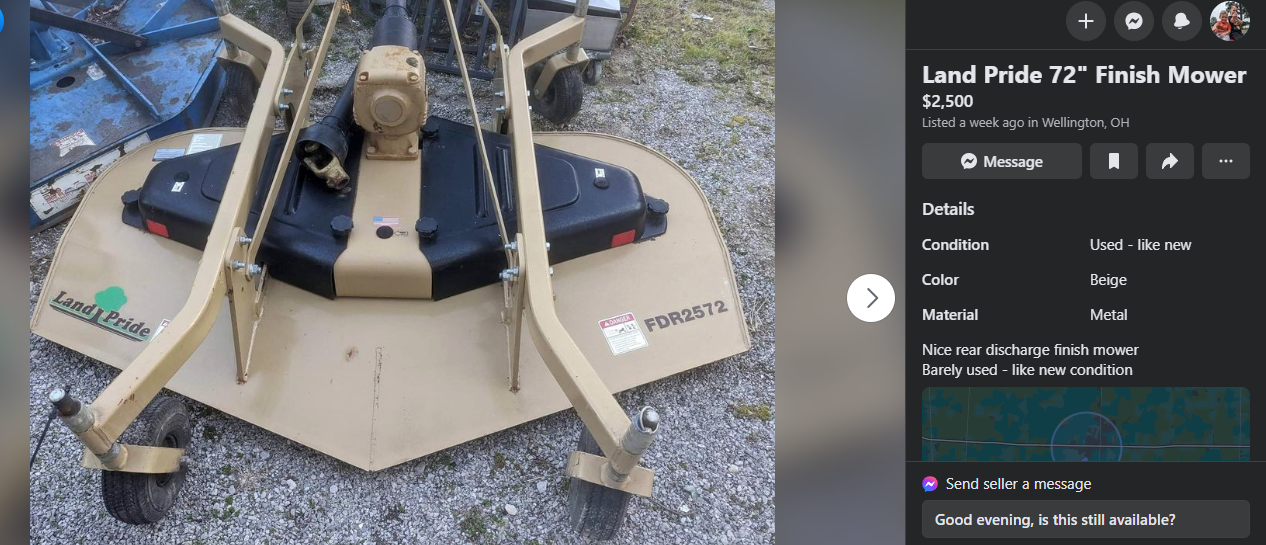

Several years ago I needed to acquire a finish mower. I did all the research, and finally decided on attempting to find a used land pride. It took several months, but I found a used FDR2572. Was $800.00, but the tires were in good condition and there were no bent arms on the unit (never buy bent attachments, it means someone was not being careful, that carelessness might carry over to unit maint.). The dealer had just taken the unit in on a new tractor/mower sale, and hadn't even had time to service the mower yet. I like the Land Pride models because the high tip speed. With the exception on replacing a tire/wheel combo this summer, and replacing the old belt at time of purchase, I have spent $0.00 on repairing this mower. It is TOUGH. I maintain every 25 hours or so, and always give it a spring maintenance checkup. Keep the gearbox fluid full, and grease everything when needed, and you will be pleased. It still runs great, and I am able to stay ahead of 15 plus acres with no effort at all. I originally would have been happy with a Woods, Bush Hog or Land Pride unit, but the cost for the Land Pride really made the decision easy.

I would check FB marketplace for a used Landpride mower. They make a nice mower and you can buy them used for what you would spend on a countyline new and have a nicer cutter.
Keep watching it for about a month and a good deal on one will surface.
I have this very unit. A bit older, but it is very durable. I wouldn't trade it for any new mower.
