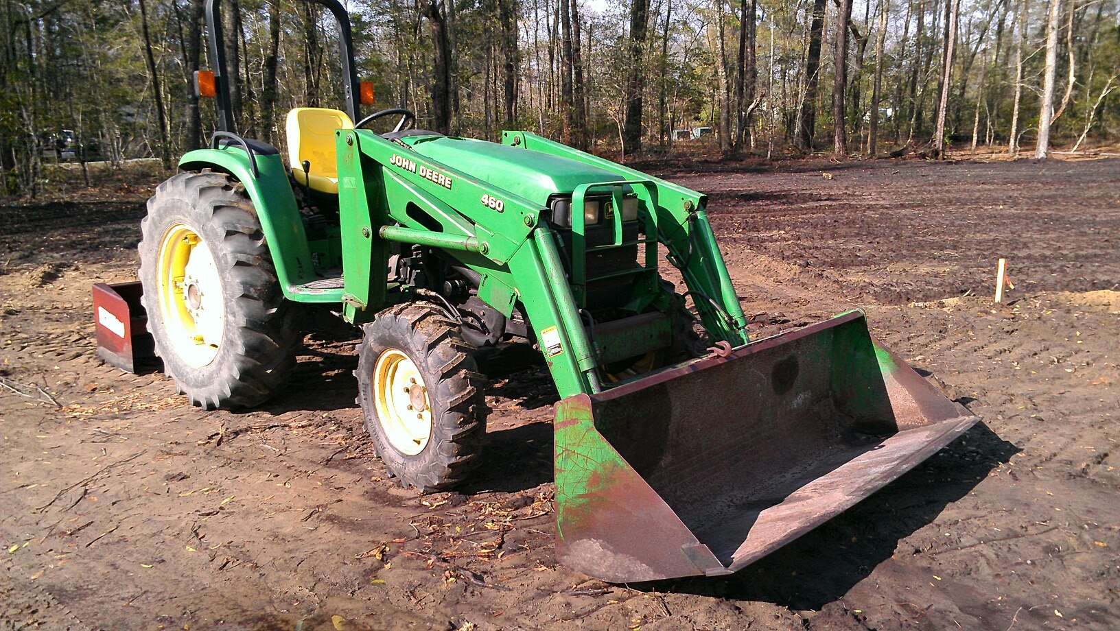

I just bought a 4600 this afternoon with 2800 hours for $8,500. It has a fel, HST and box blade...no backhoe. I feel like I got a great deal to say the least. My 5 year old son and I have already run around the property and it runs great...good sized tractor. I would certainly push on that price. I think you could find something better priced for sure. Mine is a little beat up, but nothing that is not cosmetic...
/ Advice on 4600 - First Tractor #5
Quite a score, there - YES! Tractor looks used - not abused, though. Bucket is still in great shape and the tractor looks to be taken care of as well! You done good. Enjoy your new machine.
