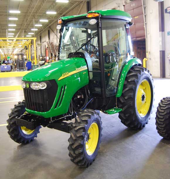

I took a look at some pictures of the 4720's.
Those hubs are really dished!! Looks like the hub face is on the same plane as the outer edge of the rim.

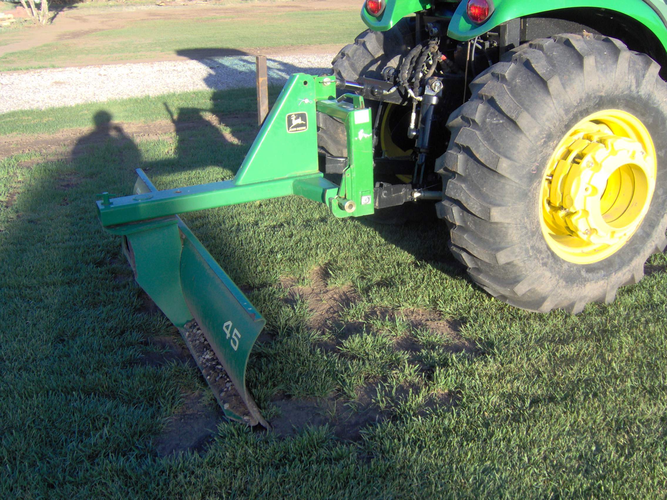

I was curious enough to go outside and look at my R4s' on the 4520, appears that it would add about six inches per wheel. I will measure in the daytime to be sure. With three weights/wheel it is hard to judge.
Your picture is a tractor with R1 tires and the removable center wheels (8 adjustments?)
Are those 17.5 24s? I am guessing on a 15" wide wheel. Is the wheel width stamped on the wheel? (might be hard to see with the weights on)
The weights appear to extend out past the wheel (may be the camera angle).
Are yours set narrow or wide? What is the overall width (edge of tread to edge of tread)?
