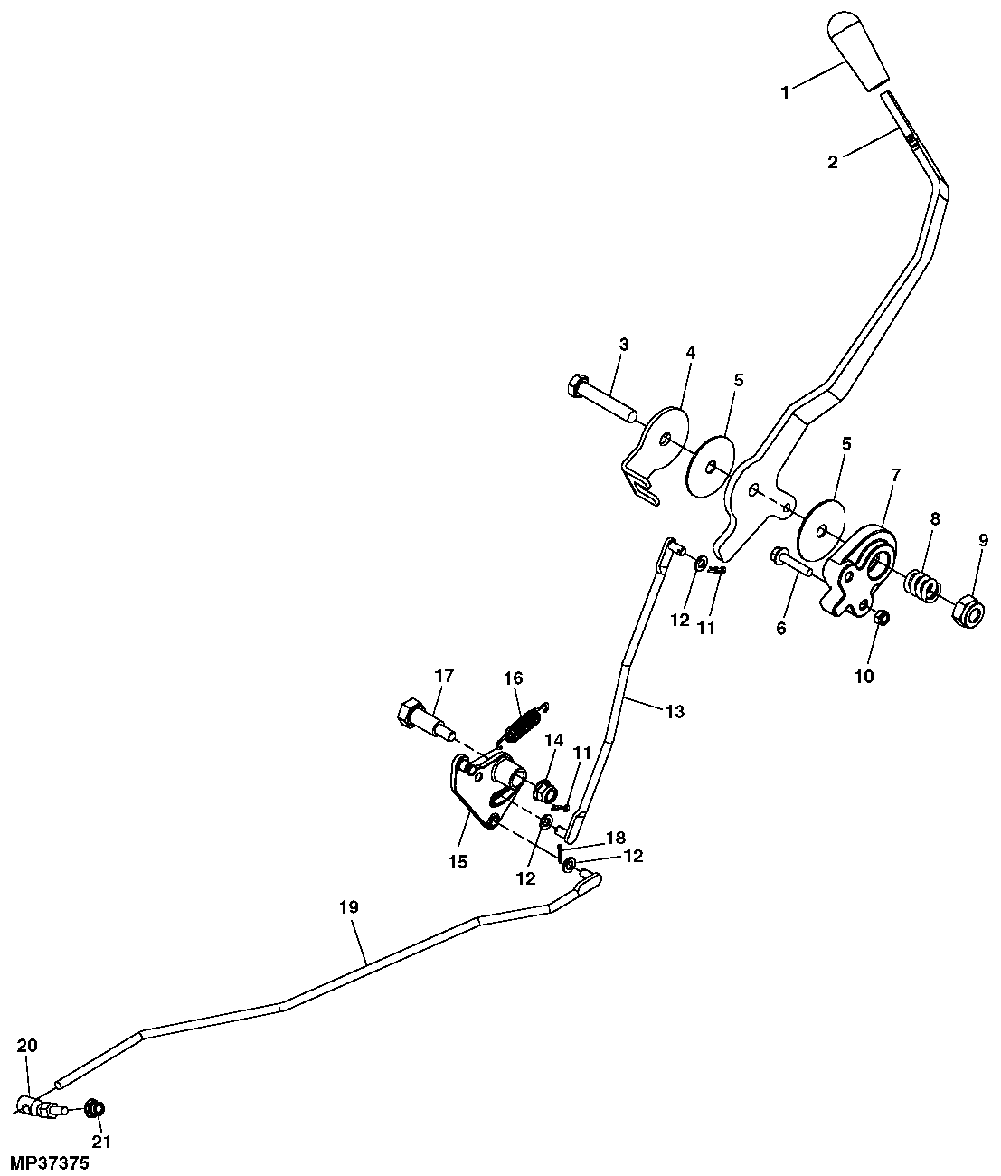

Hello, need help on getting the cover off around the trottle lever to tighten it so it does not slip and hold in gear...We have taken it in to john deere 2 years in a row to have it serviced and particulally for this to be fixed and I only have a small horse farm where I move manure out to aback pasture ever week or so for 5 horses...I drag the arena and this keeps comming loose...I end up putting a piece of wood under it in the slot to keep the speed where I need it..I know I should have bought the tractor that had a clutch...LOL
Help with this would be appreciated. I need the tractor, but last time I took it in for service it was at least 2 weeks just for a service and to fix this...I can't this time of year let it go for that length of time...

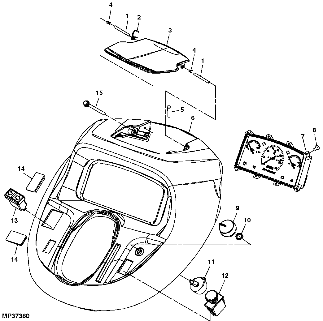

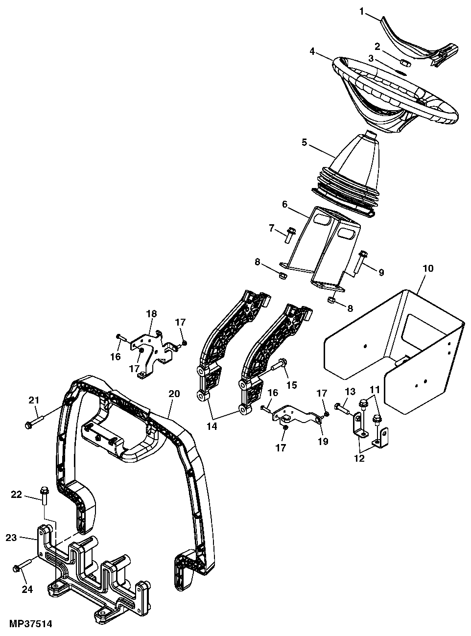

Take a look at the pictures below from JDParts, they should help I hope. In the first picture, the main pivot bolt (#3 and #9) need to be adjusted. If it won't hold the adjustment than the friction washer's (#5) may need to be replaced.
