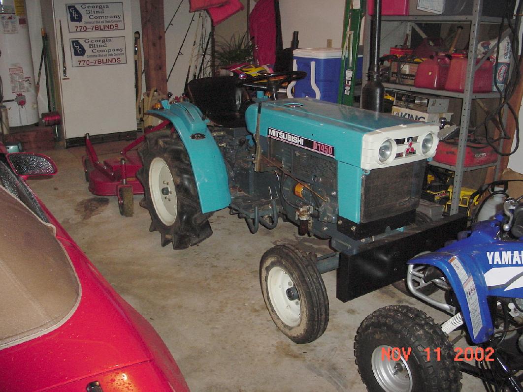

I didn't need that much weight. Went down to my local aircraft landing gear overhaul shop and he had some 2 x 8 laying around, made me a bumper including paint for $100. It weighs a little more than 100 lbs. Works great.
LOL! Now that is humorous. "Local aircraft landing gear overhaul shop".
Are they right next to NAPA? LOL!
The chunk of steel on there looks good.
