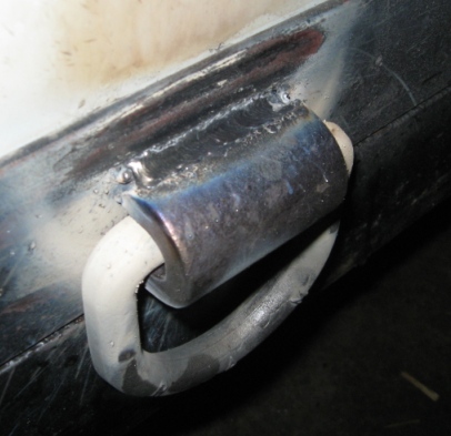

I was doing the same thing a while back, was thinking of going with the weld on D-Rings, actually the ring itself is not welded on, a short pc of angle iron that culp over the straight part of the ring that gets welded on, leaving the Ring able to move to position of the tie-down,

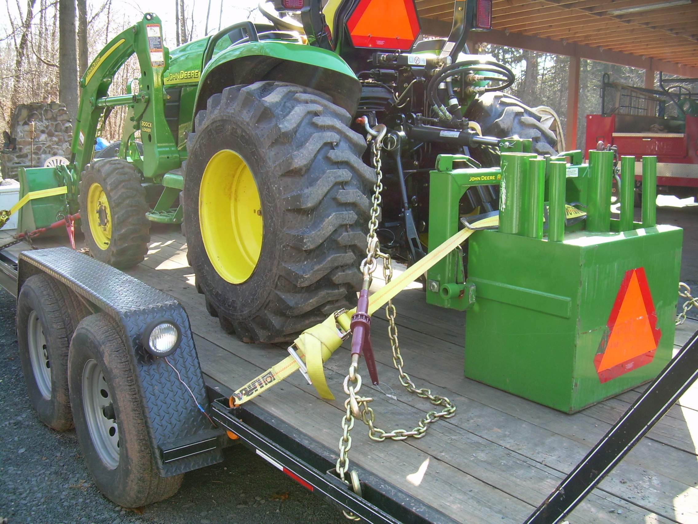

I vote for the weld on D-rings. I think I spent between $40 and $50 on ebay for 8 of them (I forget if they are 1/2 or 5/8), and I can't imagine anything working better for less money. As shown in the pictures, on each side I put two on the frame rail in front of the axles and one behind. The fourth was put on the top rail above the wheels (hidden in these pictures by the spilled mulch). The working load of these weld on's is 5K to 6K for each ring, which would take more than just a through bolt to get with deck mounted rings.

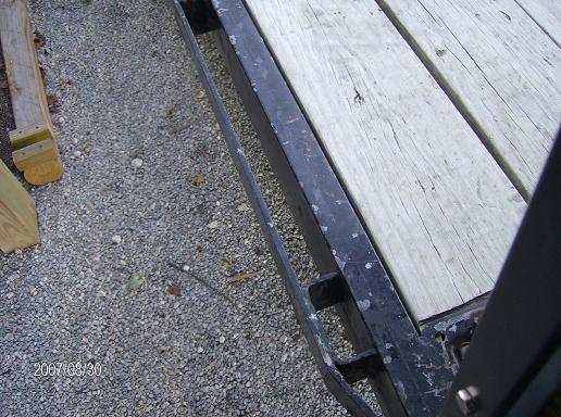

I have stake pockets, so I just use those.

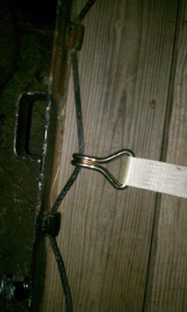

On one of my trailers I welded D rings in the area where the fenders are, then welded stake pockets and flatbar from the front of the fenders to front of trailer, same from rear of fenders to back of trailer...basically a tie down rail like you see on G/N and big truck flatbeds. if you go that route be sure to use 3/8"x3" flatbar, will not flex easy when using 2" ratchet straps and tightening down hard.
On my other trailer I came with the system I really like, I use 1/2" wire rope approx 22' long for my 20' trailer. I pressed a button every 12" on the cable, then I started at the front of the trailer on inside of frame, welded button.Then I used a piece of pipe laid under the cable and welded second button..giving enough slack in the cable to hook my tie down strap or chain to. I have a tie-down point every foot, the tie down point is flexible/durable enough to set a load ion if you have too, but rarely does that happen as the cable sticks out only a few inches from each side. For vehicle or heavy equipment I use the stake pockets I welded to the outside of the frame, but for ATV's and small stuff the cable works great. Have had that setup for several years now.
Here is a pic

On our 21' trailer we have stake pockets. Sometime I use them. The side of the trailer is of C-channel type stock and I can hook to the underside of this. I use this method to tie on heavy loads that I tie down with ratchet straps.

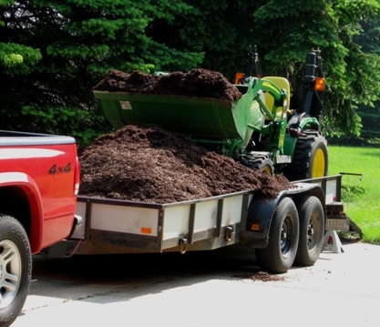

My 16' trailer has one weld-on D ring in front center & one on each back corner. Plus, I added a row of smaller bolt-on's down the center with a 5/4 decking board (for clearance) to tie down garden tractors. The outside has stake pockets with a 1/4" x 2" "rub-rail" so I can tie anywhere along the side in front of the fenders. The tread plate fenders also have a small d-ring in the center. ~~ grnspot
