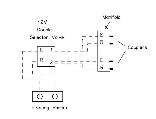

I am getting a new Kubota M5140 and it currently has 2 remotes on the rear. I want to add top and tilt and want a third to angle a rear blade. Instead of purchasing the third remote from Kubota, I think I can use a double selector valve and remove the couplings from one of the existing remotes and run hoses to the selector valve then from the 2 outputs of the selector valve to a manifold with 2 sets of couplings. I will machine the manifold from aluminum and there will be 4 straight through ports (really just a mounting block for the quick couplers although I will probably reduce the diameter in the block to serve as a reducer valve). Any idea what the diameter should be to reduce the flow for the TnT, was thinking .062? What say the experts is this idea ok? Anyone have a phone # for MtnViewRanch

Fasse makes an electrically controlled system similar to your drawing. Myself I would attach more valves with a PBY block rather than tie up existing remote outlets.
/ Adding Remotes will this work? #4
Take a look here, I do this all the time. $535 gets you everything to have those 3 rear remotes. :cool: The pictures on the website show a single OEM valve controlling 4 separate sets of remotes. :thumbsup:

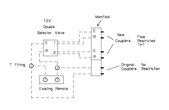

TxJim got me to thinkin, how am I tying up my existing remote by starting with 1 and ending up with two but my original drawing would be leaving one remote on the table. Here is my revised plan. I ordered SAE 8 15 GPM DOUBLE SELECTOR VALVE 12 VDC P15544-1 item number: 9-5117 from Surplus Center. When it is not powered both sets of ports are closed and these will be used for the top and tilt (no power, ports closed - no leak down). I will keep the factory couplings and T into them, when the selector valve is off the originals will function as normal giving me a total of 4 Sets of Remotes. The only downside I see to this is: If I have something connected to the 4th set and move either the top or tilt that connection will move, I need to find a cheap 12 VDC on/off valve for it. New Hydraulic Setup.JPG

You may discover that you don't need flow restrictors. That valve you chose rated 15 gpm only when both solenoids are shifted to allow flow through both circuits. The individual solenoid valves are only 7gpm. I know because I got one, had excess pressure losses at 12gpm, and upon checking with the cartridge manufacturer learned the facts.
/ Adding Remotes will this work? #9
I think that one would find that even 7GPM is a bit much for operating a top and tilt set slow and smooth, especially the side link. Flow restrictors are the way to go and even then the dia of the cylinder will make a difference with what size restrictor gets used. ;)
Just my :2cents:
