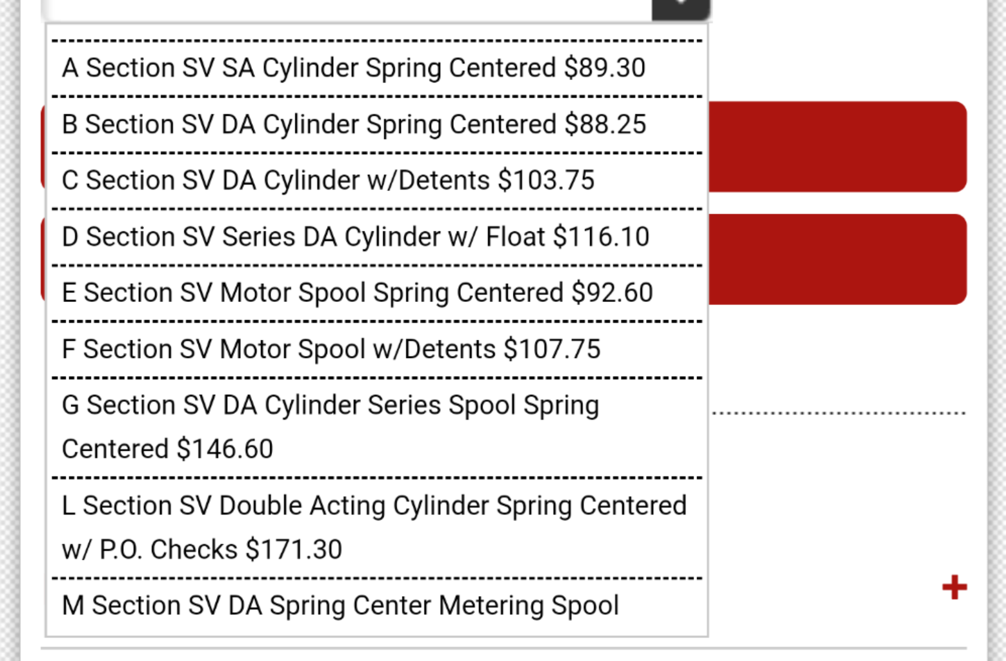

I've been studying this amazing write up. Thank you Piston great job, it's got me on the right track but I still have a few questions.
https:// QQQ.tractorbynet.com/forums/hydraulics/232020-how-i-added-rear-remote.html
Use your imagination on the links I posted to reconstruct them, i changed the w's to q's. I tried to post links and it failed because I haven't been an active enough forum member.
I currently have 0 remotes on my kubota l4240. I have 50 acres, 37 tillable that is all going to hay this year for me to bale myself. Last year I ran a couple hoses up to the curl function on the loader and that is how I lifted the gate on my 4x4 round baler and lifted the mower. I'm not doing that again.
So I only need 1 remote there. I also have a backblade with hydrolic angle that I bought 6-7 years ago because price was right. I've never used it yet, but I knew someday I'd have a tractor. Since this spring, now I have that tractor. Time to add remotes.
So, what is my need today?? 1 remote. What an I going to do? Install 5 :) I want top and tilt. That's two. I want to be capable of running a blade that does offset, angle, and tilt.....ya know, the works. That makes 5. Or maybe a box blade with hydrolic teeth and guide wheel. All the fun stuff I've been reading about in this forum. I could get by with 4, so my theory is go five.
I also have a backhoe. Kubota BH92. I've been studying and I realize that the hoses I have at the back of my tractor are in the power beyond loop. Those plug right into the backhoe and send PB fluid to that valve. Here's what I'm thinking. Go from those hoses as is (or Trace back and remove and run new) to the new 5 spool on the fender just like in Piston's install. From there, top and tilt is 2. I got three left.
This is where more questions start. T&T are both double acting float, I think. The other 3. Can one be backhoe/wood splitter capable. I need to size the current hose that is at the back of my tractor and make sure the new valve is same flow and will be sufficient to run backhoe. The thought there is a valve that I turn on and it stays on. I don't want to have to bungee. But I'm not sure what to call that valve. Then whatever I plug in there (correct me if I'm wrong) needs to have it's own open center valve because that remote it's acting like a power beyond just pushing that fluid?? So with everything I'm talking about (and whatever you guys wanna point out) how do I configure the 5 spools? There is single acting, double acting, float, detent, ect. Can float and detent be on the same one??? I think I've given a pretty good run down of how I would use the 5 spools. I'll try and post a picture of the configure options. Here's a link to the one I'm looking at.
https:// QQQ.surpluscenter.com/Hydraulics/Hydraulic-Valves/Sectional-Control-Valves/5-Spool-Prince-SV-Sectional-Control-Valve-Open-Center-w-Power-Beyond-9SV-5-Y.axd
I'd like to learn what all those valve options mean. I know some I won't need for the rear remotes but it would be nice to know even things like metering spool and motor spool because maybe it's possible I need something like that when I move on to the FEL 3rd function project. Is metering or motor what you need to run a skid steer power rake? I dunno. Not even sure I have enough hydro flow to run a power rake but definitely something I want to look into. I have a spot that needs to be raked and if I could rent a rake and use it, that'd be great. I know someday I'll have a grapple. I would also like to add cylinder for FEL attachment locking pins. So maybe I need third and 4th function FEL. Is what I'm talking about wanting a true FEL function? I dunno how all those terms apply just yet and I'm not even sure what skid steer type equipment I could run off the FEL. I just want a setup that allows me to push it to the limit and then slightly over. :laughing:
I also need to figure out if I should do the front and rear projects seperate or at the same time.
Ok, I think I've said enough. I tried to paint the entire picture and I appreciate whatever advice ya'll give me.
Attached is the picture. Hopefully someone can explain all these options.

Wow that’s a lot to digest! I would skip the valve you link and get something like this.
BUCHER - 21 GPM MANUAL DIRECTIONAL CONTROL STACK VALVES | Trausch Dynamics
You build the valve “stack” just like you want it. You can add the electric over hydraulic for your 3rd function to the stack or do it separate. Note I linked the 21gpm valves but you may want bigger valves.
Basically power beyond out of the loader control valve, into the stack and back into the case. If you added a separate third function valve it can be before or after your stack.
Scorpion makes the best joystick switch for you electric over hydraulic valve. The basic two button is all you need for the third function.
/ Adding rear remote and 3rd function FEL Kubota L4240 #3
You don't need float for top and tilt. It doesn't hurt, but the implements should handle it. What you're looking for in a valve to operate a backhoe is "detent". In addition to the usual springs that return the valve to center (off), there is a detent position like the float position on your loader. Except that rather than putting the valve in float, it keeps it on.
You should get valves with capacity more than your tractor's loader and accessory circuit (not both that and the steering circuit together as many manufacturers report). But not too much more or it will be difficult to feather the valves.
The electric over hydraulic stackable valves seem to be a lot more expensive than the standalone ones that plug into a DO3 subplate. For whatever that is worth.
The surpluscenter catalog is useful, and they're a good place to buy stuff from.

The 21 gpm valve is likely too larger. I suspect something in the 10 gpm range is more appropriate. A too large valve makes feathering controls difficult. Also, don't forget you need a valve with power beyond capability and the appropriate PB sleeve. To will also need a tank return line nad need to Tee into the existing tank return line under the right side of the tractor. I had to source a swivel Tee for that and then remove the existing Loader tank line which has a 90 degree end for one with a straight end.

A 10 GPM valve is enough. From a practical standpoint I think you will find a 12 GPM valve more common and that will work just fine as well. As stated, 21 is too much.
