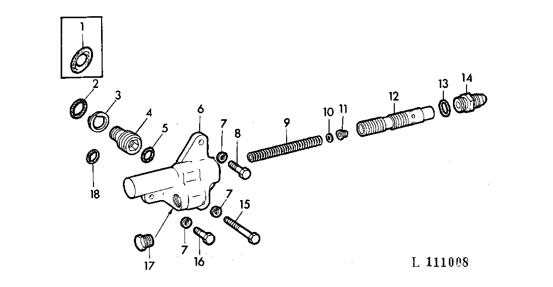

Remote valve for a JD 2020 must be a closed center type or have the capability of accepting a closed center plug(1st photo). One can attach a spool valve by attaching to rear of pressure control valve by removing plug(parts key 17) on lower RH side of tractor(if tractor has power steering). Hyd return oil from control valve should be routed to ported hyd filter cover(parts key 22) but for limited use can be returned to trans case. L55982 Cover - COVER ADD 61.18 USD

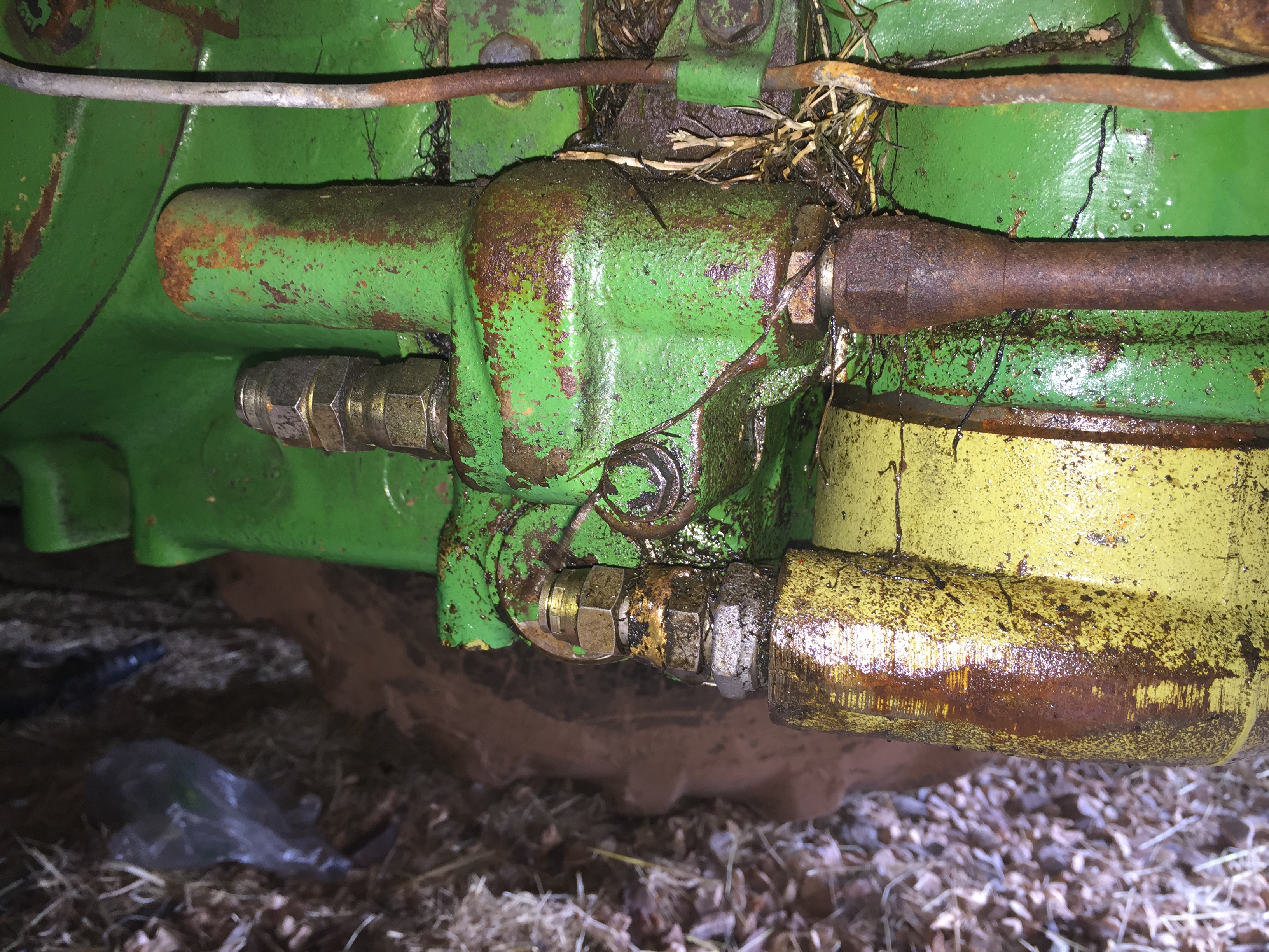

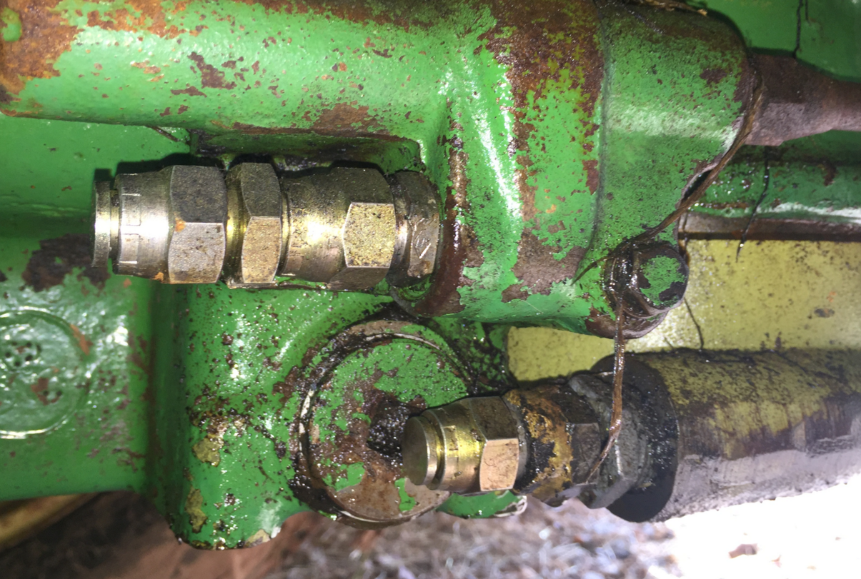

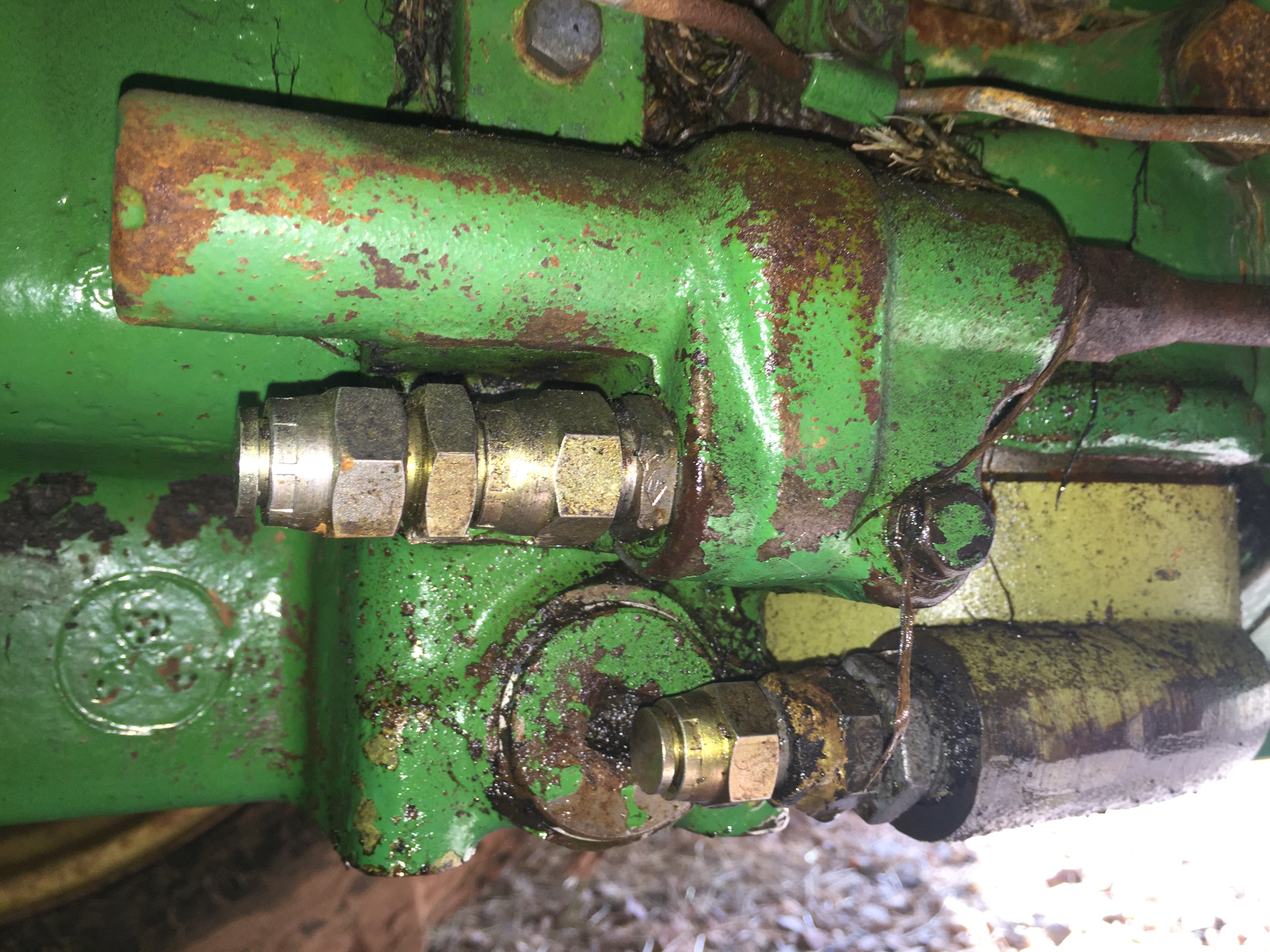

Thanks to Tx Jim for quick response. I think I understand. I have taken some photos from the tractor to confirm. I think flow from tractor to spool valve comes from top connection and return to bottom connection in the first and second photo. I also think your reference to limited use return to transmission case relates to the thirdphoto, which is located beneath the set on RHS. Have I got that right?? IMG_1618.JPGIMG_1619.JPGIMG_1620.JPGIMG_1618.JPGIMG_1619.JPGIMG_1620.JPG

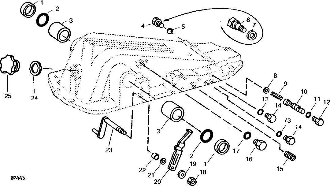

/ Adding rear hydraulics to JD2020 #7
You're good to go top fitting will provide pressure & bottom fitting is for return. You should remove & install correct plug(parts key 16) or plug that open fitting on the side of RS housing in your other photo
