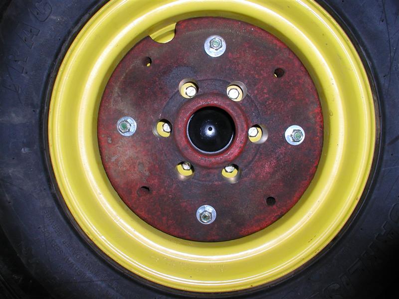

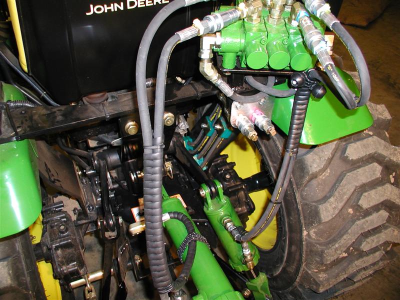

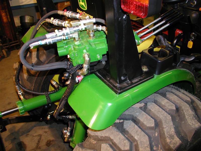

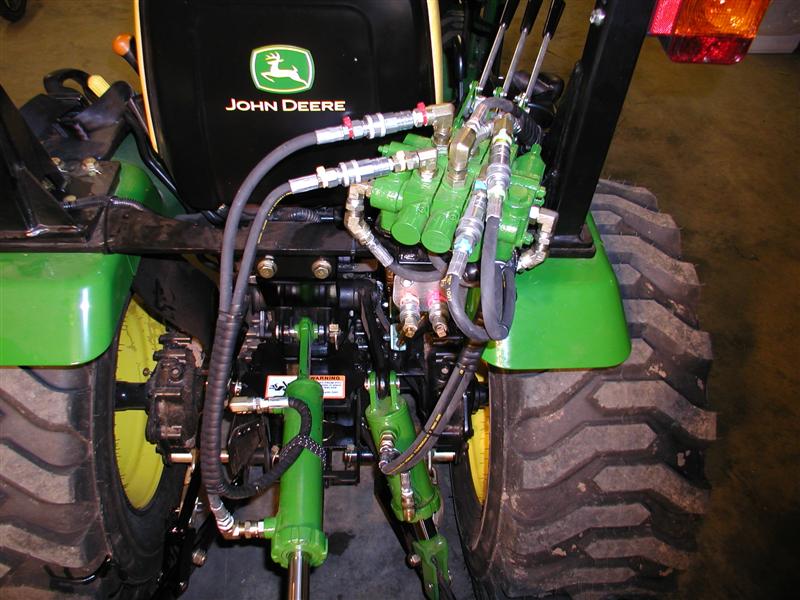

New photos are here. These show the final (unless I change it again) routing of the TnT hoses. And the last pic is a bonus, showing the result of several hours of machining effort on some wheel weights I was given.

To follow up and answer a question I have been asked a few times now, and just often enough so I forget between times, here is an update. The hydraulic block on your tractor has two ports, as you've seen in my earlier photos. When the block is mounted on the tractor, with the setscrew in place inside the block, and you are ready to plumb out to your aux valve:
The hydraulic supply from the tractor comes out of the rear-most port on the hydraulic block. This should be routed to the port of your auxillary valve called "in".
The return to the tractor hydraulics is the front port on the block. So, the flow from your auxillary valve, out of its "out" or "return" port, gets routed to the front port on the hydraulic block.
Doing this puts your new auxillary valve in series with all the other tractor hydraulics.
Good luck, and watch those "o"rings !
