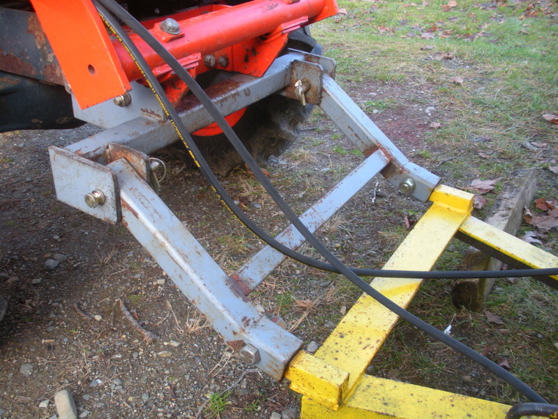

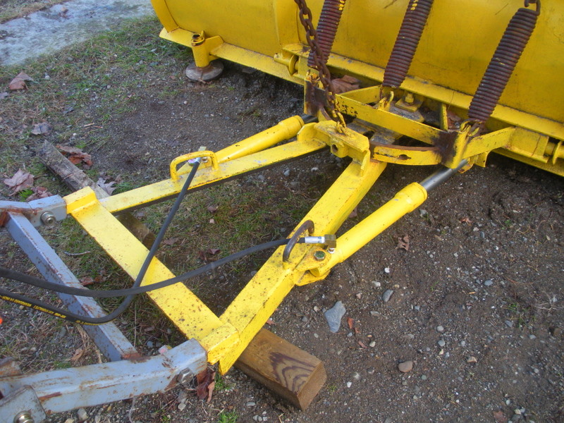

Man, this setup is so hokey I'm embarrassed to show it. But anyway, here it is. The plow frame had been modified by some previous owner, so I just extended it to the tractor and used a couple of pins for attachment and lift swivel. I had to make the setup the day before a big storm, so there wasn't a lot of engineering put into it. I figured I'd change it later - but it's still working, so I've never bothered.

Been using the plow for two years now. I figured "this thing isn't going to last", but it has. That very first storm was a foot of wet, heavy snow, and the rig handled it just fine. I'm more surprised than most. It's also nice that the plow can be raised quite high to push the tops of snowbanks back.
