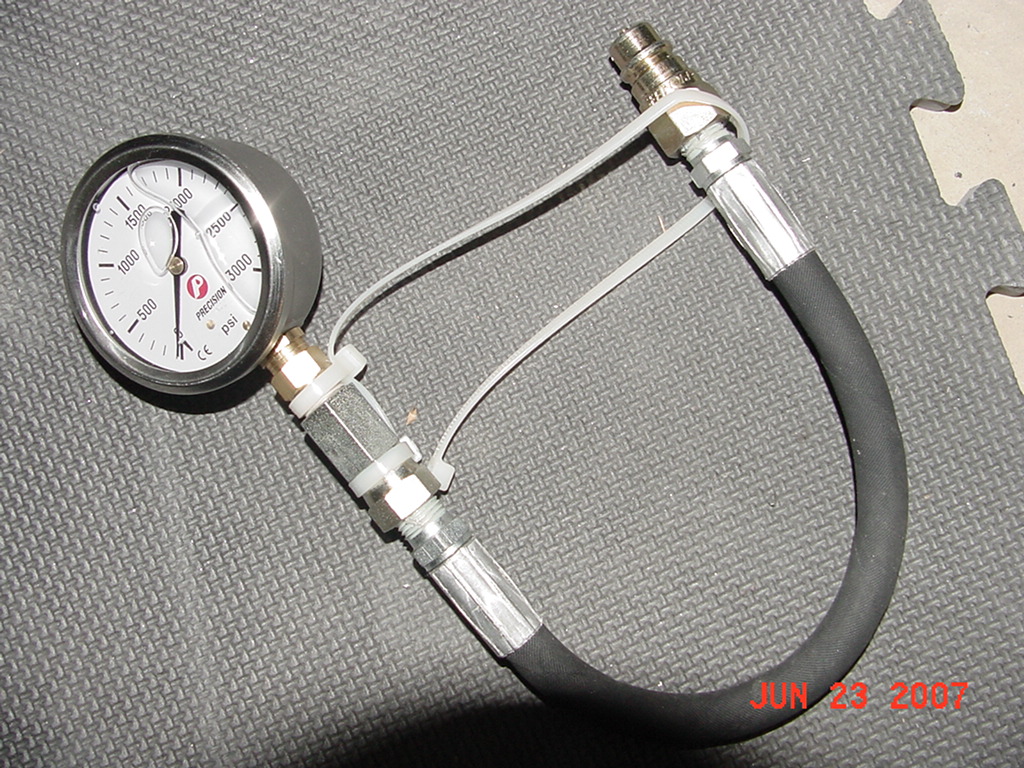

If you have QD's, plug the gage in one of them. That will deadhead the hose when you activate the lever, so only do it momentarily.
A permanent place would be in a tee at the IN port to the FEL valve.

Although you have had the cyl checked and rebuilt, wdchyd, has pointed out to me that if the cyl are not fully pressure tested after the rebuild, there is no guarantee that just because new seals were installed that the cyl is certified good.
It would be nice to see something like this on rebuilt hyd products. Tested to xxxx psi for 10 min, no significant leakage.
It is a good possibility the problem is in the FEL relief valve assembly.
