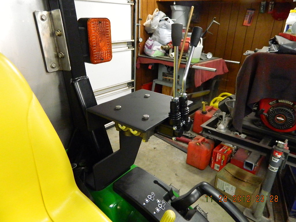

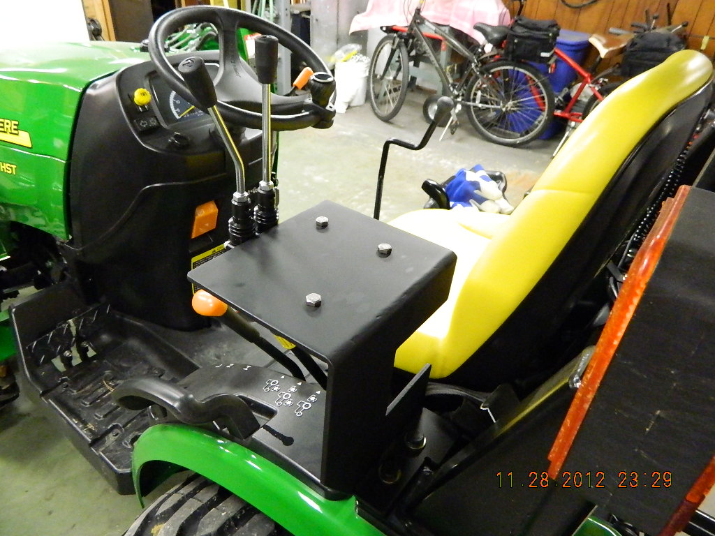

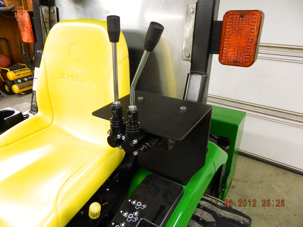

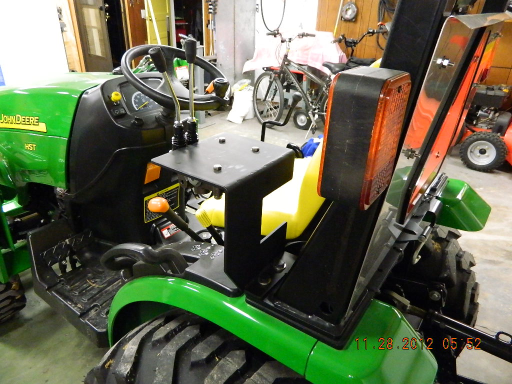

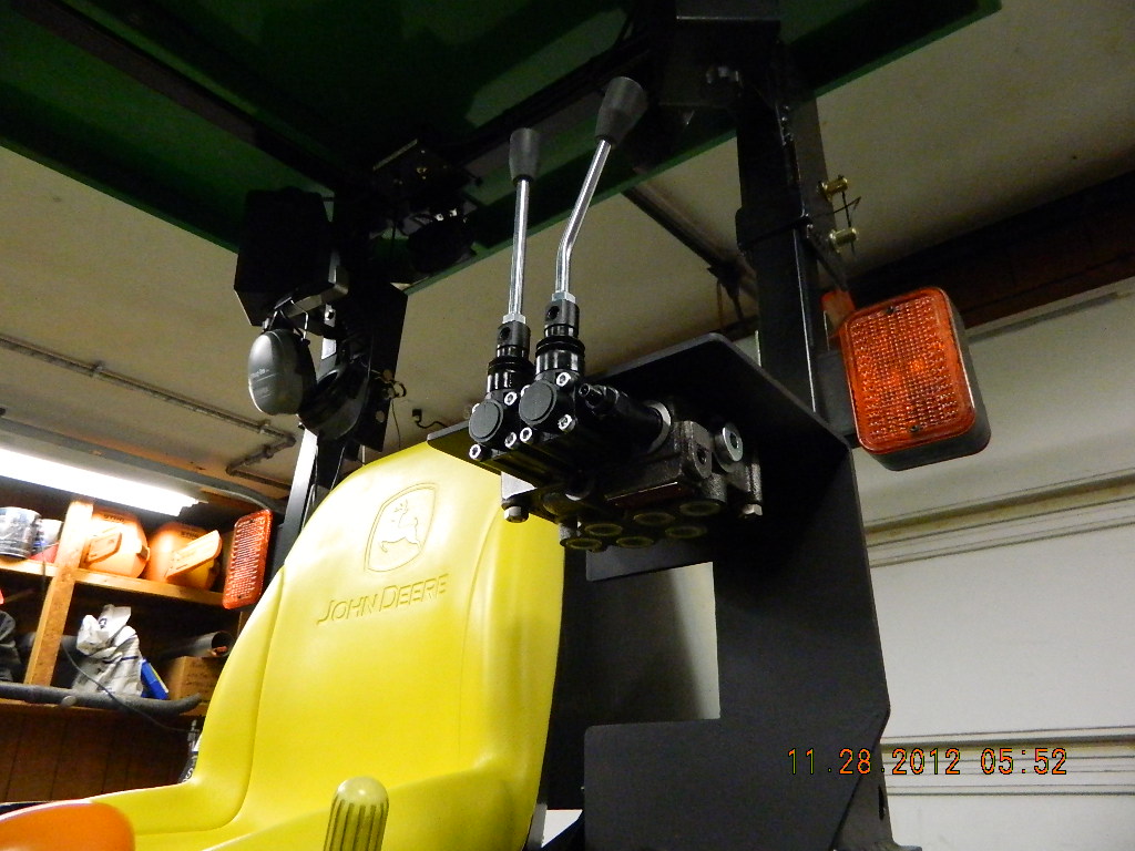

!!! Could it REALLY take all this stuff to get the job done ??? Actually, some of it is in a drawer yet, not in the picture.
Nice work
Looks like you ordered SAE6 ORB to 3/8" NPTF 90's for the remote supply and return hoses and reduced them down to 1/4" for the hose?
I was thinking that all of the lines were 3/8" and those would be also.
My 2320 list's a differen't plug. (15H558 Pipe Plug | 1/8in. )
I guess i'll order that from the dealer, it is most likely straight thread and not NPT.
I appreciate the link. I see now what to do and that I will have to remove the original svc and see how you made a bracket for the front quick connects.
I planned on ordering everything from surplus center.
I need to measure up hose lengths, I was going to use 3/8" hose.
your thought on that?

Yes, 3/8" is a better choice than the 1/4" I had at the time. Reduced flexibility is the only downside to the 3/8".
