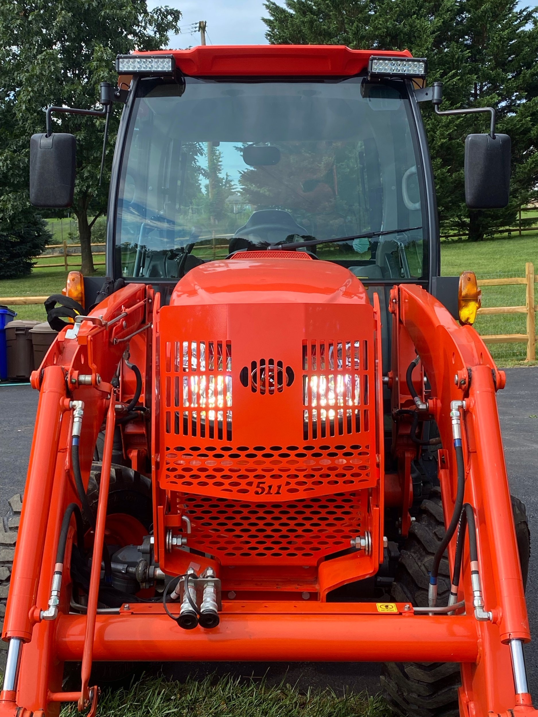

The intended after dark usage of the tractor would affect the mounting locations of the lights. If you have a loader or front snow plow, the grille wouldn't be my first choice. ROPS (and front of cab) mounted lights for loader and snowplowing were OK, but were less than desirable for mowing. For mowing, the higher-mounted LED lights, although VERY bright*, lack the definition that my old halogens had. There's a pair of LEDs in my grille for mowing. The light from them rakes out over the grass making it easier to see the cut/uncut line.
With the ROPS I had glare from the lights shining on the backs of my eyeglasses. They made the hood too bright and that interfered with seeing out in front.
* Floods are best, but regardless of the chosen pattern, LEDs are annoyingly bright to anyone who isn't on the tractor. You can blind zombies a mile away:)

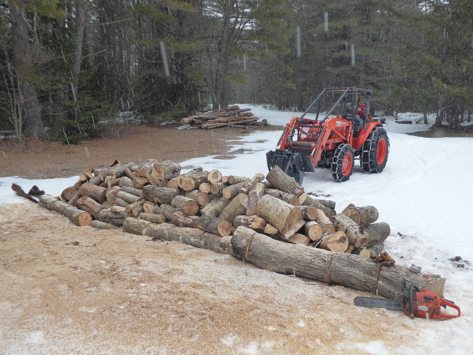

You have a lot of experience with light placement and I don't so a question. I am thinking of getting some LED lights for snow plowing. Most of my night time plowing is limited to times when I have to keep up with a big storm and it is snowing. I know what it is like using high beams during a storm and all you can see is big flakes coming at you. I am wondering where you think the best mounting place would be on my tractor for plowing during a storm at night. Just picture a plow on it instead of a grapple. I am lucky in that I can put them most any height out in front of me. Thanks.

Gordon, it would tempt me to mount a pair of floods on either the front of the canopy or the top of that mesh grille guard. The best coverage might actually be pointing them a bit "cross-eyed" to minimize some possible blocking by the loader frame. It looks like that would put them almost 3 feet higher than the top of your plow?
My earlier statement regarding the grille guard not being my first choice was directed towards grille guard mounting that might end up with the added lights being lower than the factory headlights and hitting the back of the plow.

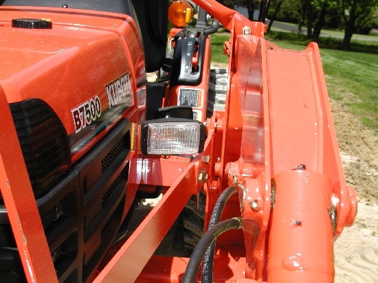

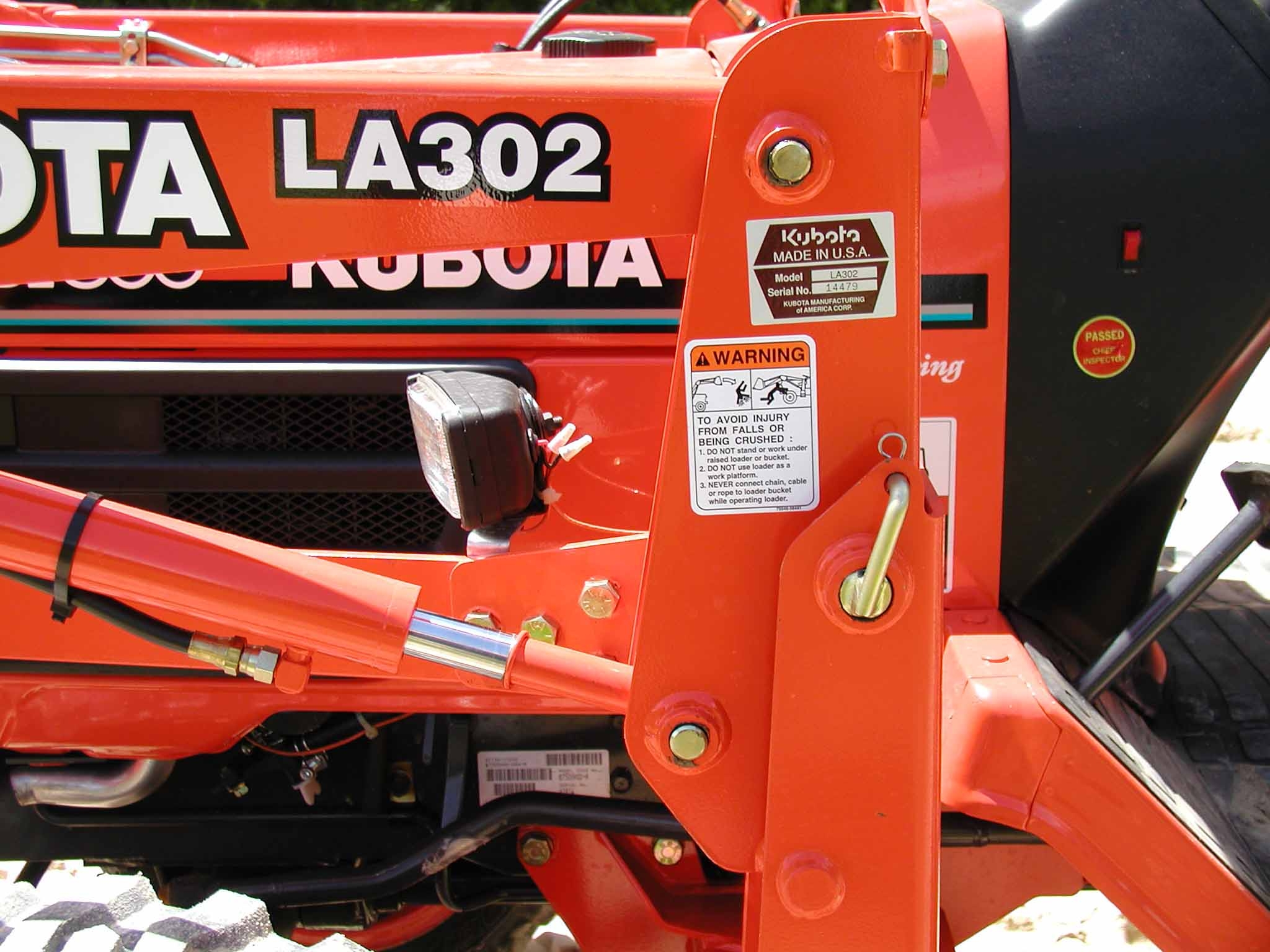

Sometimes things work out better than they should. The pics below are the added lights on the B7500 around 2010. They were mounted between the hood and the loader frame and lower than the headlights. They worked remarkably well year round. You can see that when the loader was at a certain height they hit the back of the bucket. The main reason for adding them was for mowing. The factory headlights were the typical worthless variety. These were old school Tractor Supply halogen floods. The spread was such that two of them gave a nearly 180° of lighting in front of the tractor.

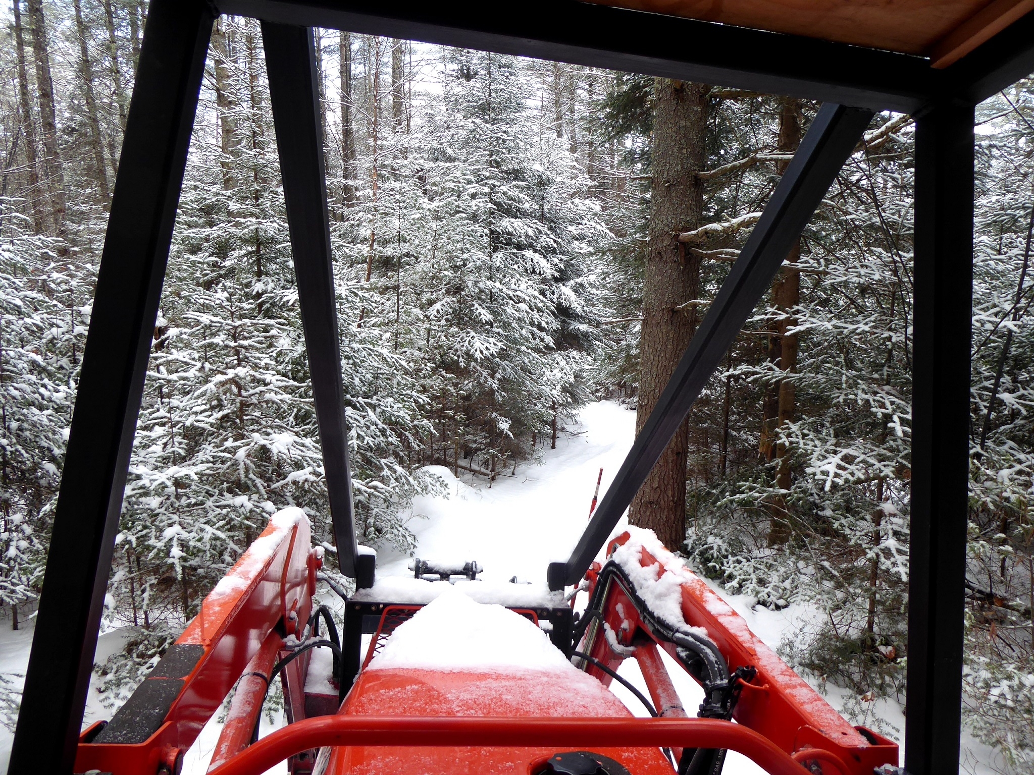

Thanks chim and RjC.., I will go with what you and others have said and try the top of the canopy. Less clutter in my already cluttered view. My question came from plowing with my p/u in a storm where low beams were much better than high. Maybe the light being angled down makes the difference. View from the seat

The view from the seat does seem to be a bit busy :)
Around here we rarely get storms that drop feet of snow, so there's no rush to "keep ahead" of the snowfall. Most of the time I don't go plow till the storm is subsiding.
