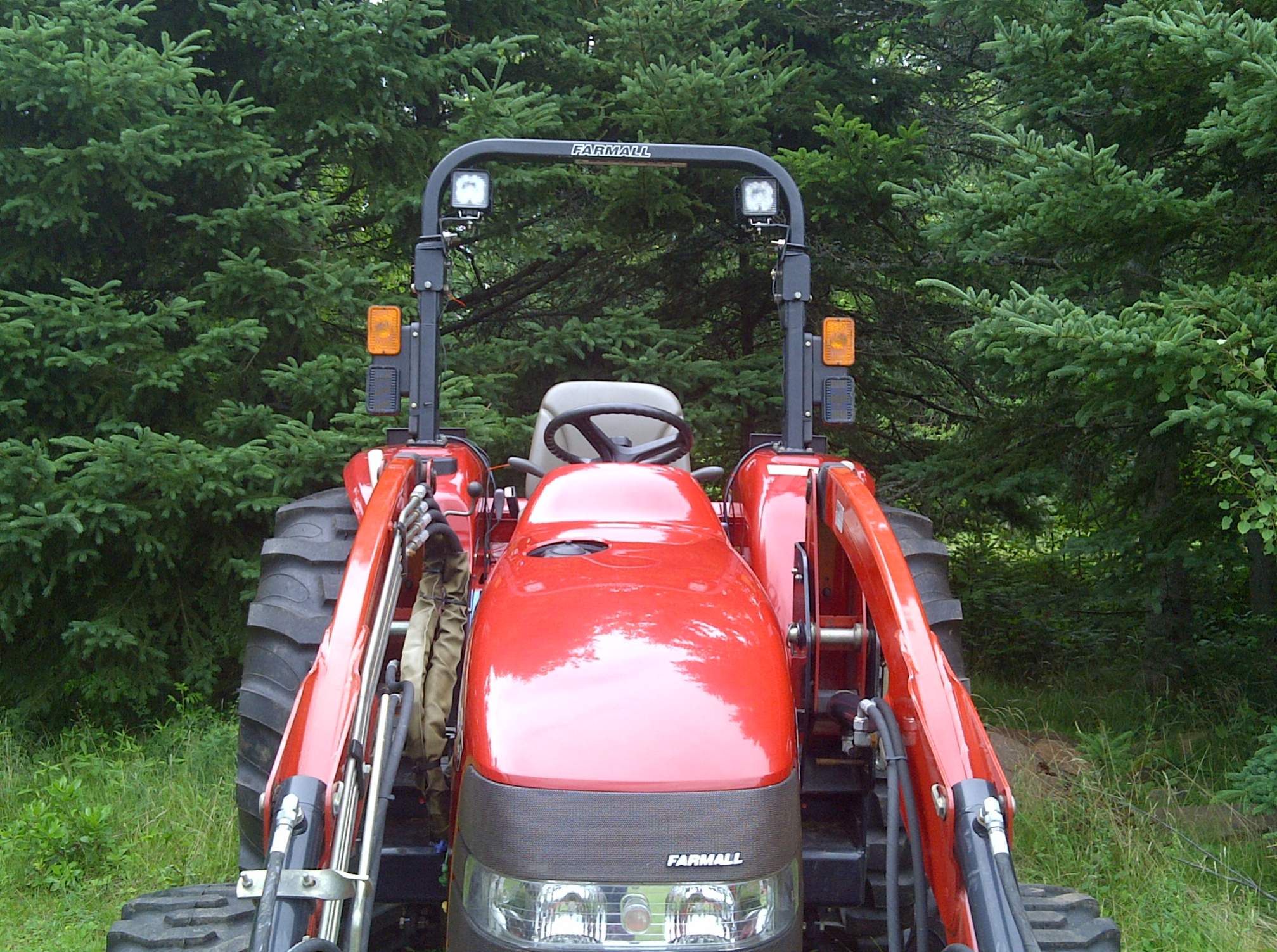

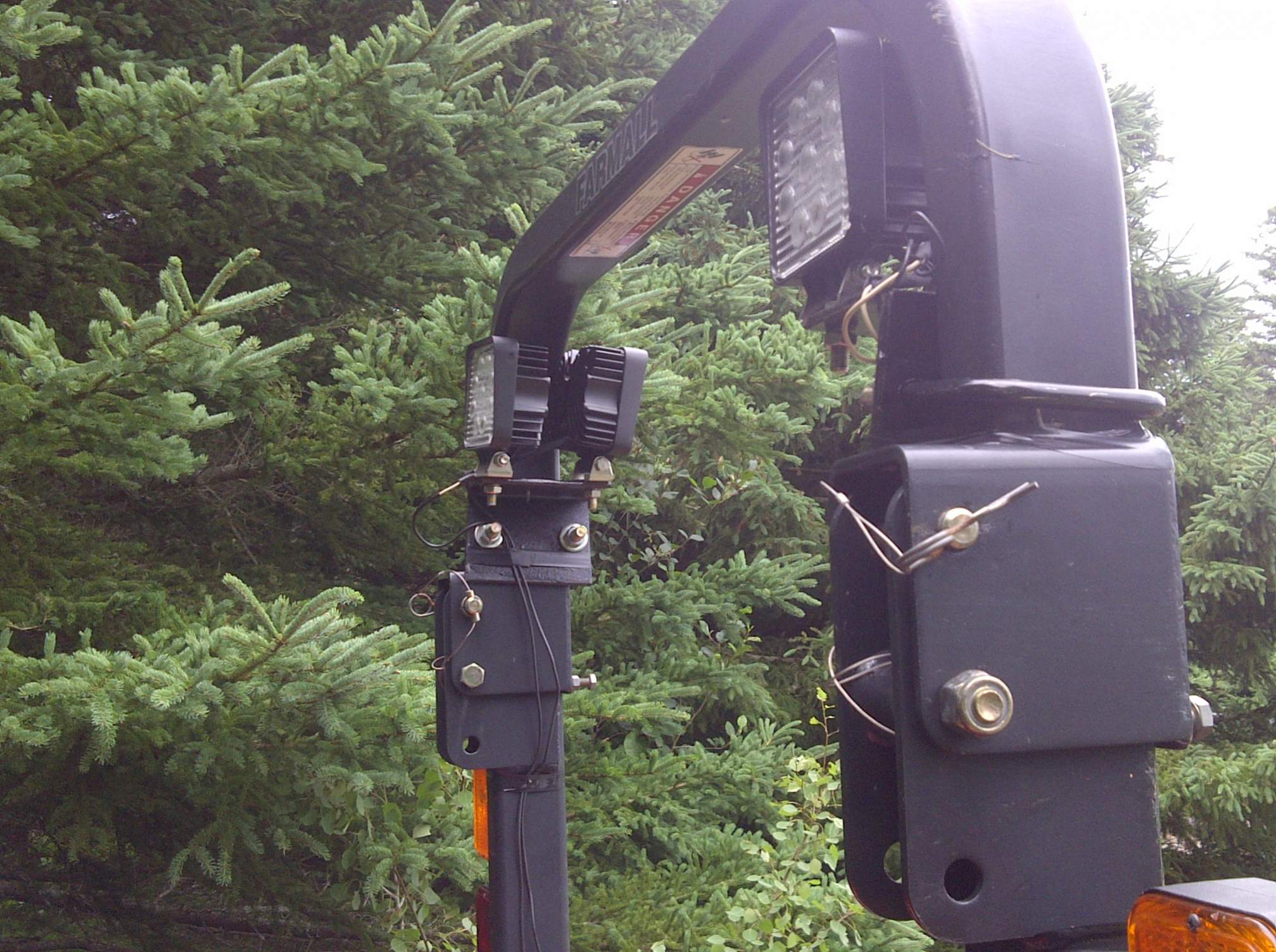

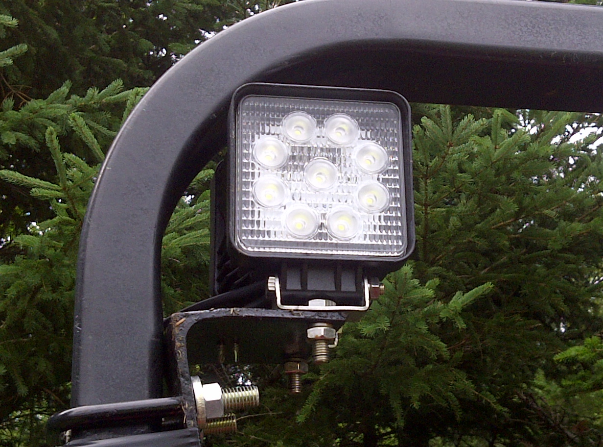

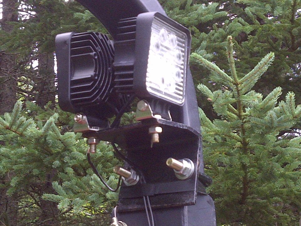

Night pic to show the illumination will be posted tonight

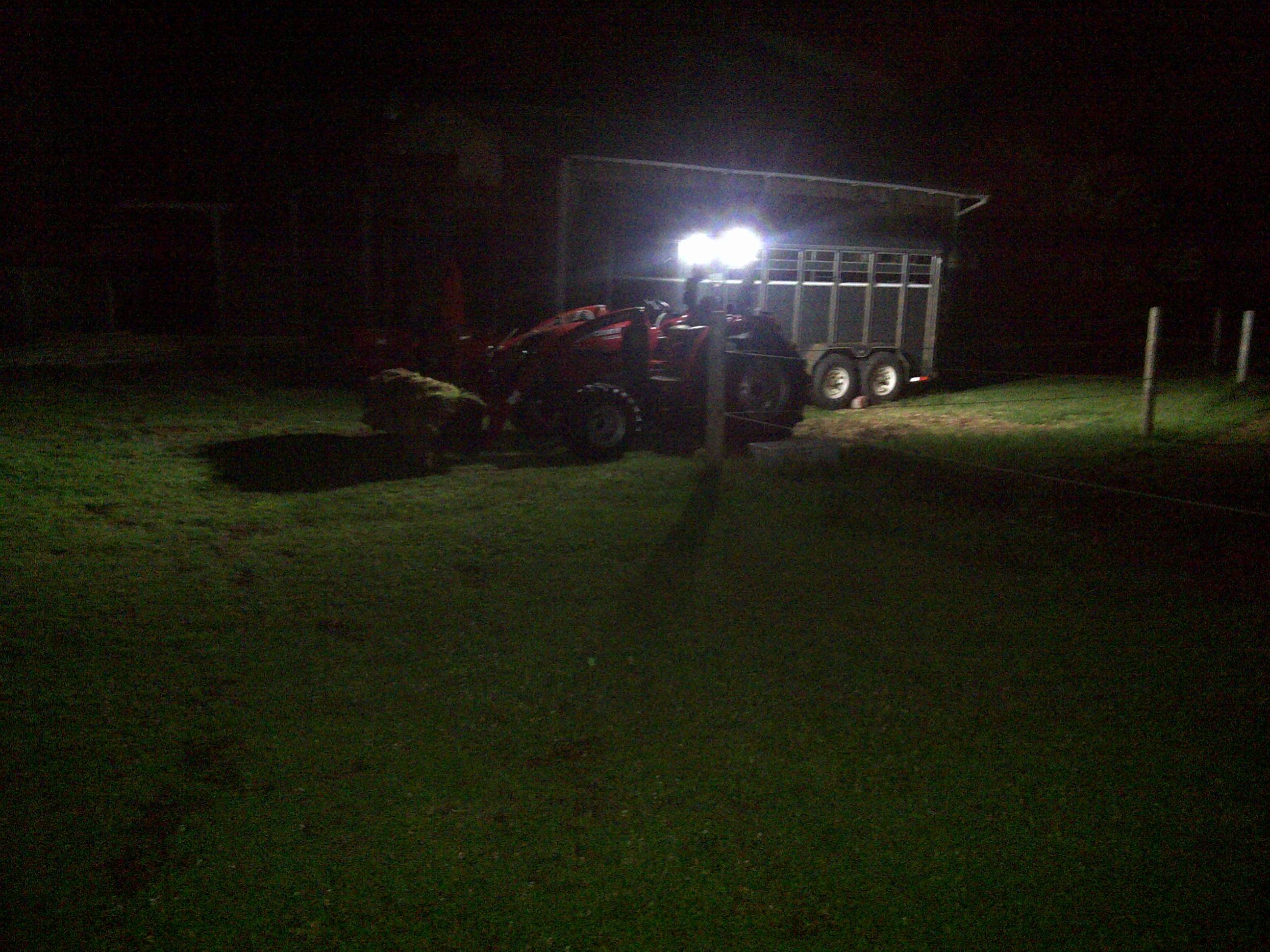

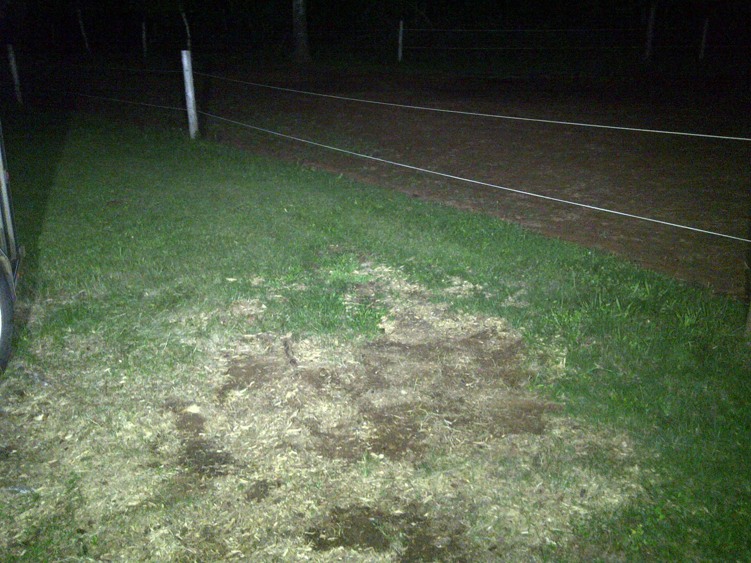

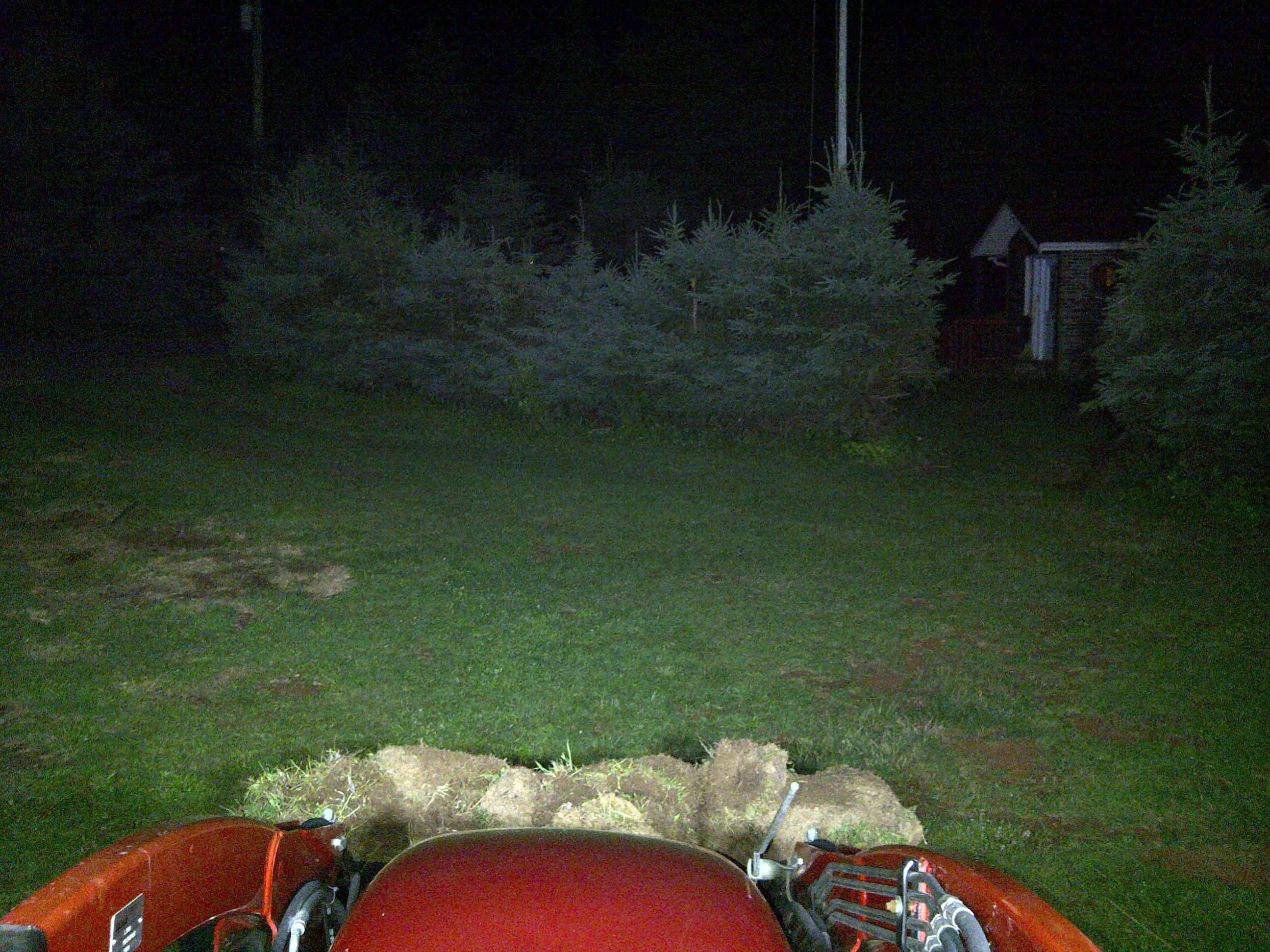

/ Adding LED lights to ROPS #12
First pic is from the front
second pic is from the rear
third and fourth are from a distance, now it is complete darkness and there is no other light around. I am not using a flash, these lights are bright.

/ Adding LED lights to ROPS #13
That is really bright. Those are some great lights.

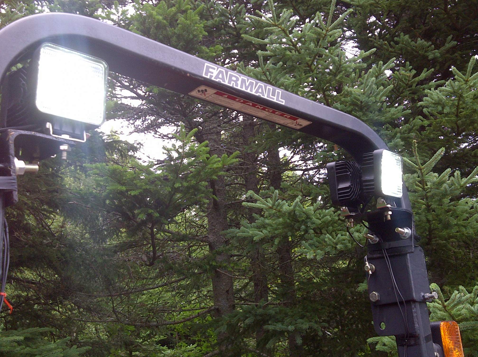

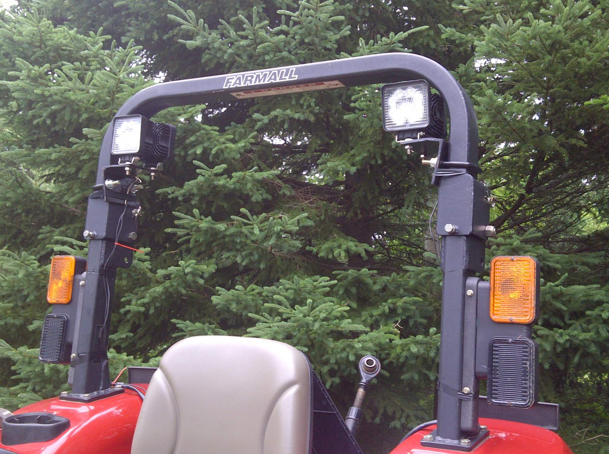

Those look great....and it looks like it throws some serious light.
I contacted your ebay guy and he quoted me $250 for four of the 24 watts lights....I countered at $150.....Can you tell me how you got him to that price? did the $160 include shipping?
Also...these look pretty rugged. I will have to mount mine on top of the ROPS so they will be more exposed to branches and such then yours. Are they built tough?

I just low balled him at $160 and he went for it. he wanted $250 for four of them and I told him not a chance, if he gave me a good price and I like the lights that I would be ordering more. Shipping was extra but it was very fast as I ordered something from OK, and these lights came from Australia and the lights arrived before the package from OK,USA.
They are fairly rugged, I was bush mowing a field with lots of spruce trees in spots and the branches were hitting them and no problem. I know it is not a lot of impact but when I drive on the road to get to another field the road is full of pot holes and they smacked together a couple of times before I tightened the mounts up and they did not crack.
In the pictures the rear lights I have pointed down and they shine on the equipment that I have behind me rather than shine straight out. But as I mentioned I have to block the driver inside of the lights as they shine in your eyes when you turn around to check your implements.
I will post some pics of how I fixed this problem later today.
