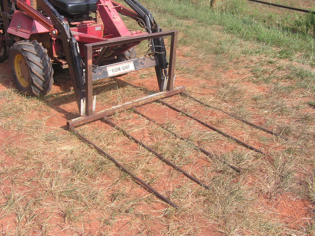

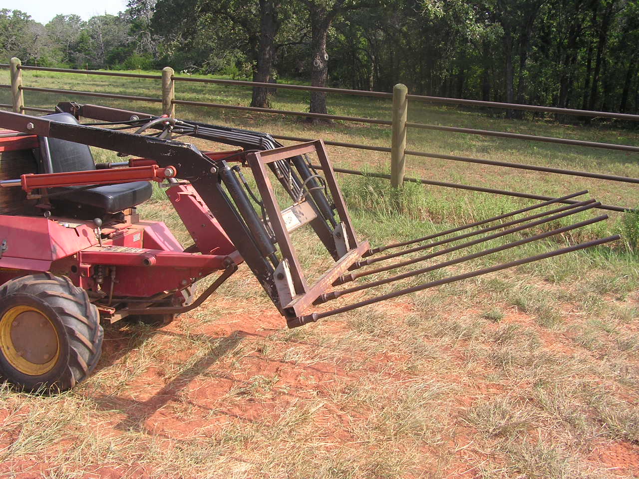

Looks gooder-un. :thumbsup:
Now you can build a brush fork for it. :D
