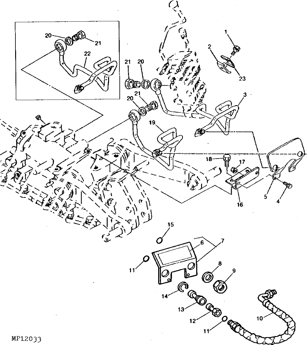

Terry,
The easiest way to get it set up to to try to find the Power Beyond/Rear Auxiliary kit for your machine. With this you can plumb in a new joystick valve to operate the TnT cylinders. The part number should be BM18010. Because of the banjo type fittings used on the tractor, getting hoses made locally may be very difficult-thats I why I am suggesting the kit as a good place to start.
Also, you need to figure out if it worth it money wise to you, this will not be a inexpensive upgrade:
PB kit>$250 or so
Joystick Valve>$200
TnT Cylinders>$300-$400
Hoses, fittings, misc.>$200-$300

Terry,
PB kit>$250 or so
Joystick Valve>$200

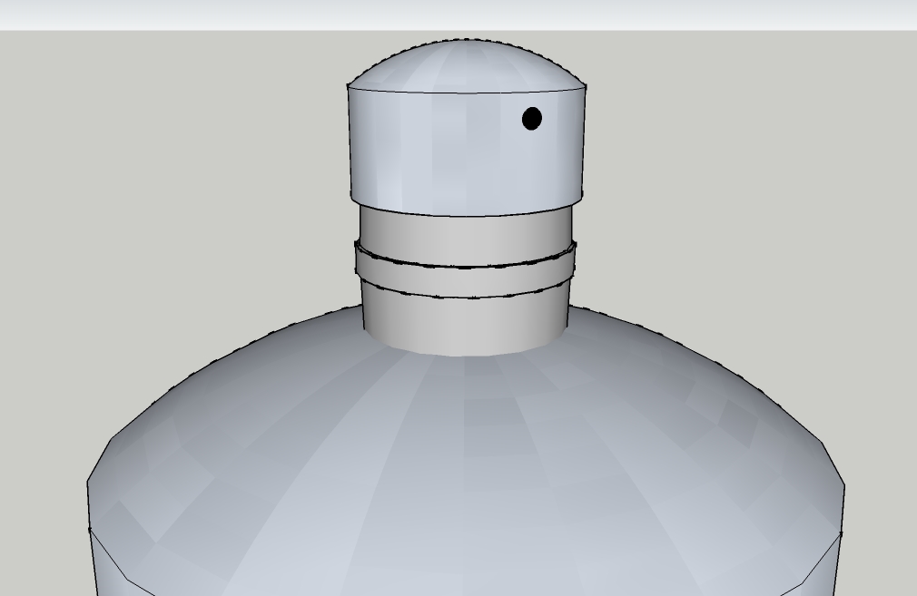

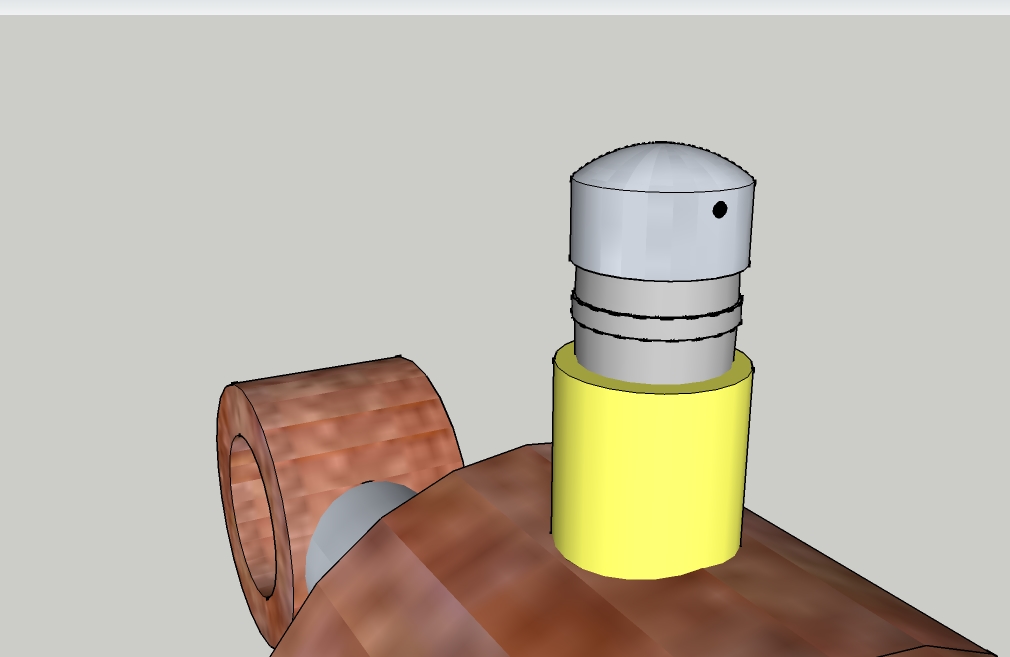

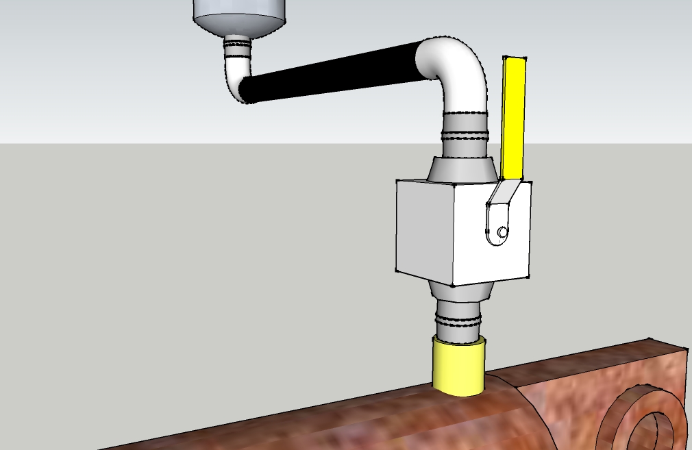

Since a splitter is a long-term dream, and I really NEED to be able to adjust my box-blade and forks a little more easily, my needs are quite minimal.
After scouting all the "Toplink" threads, I would like ask you and the rest of the sages for comments on the attached design for a Manual Hydraulic Toplink...
I have a first class junque-yard nearby with a nice selection of cylinders and valves, some VERY heavy duty , and at popular prices too...
Design Considerations:
  • This is a single acting design utilizing a "cylinder of opportunity" with the appropriate diameter, length and end fittings controlled by a 5000psi ball valve...you can "feather" the flow or dump the load as you choose.
  • A pipe plug filter / breather is installed on the rod end to convert the cylinder to single action.
  • I chose to place the oil on the topside of the cylinder in expectation of shock loading from the box-blade or other ground engaging implements hitting roots or rocks. It is my understanding that in single action cylinders, putting an oil column into compression is more desirable than creating a vacuum during shock loading.
  • Low pressure hydraulic return hose leads to the bottom of a non-pressurized reservoir constructed of 2" galvanized pipe and pipe caps. Reservoir size is dependent on a volume of 125% the expected extended volume of the cylinder.
  • The reservoir will be "U" bolted to the ROP frame above the level of the valve.
  • The caps will be drilled and threaded to accept NPT fittings, JIC hose at the bottom and a pipe cap drilled as a filler / breather at the top.
So what do all you "hydro-sages" think?

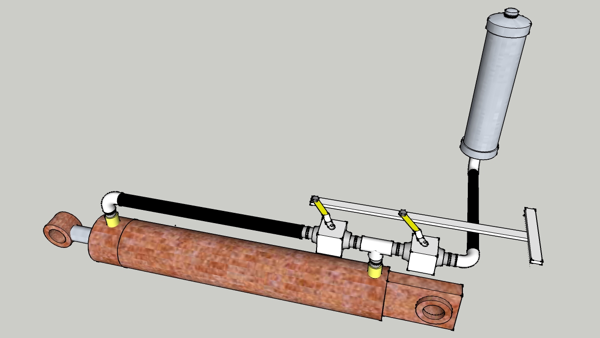

Your thinking is close, maybe if you hooked the 2 ports together with a valve in the middle, and with an additional valve on one side or the other teed to the reservoir. Bleed all the air out, then the cylinder would be solid, and you would not have to deal with a low pressure condition drawing air in past the rings on the piston. I haven't masterd computer drawing, so I hope you can envision it.

Harold-
Excellent!
Your suggestions satisfy several of the shortcomings in my design...with oil on both sides of the piston, closing the two valves will lock the ram up tightly...This also addresses the issues raised due to the smaller volume of the rod side of the cylinder and giving me use of the full length of the ram.
A much smaller reservoir would be needed now as well...with the bulk of the oil cycling from one side of the piston to the other...and any air that may enter the system will naturally gravitate to the reservoir
When I sketched this up, I also noted that it would be easy to "gang" the valve handles, and also extend them....making it even more convenient to reach this gizmo from the drivers seat...
Thanks for your ideas! I can't wait to get home and give this a try....
