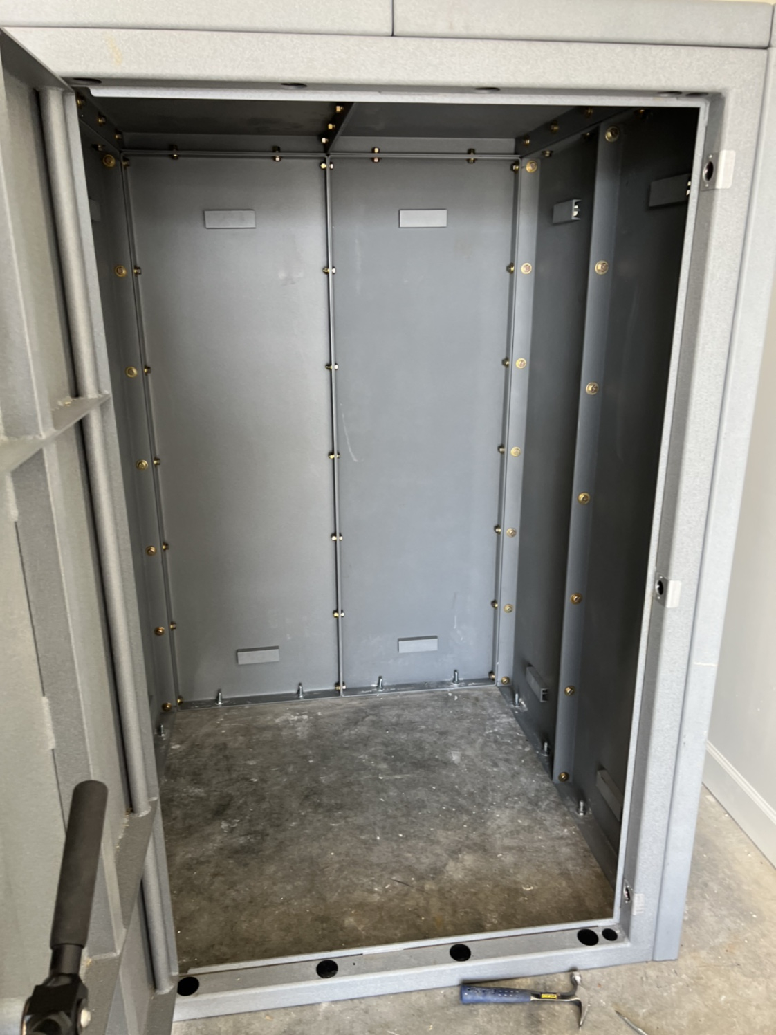

I put this together for a customer a while back. It eats up garage space but I like the design a lot better than the below ground ones. It’s also capable of being taken apart from the inside if debris are blocking the door.

I put this together for a customer a while back. It eats up garage space but I like the design a lot better than the below ground ones. It’s also capable of being taken apart from the inside if debris are blocking the door.View attachment 776004View attachment 776005

It’s pretty similar in construction besides the lack of insulation for fire resistance.
Doesn't look like there's a lot of ventilation. How deep do those bolts go that anchor it to the floor? I'd imagine a strong enough twister would pull them right out.
How long is it from when you need to take shelter to when it's safe to come back out?
That piece of channel iron at the top and bottom of each panel is a vent. That shelter is pretty heavy compared to its wind profile to start with and there’s 16 1/2 inch diameter 5” long bolts securing it to the slab. Obviously nothing is completely indestructible but I don’t think that any realistic storm would hurt that. A tornado doesn’t last very long. They usually pass in just a few minutes. But even with a decent buffer before hand I don’t think you’d sit in there for more than half an hour.
