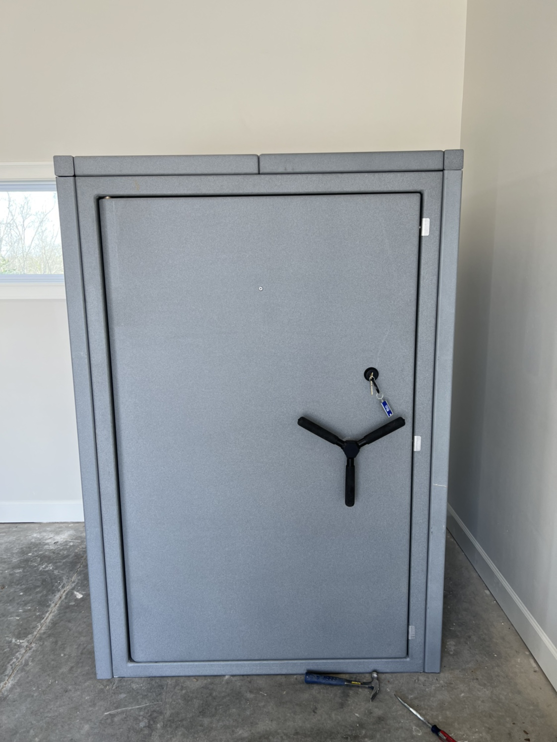

They delivered and set the storm shelter today. 15,000lbs! It took about 45 minutes, from the time he pulled in the drive, dropped the outriggers, hoisted the shelter, set it in the hole, lifted the outriggers and was gone.

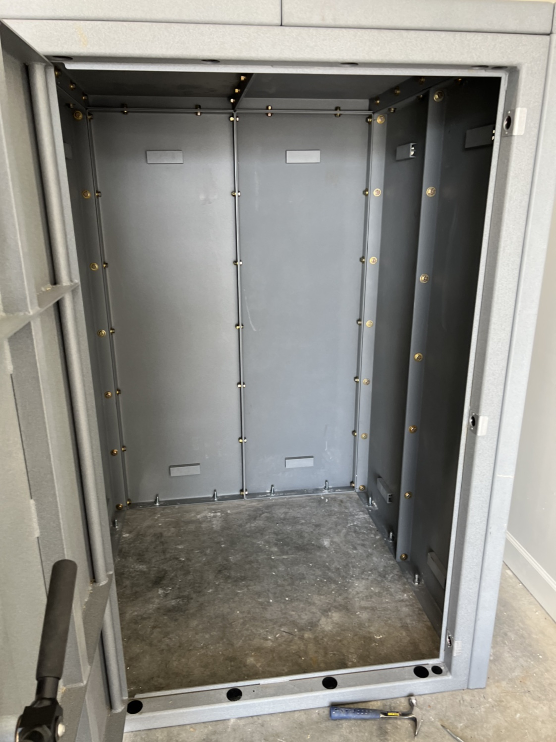

I really like it. It's pretty roomy inside, roomier then you'd think. I'll probably build a bench to sit on or put a couple of fold up chairs in there.
I'll also put in a solar light. The sloped door side faces south and there's a hole for conduit on the right side. I'll fasten a solar panel on the slope and route it to an inside ammo can battery box that will house a 12v deer feeder battery, 12VDC light and hand switch that you can reach when you open the door.

I thought you could remove the hinges too and make the door open inward, but that's not the case. The door locking mechanism is removable from the inside, so you can't get locked in. Sort of like the emergency escape for car trunks.
The photo makes it look small, but it's fairly large. I'm 5'- 11" and I can stand up with a few inches to spare and you could probably fit 5-7 people.
