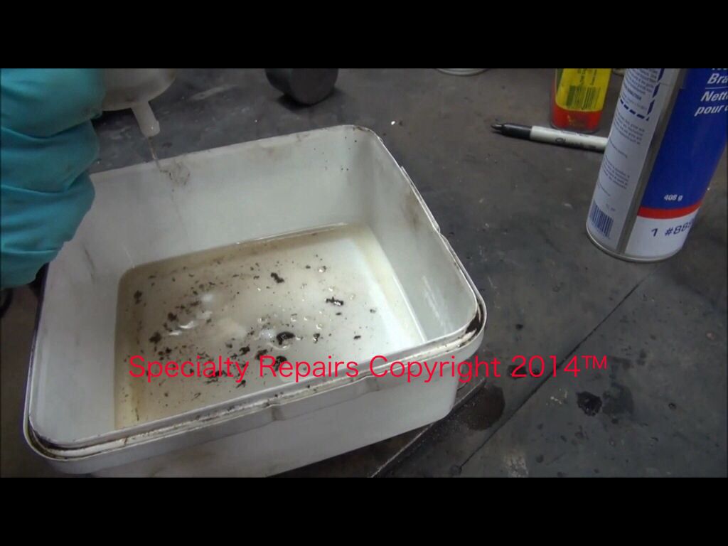

Every fuel pump I've ever pulled out of a vehicle had at least a fuel pump strainer before the pump. The added hose I used to run from the tank to the fuel filter added up to about 2.5 feet and my cost on that would be around $2.00. The photo I attached is the crap that came out of the filter on my BX at 70 hours. Imagine that stuff going through your pump.
I bet you won't replace your pump for $2.00 Then there's the down time on your tractor because of it. They usually don't brake down in the shop either ;)

Want kind of pump do they have and is it vunerable to debris? I don't know the answer to that question, I'm just asking. You guys keep this up I may be adding some more fuel line to mine to make it before the pump. I cut my filters open a couple of times and didn't get anywhere near that amount out of mine. I wonder what all that stuff is? I've wondered if mine isn't a problem with the sending unit starting to rust.
