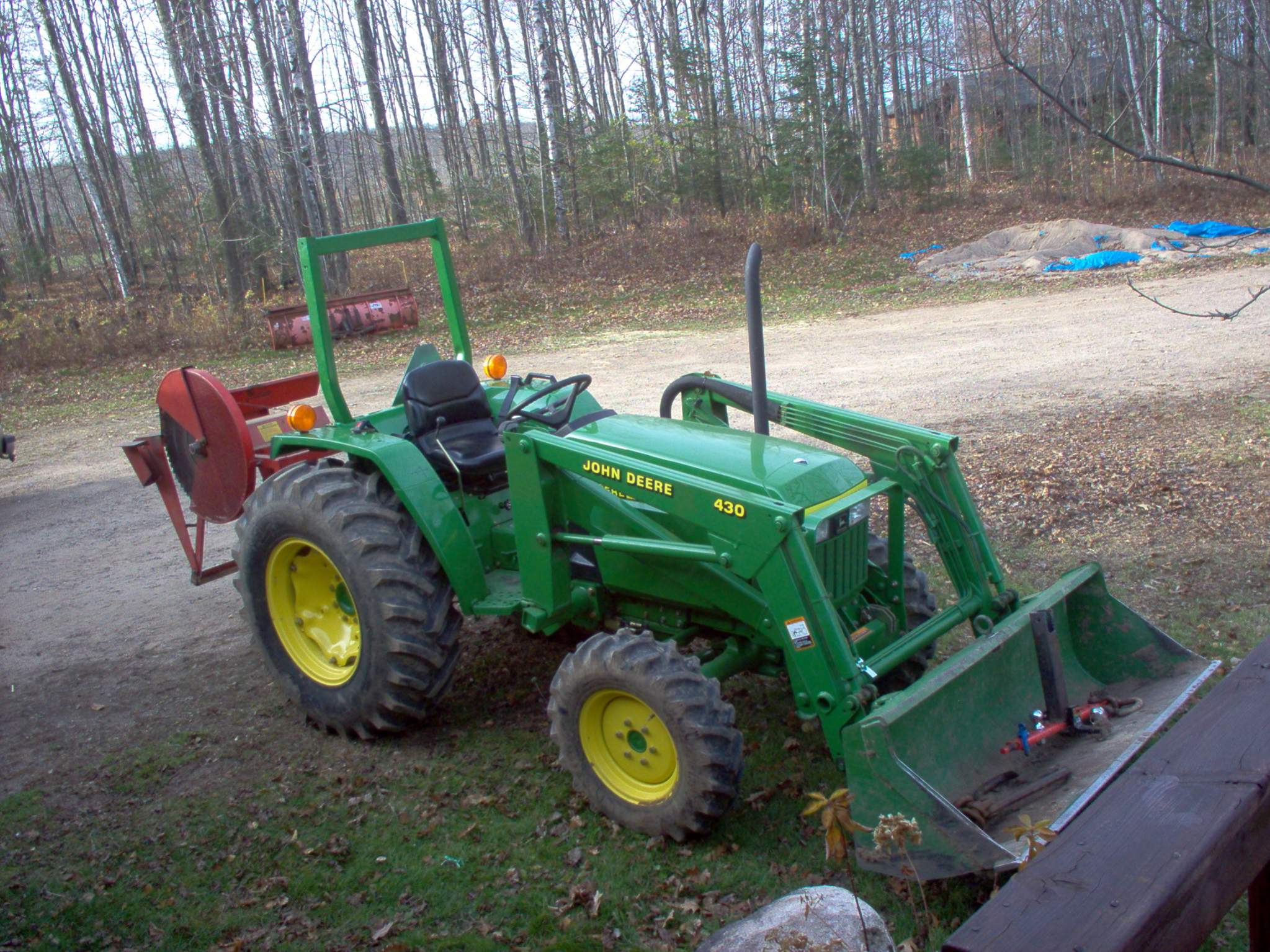

I am stuck with a snow plow issue! I have a blade off of my old truck RIP. Anyway it is going on my FEL. I have two options one is to dtach my curl to do left an right on the plow. There other is to add a 3rd control. I like idea number two best incase I ever want to add a brush grapple or somthing. here is the problem! I dont know how to add a third to my JD 990. Any ideas?

I am no expert in hydraulics by any means, but from reading alot of posts here on TBN, its my understanding that plows tends to come with single acting cylinders and your curl cylinder is double acting. you would need to add a bypass connector to allow the fluids be returned to tractor. You would be better off replacing the single to double acting ram. Since you want to add a grapple , i am sure it will have a double acting ram on it as well. So no matter which way you go , you probably will need to think everything has to be double acting on your tractor. Maybe a fellow TBN'er might disagree and have a better approach. :D I'm always ready to learn more too.;)
/ Adding a 3rd control for the FEL
Never thought of it like that! I figured make the plow go right the other cylinder would follow! There are only two hoses on the plow. One for each cylinder.

Two SA cylinders will work fine in this situation, there is no need for any other"bypass connector"(whatever that is:confused:)

The best way is to use a electric solenoid diverter valve that effectively "splits" the curl circuit. A button is added to the joystick to operate it, so when the button is pushed-the plow will operate.
I added one to my FEL, You can view the project HERE, and HERE. Also do a search on these terms for hours of reading on this very subject:

tractor 004.jpgKenny D your a smart man! wish you lived a bit closer for more help! Any way I just ordered the kit from Johndeere to ad controlled hydraulics to the back of my tracter. They said it comes with the spool valve an everything for the cost of 255.00. We will see! They did asurre me I can cange direction. This means I will just have to find some long hoses to go from the plow to the back of the tractor. I even have a buddie that can make them for me. I love my tractor!

You can bet that I am right, I have done it as well as MANY others if you search the FEL snowplow threads. Also, on your 4310 the actual valve is already on your machine, what you are buying is the control lever, hard tubing, brackets and QD's. It is not a hard job if you have medium mechanical ability and the tools.
You could also make a frame that mounts to the front of the tractor with the loader off-that has been done before also...

I just put a third, fourth & fifth function and power beyond kits on my 4200. The 3rd function kit was about $275 for mine, and it uses the unused third spool on the loader SCV (1 & 2 functions). I doubt you will get a valve in the kit for $255 as the valve is the expensive part.
Since you have a 430 loader and I have a 420 loader, I'd suggest you contact your dealer to see if they have the third function extension kit for your loader. It uses long hoses to connect to the 3rd function's rear connectors. I'd give you a kit number; but I haven't been able to find one, yet I can easily find the individual part numbers on www.jdparts.com
I'm no expert wrench turner; but I installed the kits myself to save money and so far no leaks. I have bought a lot of wrenches though to make the installation possible.
