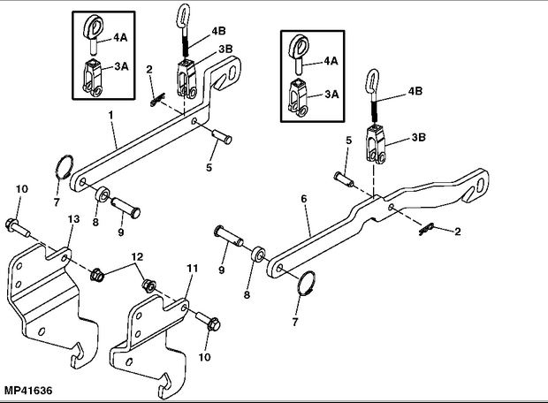

I was digging through jdparts and these parts and the deck seem to be all I would need, I think I have these parts already on the tractor but will have to wait until I get the tractor home to be sure.

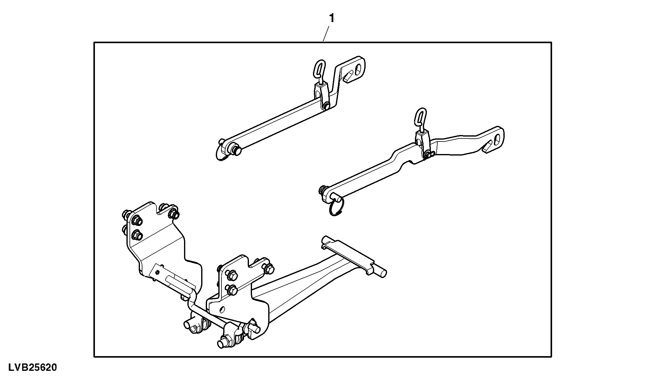

There's a member on GTT that has a LVB25620 2320 Mower attaching parts kit for sale. It's new and unused and you'll need it if you pick up a 62D1 for your new 2320. He also has the LVB25630 Independent Lift Kit which would nice a nice option as well.
/ Adding 62D mower to a 2320 advice needed please. #10
You'll also need this for attaching the front of the mower deck to the 2320. Front draft arms.
/ Adding 62D mower to a 2320 advice needed please. #11
I may be mistaken but I believe that the front draft link which is also listed separately is included with the LVB25620 kit. This photo shows the entire kit:
#12
This picture with the LVB25620 part number is very helpful, Thank You, I was wondering where that part number came into play.
