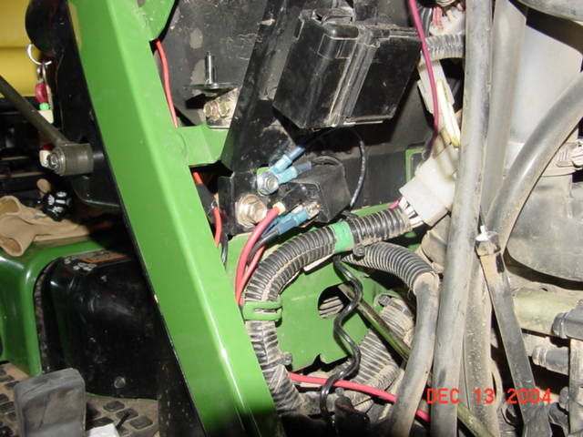

#25
Here is a view from behind the loader mast, there is still plenty of room to remove the loader
/ Added Remote to FEL...
#26
A front view...
#27
And finally a view from the seat...
Thanks to all again! /forums/images/graemlins/grin.gif
/ Added Remote to FEL... #28
If I didn't know any better, I'd say that was dealer installed. Excellent, excellent job. Good luck with it. G
/ Added Remote to FEL... #29
Kenny, I've looked at all your pictures and assembly. I think you've done a very nice job and it's easy to see you have a well thought-out project. The only thing I've seen that I'm not sure of is the electrical connection to your diverter valve. Is it just two bullet connectors? Do you expect those to hold up in the long run? I tend to think of that type of connector as semi-permanent, but no more often than you will disconnect/reconnect they may be sufficient. You have put a lot of value into this project far and above the $300 you spent on the parts. Nice job. /forums/images/graemlins/cool.gif
#30
Thanks JinMan,
The electrical connection is a High quality polarized plug from an old peice of test equipment that we had at work, it is factory made with the coiled cord and solid brass pins. There is really not a good picture of it. I also do not like bullet connectors.
The other crimp-on connectors are filled with dielectric grease before crimping(with a ratchet style crimper) and further sealed with heat shrink. I did the trailer wiring on my truck and it has lasyed 12 years so far!
