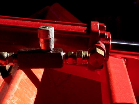

</font><font color="blue" class="small">( I too believe it moves too fast & needs a flow restrictor in the hydraulic line. )</font>
I would also like to slow down my Virnig grapple.
With a double acting hydraulic cylinder such as on this grapple, is it necessary to put a flow restrictor in each of the hydraulic hoses? Or, is restricting just one of the hoses sufficient?
Can a simple pinhole restrictor be used, or are the one way ball valve type needed?
Thanks,
Tom
   / add on bucket grapple #33
Tom you may indeed use only one orifice to slow the cylinder down for both directions of travel. Both our T&T cylinders only have one in each.
#36
TX, This works for me. It slows the grapple down both ways.
Flow Control Valve
Attachment is a picture of it on the tractor.
Just dial in the flow you want then lock down the set screw.
Gerald
